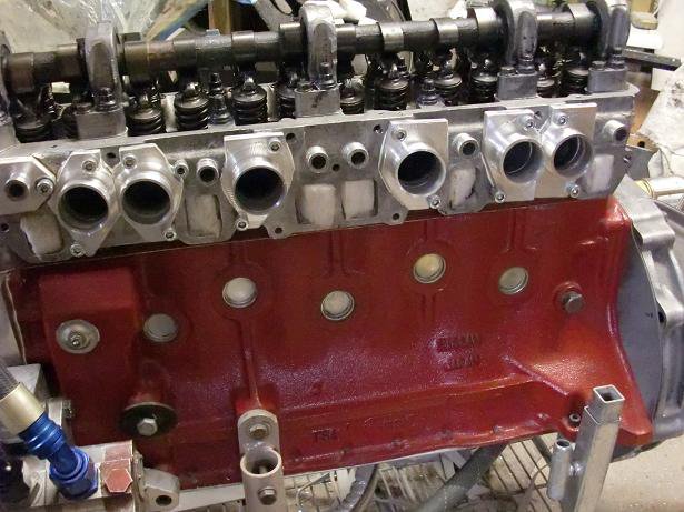

johnc Posted June 2, 2014 Share Posted June 2, 2014 An extreme simplification: the coolant has to flow from the right side of the head to the left and then forward to the thermostat housing. The coolant flow around the back three cylinders tends to stagnate because it has to flow past the front three cylinders to get out of the head. By drilling holes in left side of the head at the coolant galleries you can pull the coolant directly out of the back three cylinders and route it externally forward to the thermostat housing (or the radiator). This eliminates the stagnation in the back three cylinders and also increases the flow in the front three. Quote Link to comment Share on other sites More sharing options...
