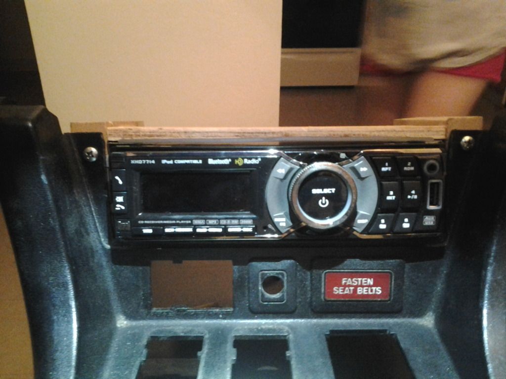

MazerRackham Posted June 25, 2012 Share Posted June 25, 2012 (edited) So I made the DIN enclosure out of 3/4" MDF and I would have used 1/4" too but the Home Depot ran out and they don't know when they are re-stocking so I bought some plywood. I tried to make it as thief proof as possible so I took several measures. You cannot see it in the picture but the DIN cage that the radio mates to is "permanently" affixed to the wooden mounting box. To do so I carefully cut some notches in the wood with my drill and bent some of the mounting tabs on the DIN cage outwards. Once I slid the DIN cage in the tabs snapped into the notches that I cut into the wood. There is no slop. The tabs on the side that bend outwards allowing the radio to slide in also have virtually no room. I was afraid the glue was going to snap when sliding in the radio but the radio eventually slid in with some violent persuasion and with no damage to the head unit. If the thief wants this radio they are going to have to rip out the center console and smash the wood box holding it in. Overall it is an extremely snug fit for both the radio and the DIN mounting cage. I drilled some holes in the center console so it wouldn't crack when putting in the two screws that hold it to the center console. I would have made a fancier mount but this is very sturdy and requires lots of destruction if a thief wants it. The sub box is entirely 3/4" MDF and its stupid heavy. Once the sub goes in it will easily be near 30-40 pounds. I'm going to cover it in 1/2" foam and faux leather black vynl to match the interior of the car. Edited June 25, 2012 by MazerRackham Quote Link to comment Share on other sites More sharing options...

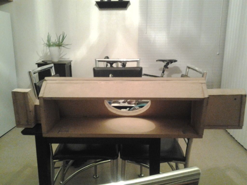

BluDestiny Posted June 25, 2012 Share Posted June 25, 2012 What's the reason for the uneven box design? I'm talking about the notch on the right side vs the "full" left side? Is it for your amp? or is that going somewhere else? Quote Link to comment Share on other sites More sharing options...
MazerRackham Posted June 25, 2012 Author Share Posted June 25, 2012 What's the reason for the uneven box design? I'm talking about the notch on the right side vs the "full" left side? Is it for your amp? or is that going somewhere else? Its for the catalytic converter temperature sensor. I'm going to add a small plate of wood to the backside of the notch so that once placed over the cat temp sensor it doesn't slide anywhere under heavy braking. Currently the right side is held in place by the plastic of the hatch panel. It is such a tight fit on the right side it isn't going anywhere. Quote Link to comment Share on other sites More sharing options...
