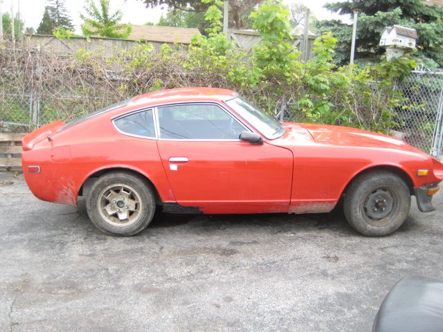

here is the story, a little while ago i picked up 1971 240z, she is a little rough on the cosmetic side but floors frame rails have been redone, there is already the toyota truck brake upgrade on the front and the 280zx rear disc conversion, she already has lowering springs on new shock inserts, also has a fuel cell. So my plans are to make it a race car and make it look nice inside out and install a 2jz ge (NA-T). i already have a bunch of parts left from my 1000whp 2jz sc300 lexus. I still need to get, tranny, rear end, drive shaft, wheels and tire anda lots of other things to build and put together the engine, but everything should come along durring the summer. Hoping on taking it out before the winter starts.

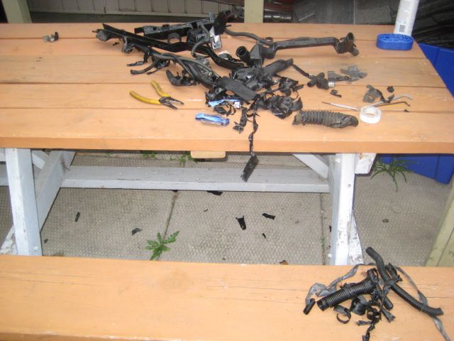

i started taking the dash apart to fix the spaghetti incident issue

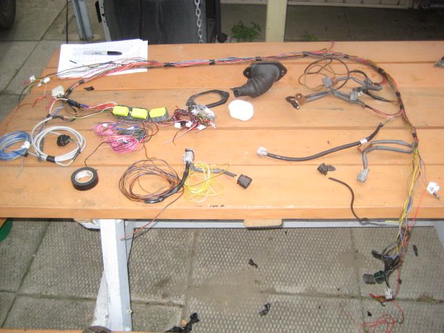

after taking out all the wires it was time to make the dash harness

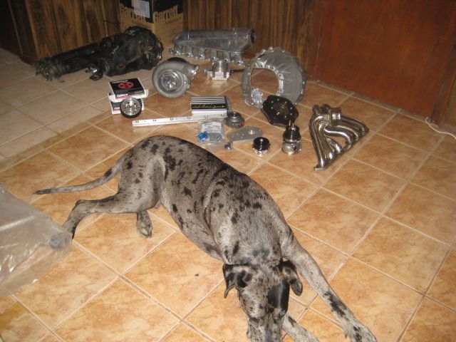

Turbo the dog keeping the turbo project
1200cc high impedance bosh injectors
50mm bov and 60mm wastegate
1jz bellhousing, tilton tripple plate (pressure plate and floaters) discs in it are still nascar discs

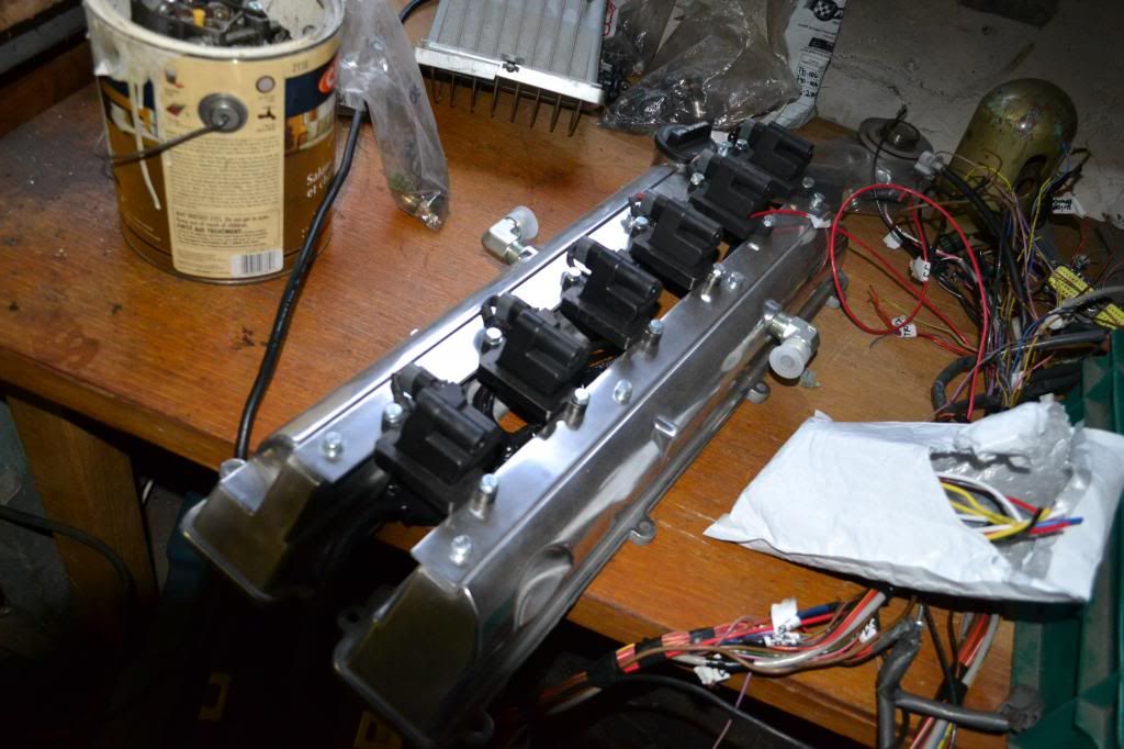

2jzge intake manifold and throttle i had on my lexus
300zx (z32) r230 lsd rear end and drive shaft

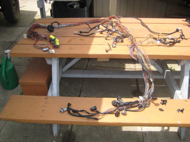

I started on engine harness

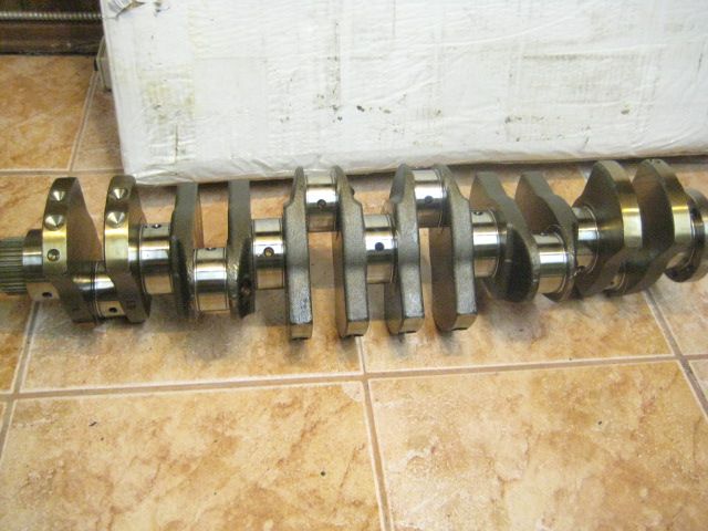

arp stuff, (flywheel, rods, crank main, already had head studs)
new rings, sandwich plate, inline turbo oil filter
Titan dampner pulley, titan race timing belt
Tilton flywheel, tilton tripple 7.25" discs to fit r154 input shaft, tilton aircraft bolts for pressure plate.
ACL race bearings (rod and main)

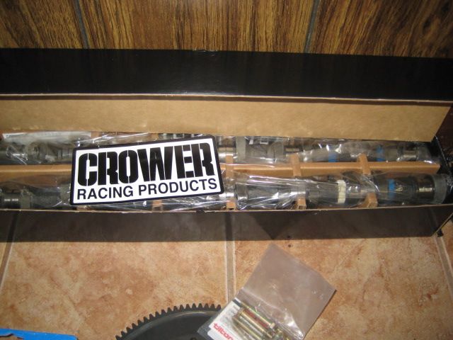

CROWER 280 cams

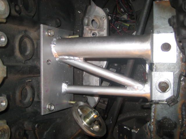

i made a mount to fit R230 differential. i did not pictures of it yet.

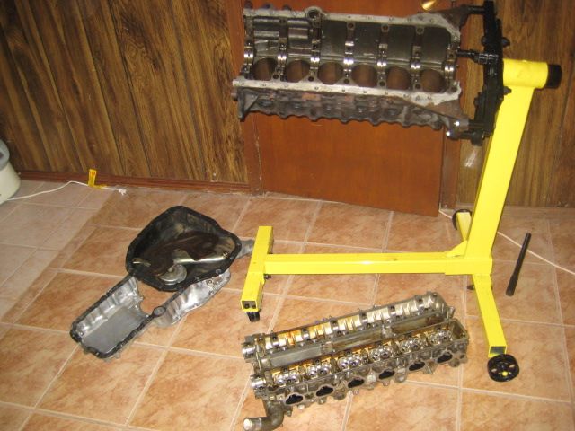

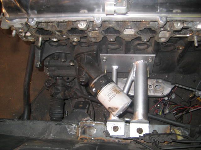

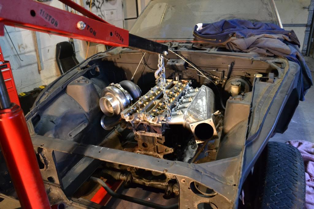

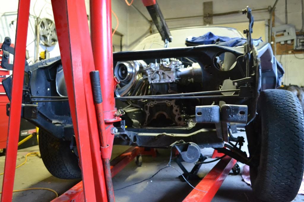

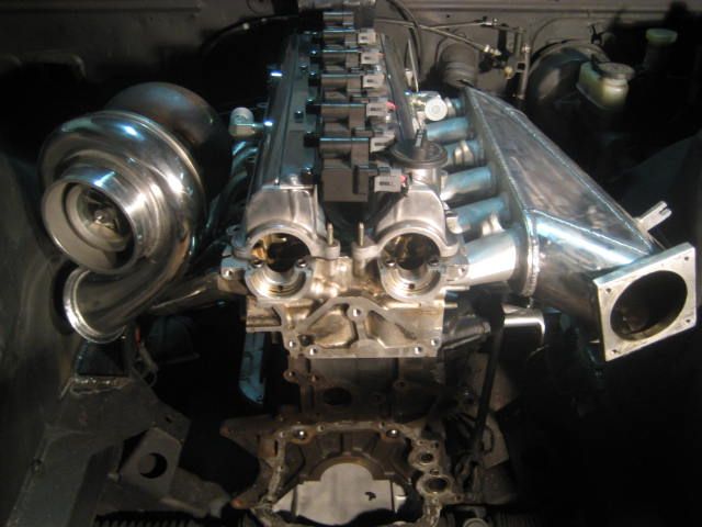

i test fitted bare engine to see clearance and everithing will work fine now i am at making the engine mounts but i am leaving for 3 weeks, so i wont have time to make the mounts until i am back. but here are some pictures.
