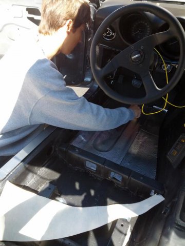

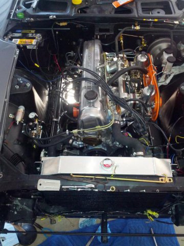

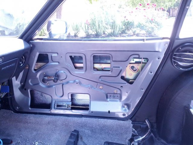

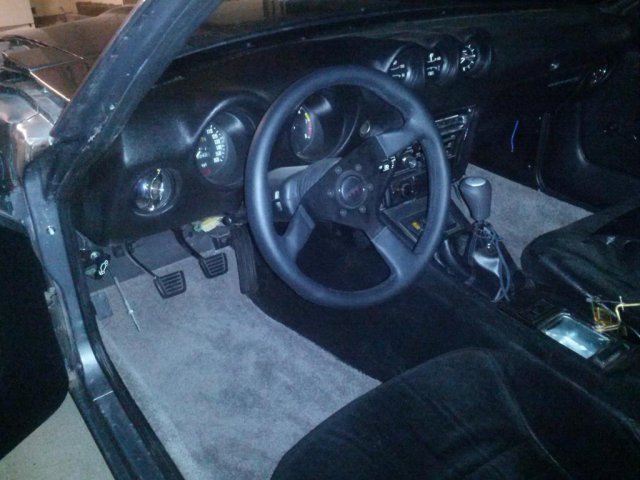

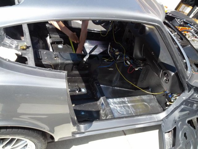

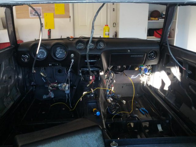

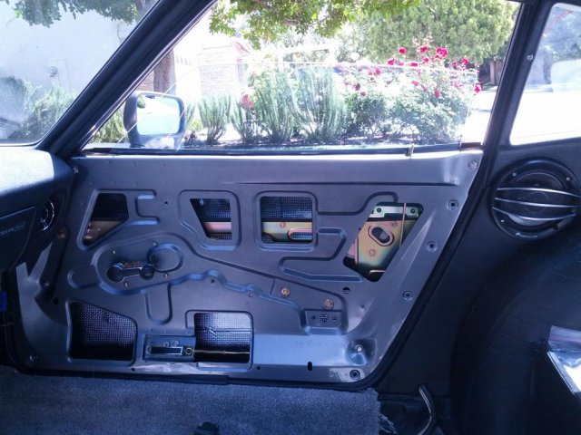

JCan Posted May 5, 2013 Author Share Posted May 5, 2013 Hello all... It is time for an update. Since my last post we connected the dash electrical and mechanical, and have installed the interior, cleaned up misc wiring in the engine compartment and connected up gas pump in rear of car. Interior: We used new plastic panels and vinyl from motorsport. The Vinyl went in okay however the plastic panels needed to be trimmed prior to installation. We purchased 50sq feet of be quiet sound deadening and used it on the outer door panels, roof, floor, interior hatch, and as many places we could find where thin metal could vibrate. next we went to home depot and purchased 4 linear feet of carpet and glued it into the front of the car and laid it on the rear deck with no fasteners. Weatherstripping. We purchased weather stripping kit from Motorsport. Everything worked out great except for the hatch and door openings. The wetherstriping at the door openings seems too hard! Wehave to slam the hatch and the doors to get them to close. i hear this is a common problem and may revisit this issue. Doors. I made a mistake and cleaned two drivers side door mechanisms so I had to go back to the plater. I took advanntage of this by removing all metal inside the door and having it all replated! Additionally I took the old stainless steel and polished it around the windows. Metal is great cause you can sand away years of neglect and it comes back looking great! Spare tire trim. I used a CNC machine (I had a membership at Maker Place in San diego) so I went a bit overboard... _____________________________________ All in all, the car has taken shape and we displayed it at the Motorsport show two weeks ago. Today we have 200 miles on the engine, and as expected first gear goes from 0 to 40MPH, and the car is not tremendously (due to gearing) fast off the line as designed. However after about 30mph, the car pulls pretty good.! Last picture is the car at the Motorsport show. We had a great time! Quote Link to comment Share on other sites More sharing options...
