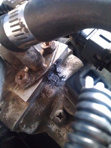

Samson Posted October 16, 2012 Author Share Posted October 16, 2012 (edited) Okay, i wasn't able to get a fuel gauge but i did measure the resistance at the ECU plug for the water temp sensor it's reading was 1193 ohms and at the sensor itself it was about 1200 ish ambient temp was around 80 Degrees F. I also measured the AFM resistance went by the EFI bible page i'm referring to are (49-51) the #1 measurement was 321 Ohms, #2 was 257 Ohms #3 was 145 Ohms. Also went ahead and measured Air Regulator & Fuel pump circuit, reading was 82 Ohms, did the Fuel pump relay circuit and it was also 82 Ohms, I measured all the control unit's ground and all Four pins showed 0 ohms, i guess i know my grounds are good on that part. All fuel injectors are getting voltage aswell from the plug, thought i'd put that in too. Looked around the engine bay a little closer and noticed the hose for the PCV valve is some half ass rigged line picture is attached Could this be one of the probable causes why the car runs so crappy when the temp sensor is plugged in? NOTE: The spark plugs are also fouled from having the rich mixture condition it has, plugs only have about less then 10 miles put on them too.. could this be a probable cause aswell? I don't want to go through another set of plugs given that these are fairly new.. Edited October 16, 2012 by Samson Quote Link to comment Share on other sites More sharing options...

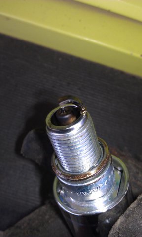

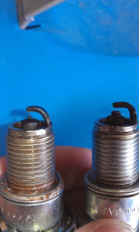

Samson Posted February 1, 2013 Author Share Posted February 1, 2013 Another Update: Installed the new EFI harness, ECU and dropping resistors all from a 76 280z. Replaced the injector connectors that were on the new harness since they were all old and dying. I'm not sure if i fixed the Rich mixture part yet given i don't have no Gas Analyzer to look at the numbers but i do have pictures of the plugs, anybody here pretty good with examining them? Much Appreciated.Here are 2 plugs side by side. Left one is the new plug how it looks right now. Also one point these plugs were installed on the car before the whole EFI electrical part was replaced, i'm not sure if that has an affect of the left over carbon fouled burn the car used to produce? Just a better picture of the new plug's burn. Quote Link to comment Share on other sites More sharing options...
