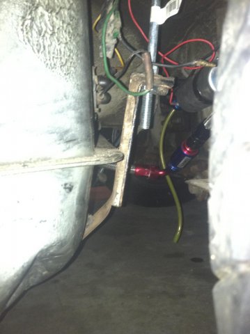

motomanmike Posted November 18, 2012 Share Posted November 18, 2012 (edited) Well, I finally got my car started on MSII E however I'm getting back to some basics I guess. My fuel pump is either toast or its not priming right. I have a 240z with a 76 280 tank, walbro pump. Here is how it is plumbed for the feed. At first I didn't have an issue, well I don't think I did. I'm not sure and have not played with lowering it down below the feed line but i'd like to keep it shielded which is why I mounted it where it is. The pump currently whines really bad and its not a constant whine, its up and down almost like a siren and will not pull fuel. I even dumped another 5 gallons from a dump can in the fuel tank thinking it was just out of gas with no change in the way it sounds. Here is what I have, 1/2 AN line feeding, 100 micron filter, to the pump, then 1/2 AN line up to the rail. Should I eliminate the 90's? The pump came with two small barbs I can't really see why the 90's would starve it? Are any of you running a similar set up that might have some insight? I can't tune this thing right until I figure out whats up with the fuel feed at the moment. The old yellow tube is on the old return line so it didn't get plugged with gunk. Edited November 19, 2012 by motomanmike 1 Quote Link to comment Share on other sites More sharing options...
Nigel Posted November 18, 2012 Share Posted November 18, 2012 That looks pretty high up. Those pumps don't like to pull fuel, and you may have an air pocket trapped there. You can see how low I have my mounted in the picture below. Never had any issues... Nigel Quote Link to comment Share on other sites More sharing options...
motomanmike Posted November 19, 2012 Author Share Posted November 19, 2012 (edited) It does seem very much like it is an air pocket stuck in there. I wouldn't think having to pull fuel 1-2" in height would be that hard for it but I'm guessing it can be an issue, i'll unbolt it from its mount and lower it down unmounted just to see what happens and go from there. Nice set up Nigel that car is spotless underneath. Man it would be nice if its that easy. Edited November 19, 2012 by motomanmike Quote Link to comment Share on other sites More sharing options...
