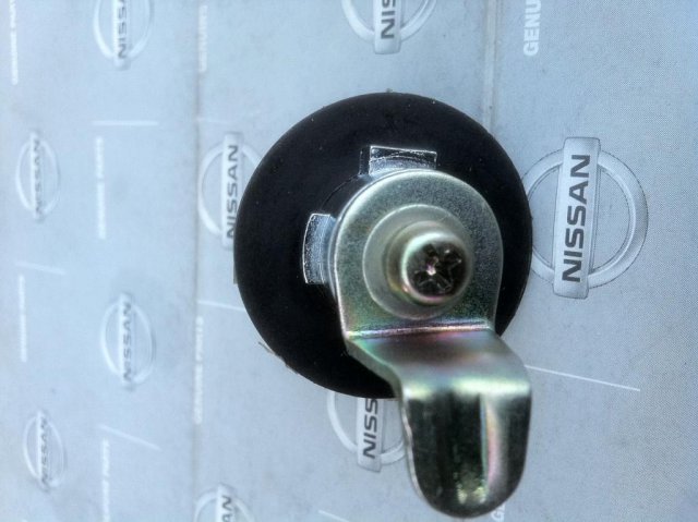

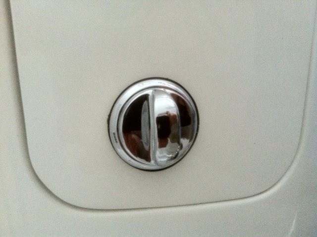

nix240z Posted October 20, 2013 Author Share Posted October 20, 2013 reproduced the 70'-71' gas door latch seal. Quote Link to comment Share on other sites More sharing options...

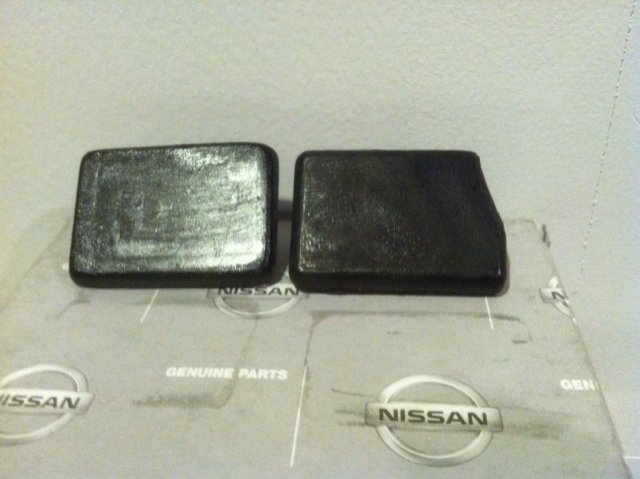

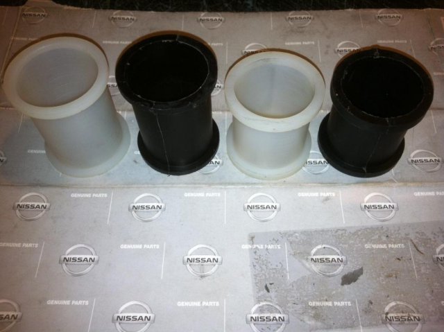

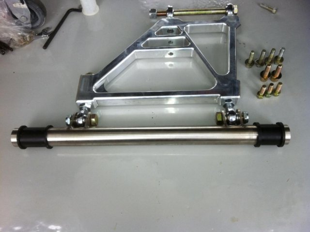

nix240z Posted October 28, 2013 Author Share Posted October 28, 2013 reproduced the Arizona Z Car rear control arm bushing, which are a hard rigid plastic type, with a shore hardness 90A urethane. Quote Link to comment Share on other sites More sharing options...

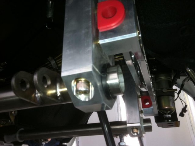

zack_280 Posted October 28, 2013 Share Posted October 28, 2013 I would highly advise drilling a hole in through the LCA support and LCA tube and then putting a bolt in said hole. You'll probably want to get pretty close on the rear wheel location under the fender first. If you do not do this, it will move on it's own and push your rear wheel out under acceleration. I say this from personal experience. Quote Link to comment Share on other sites More sharing options...
zack_280 Posted October 28, 2013 Share Posted October 28, 2013 Technically it's not the rear LCA, but I think you get what I'm saying. Quote Link to comment Share on other sites More sharing options...
zack_280 Posted October 28, 2013 Share Posted October 28, 2013 http://forums.hybridz.org/topic/99357-my-dream-ls7gtzproject-underway/page-9 Here's a pic of what Matt Isbell did to his before bending the bar and fabbing a new and improved one out of chromoly. I'm not making as much power as Matt, so I'm hoping this works for me. Quote Link to comment Share on other sites More sharing options...

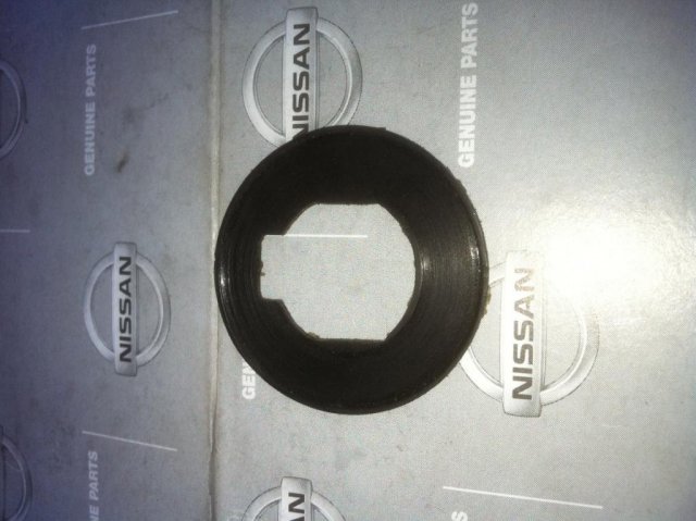

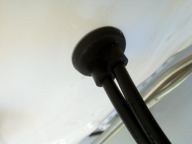

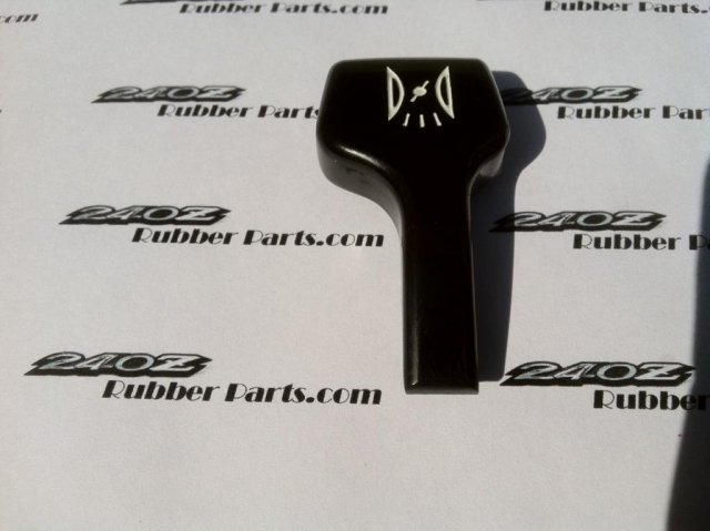

nix240z Posted November 2, 2013 Author Share Posted November 2, 2013 reproduced the early style 70-71 choke cable grommet. Quote Link to comment Share on other sites More sharing options...
1 tuff z Posted November 2, 2013 Share Posted November 2, 2013 Another to add to my 'buy' list... On 11/2/2013 at 8:07 PM, nix240z said: reproduced the early style 70-71 choke cable grommet. z202.jpg Quote Link to comment Share on other sites More sharing options...

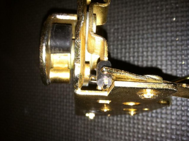

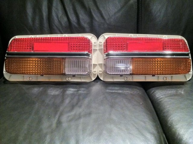

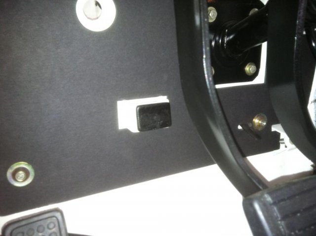

nix240z Posted February 8, 2014 Author Share Posted February 8, 2014 Making rubber parts has slowed down the work on the car but I do have more rubber parts made and installed on the car. I am also offering custom 240z brake and fuel lines with custom insulators for a 5/16" return fuel line, same size as main fuel line. check site of other new items. www.240zrubberparts.com New Clutch pedal stopper on firewall. Wiper motor bracket rubber bushings. Radiator support wire pass through insulators. Door lock mechanism rubber pieces. Euro Tail lights Reproduction slot blank tape and correct 71 choke handle. refurbished the fuel sending/pump harness with new grommet. Quote Link to comment Share on other sites More sharing options...

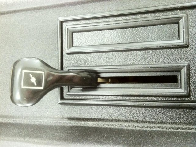

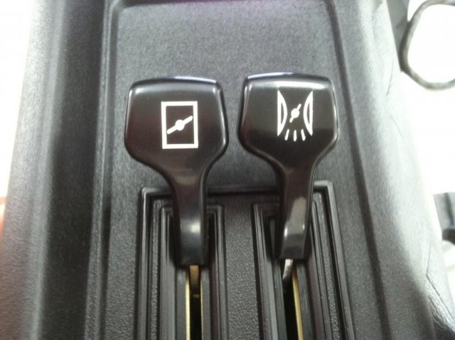

nix240z Posted March 1, 2014 Author Share Posted March 1, 2014 Choke and hand throttle assembly finished. Quote Link to comment Share on other sites More sharing options...

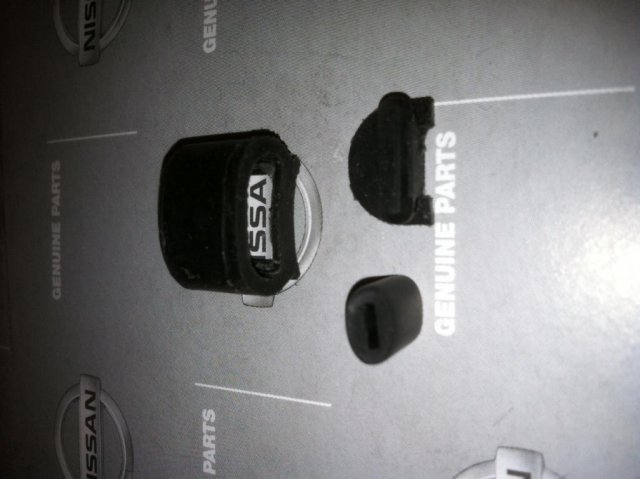

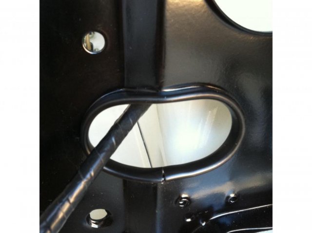

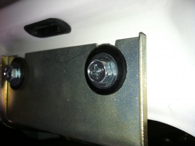

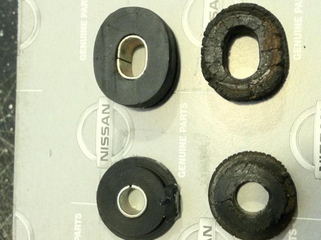

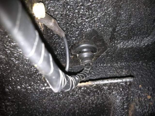

nix240z Posted February 14, 2015 Author Share Posted February 14, 2015 Projects within a project is how I roll, so a few pictures of the items I reproduce for my build. Door Escutcheon rubber, look at yours and you will see a hole. This is for this little rubber bumper. Antenna Drain Tube Strut cap Radiator wire pass through Turn signal wire rebuild kit Headlight wire rebuild kit Turn signal hardware Vent hose boots Hatch hinge boots kick panel clips Quote Link to comment Share on other sites More sharing options...
