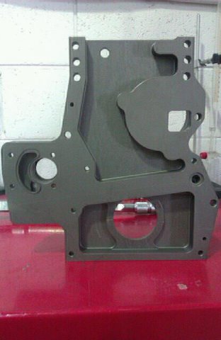

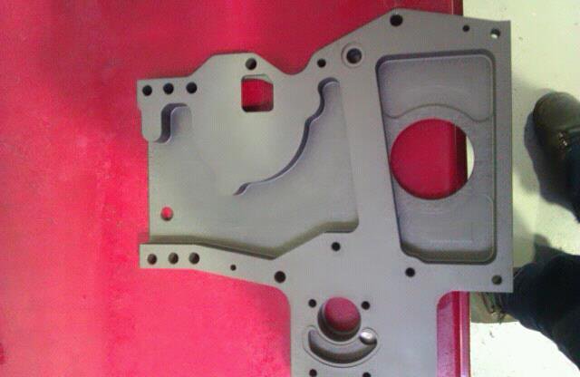

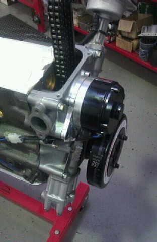

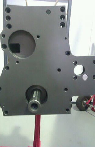

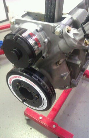

attachicon.gif73491_479450065436699_1195855069_n1.jpgattachicon.gif537902_479450155436690_593148167_n1.jpgBack on topic hears the front of the 3.4 with EWP not my thing but he wanted one,  also he wanted gears not guides  , so some changes to my norm  but we will see how they work on the dyno .
