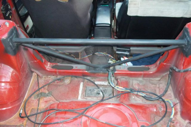

redzedturbo Posted January 26, 2013 Share Posted January 26, 2013 My 83 280zx turbo 5-speed weighed 2900lbs even on a cat certified scale yesterday. I was shocked till i got to thinking about what the thing weighed from the factory (2960) with all power options. please correct me if im wrong about this. I weighed in with a half tank of fuel and me (200lbs) in the car and my tool box at 78lbs because i weighed it and me when i got home. so my car with a half tank weighs 2622. My new goal in life is to get under 2500 lbs with a half tank. From the seats back my car is stripped and i have a heavy super strut tower bar. All sound deadening/carpet/speakers and radio are removed. I have a/c removed and run 2.5'' mild steel exhaust with no cat of muffler (BECAUSE RACE CAR) Also a 3.5 in thick intercooler up front with 2.1/4'' piping stock air box is long gone and all engine wiring gone because i run megasquirt. any ideas how i can shed some more pounds OTHER THAN BUMPERS because im thinking of making aluminum ones to replace the steel. Quote Link to comment Share on other sites More sharing options...
