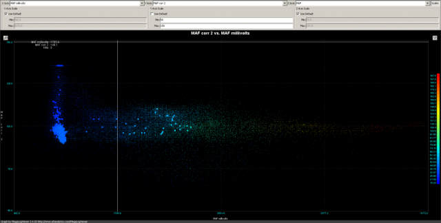

winstonusmc Posted January 4, 2014 Author Share Posted January 4, 2014 (edited) went through a good deal of MAF tuning with a registered version of Mega Log View to give me pretty spiffy scatter plots to help in tuning. I created an excel spreadsheet to help in changes in the MAF curve. I used this thread on the MSExtra forum to help me out: http://msextra.com/forums/viewtopic.php?f=134&t=49504 I drove around today for about 45 minutes today to make a pretty good scatter plot. I am within 3% of AFR on the lower RPM and 2% up top. The car drives way better than it did with MAP and the part throttle cruising is like a factory car. Here is my MAF MSQ and the spiffy scatter plot from today showing my error %. Maf n62 f.zip Oh, for those that used my map for their base map, my timing was way too agressive, i took almost 6 degrees out in the upper portion due to some pinging. Edited January 4, 2014 by winstonusmc Quote Link to comment Share on other sites More sharing options...
