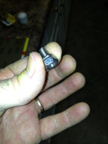

RebekahsZ Posted March 4, 2013 Author Share Posted March 4, 2013 (edited) Broke the v-band bolt on the 3" clamp for the muffler. I didn't torque it hard at all. I think the nut just galled (gauled?) onto the bolt then it took just a little elbow grease to brake the bolt off. I'm anti-seizing them all now. And why the heck are these bolts just a little too short to let me keep the nut on? I have to remove (and drop) the nut everytime I remove the v-band! A 1/4" longer and I'd just have to loosen it. Edited March 4, 2013 by RebekahsZ Quote Link to comment Share on other sites More sharing options...
Tony D Posted March 6, 2013 Share Posted March 6, 2013 My wisdom is vindicated! I wanted to say 76 inch-pounds for a 1/4-28 thread as that spec stuck in my head from MC1-A GTC's, A/N PSM-60A GTC/Gensets, etc.... But all those years of having "go by the work cards" had me not consciously remember that specific number. But it was there... Lurking... Those were the problems on the GTC and most Combustor-Cap V-Bands: 1) Threads Strip in nut from over torque 2) Clamp bends from over torque due to someone thinking adding anti seize on the threads and not adequately compensating for "dry vs lubed" friction coefficients and still using un-lubed numbers while lubricating the threads. Example: Hardened Coupling Bolts torque spec DRY: 68 ft-lbs Same Hardened Coupling Bolts torque lubed with Coupling Grease: 22ft-lbs Result of trying to get 68 ft-lbs on threads lubed with coupling grease: thread failure inside nut at between approximately 35-42 ft-lbs observed on beam-indicating torque wrench. Use a good beam-indicating wrench pulling these up, you will see the band seat, clamp take-up, and threads yield... I'm always full of good news, ain't I? Quote Link to comment Share on other sites More sharing options...
