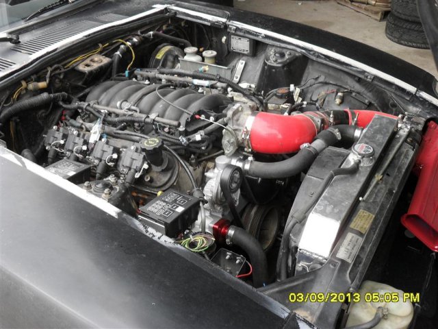

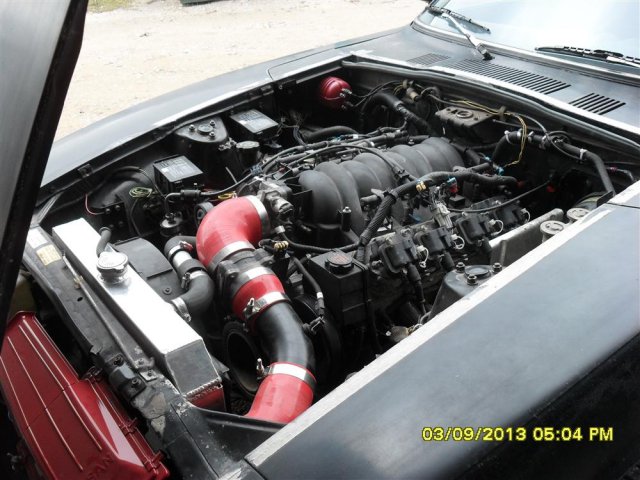

Domzs Posted March 14, 2013 Share Posted March 14, 2013 Got mine from Jeg . Comes straight out and uses old school t-stat . Quote Link to comment Share on other sites More sharing options...
Wheeler Posted March 14, 2013 Author Share Posted March 14, 2013 Thanks Domzs, by the way what is your intake system / where did you get that, looks very nice. Quote Link to comment Share on other sites More sharing options...
Domzs Posted March 14, 2013 Share Posted March 14, 2013 (edited) Thanks . Bought all silicone hoses and clamps off ebay , cheap . 3" pipe from leftover , my exh. sys. Edited March 14, 2013 by Domzs Quote Link to comment Share on other sites More sharing options...
