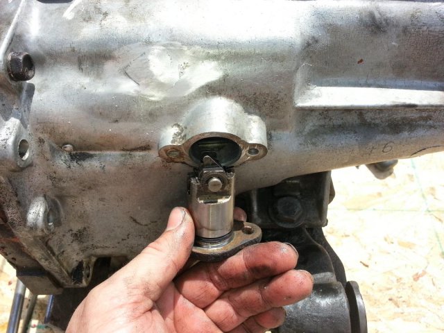

col10see Posted April 16, 2013 Author Share Posted April 16, 2013 ok i pulled the tranny after i got off. im stuck pulling it apart the gears and syncros look good up front but i cant get the second half off! Quote Link to comment Share on other sites More sharing options...

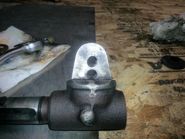

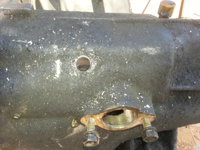

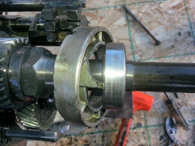

col10see Posted April 18, 2013 Author Share Posted April 18, 2013 got the tail section off finally. thanks guys. turns out the tailshaft bearing race came out and went in front of the bearing blocking the striker rod from slipping past so i ended up nocking the lockink pin out of the rod wile it was inside by drilling a hole in the side giving me access wile it was turned enough to remove all the way. Quote Link to comment Share on other sites More sharing options...

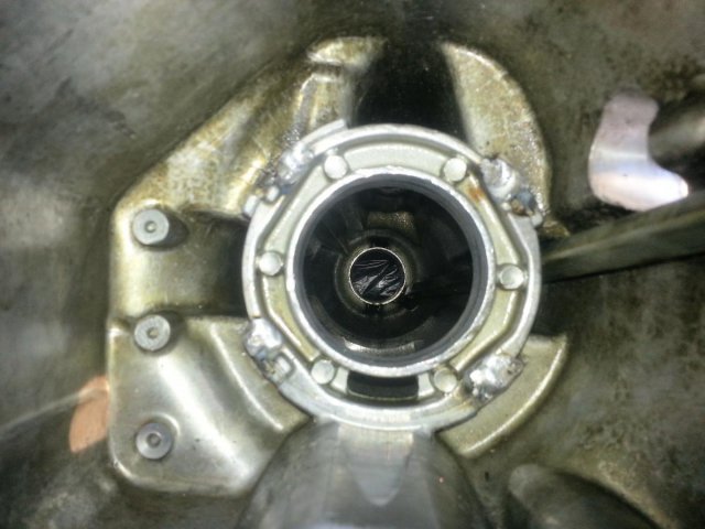

col10see Posted April 18, 2013 Author Share Posted April 18, 2013 (edited) Does anyone know how tight of a fit the bearing support is supposed to be? any reason not to weld it in there? Also were can I find a new brass bearing??? For the drive shaft at the very end of the transmission with the grooves in it. Edited April 18, 2013 by col10see Quote Link to comment Share on other sites More sharing options...

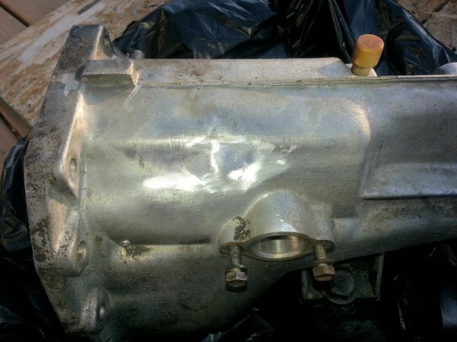

Xnke Posted April 18, 2013 Share Posted April 18, 2013 You need a new tailshaft housing. The one you show above is completely uneconomical to repair. Quote Link to comment Share on other sites More sharing options...
col10see Posted April 19, 2013 Author Share Posted April 19, 2013 (edited) Thanks newzed for the links... I couldnt find that bushing/oil bearing:( Sadley I think you are right Xnke.. but in the mean time I need a car wile I search for a tranny. So... since tiging aluminum is one of my skills I am gonna attempt to patch it for now. I had time during my lunch at work to use the welder so I patched the hole I drilled rebuilt the oil splash guard for the vent on the back and built a clamp to pull the tailshaft bearing support back tight wile I tacked it into place in four places trying not to overheat the area. . Hopefully this will buy me some time to save some money up.... Also, I know the driveshafts u-joints are " non replaceable " but I have heard of people doing it. Any knowledge of the size or part numbers to replace them with. Edited April 19, 2013 by col10see Quote Link to comment Share on other sites More sharing options...

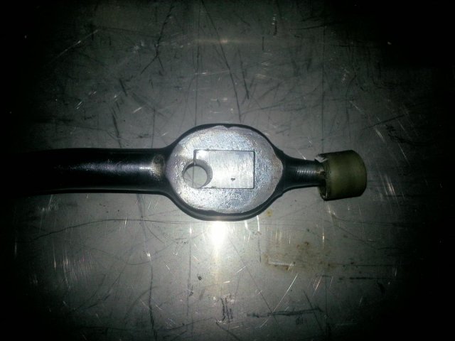

col10see Posted April 19, 2013 Author Share Posted April 19, 2013 (edited) wile im in there i figured i would give a go at a short shift mod. . i got rid of the plastic bushing and pressed in a peice of aluminum also i drilled the hole in the shifter a little off center to make the forward throw a little less... i will be either using teflon washers nylon or brass to make up the space on the sides. Edited April 19, 2013 by col10see Quote Link to comment Share on other sites More sharing options...

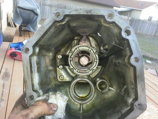

NewZed Posted April 19, 2013 Share Posted April 19, 2013 Did you find out what was makng the "bouncing marble" noise? The original problem? The fabrication and welding work looks good. Hope it all works. Have you tried to fit the bearing back in to the bearing mount you welded in? Quote Link to comment Share on other sites More sharing options...
col10see Posted April 19, 2013 Author Share Posted April 19, 2013 the marble noise was the splash guard on the bearing support. part of it broke off and was making the noise as it was being refined into little shiny bits in the tranny oil. havent tried fitting it yet since it has been welded but it fit snugly before...i am going to flush out the gears and syncros and bearings tonight as they still look brand new, comparing them to the kit i just bought. but i will follow up on that. Quote Link to comment Share on other sites More sharing options...
Xnke Posted April 19, 2013 Share Posted April 19, 2013 That's not a splash guard, that's the actual bearing support. I would suspect that bearing of being bad unless you broke that during the tailshaft removal. Hope the welding works out for you, but I have my doubts that it will. Bearings don't "look new", they either are new, or they have XXX,XXX miles on them. If you wash them out with brake cleaner and spin them, they should spin smoothly with very little or no noise at all. Quote Link to comment Share on other sites More sharing options...
col10see Posted April 21, 2013 Author Share Posted April 21, 2013 (edited) Cleaned it all up, bearings may not be brand new but they felt good so i guess i miss spoke, obviously ive been driving it for 6 mo plus how ever Many miles on it wile it was in the prev owner put on it. but they are clean quiet not binding and feel tight within the races.all acting very close to the new bearings in the kit I have. Cleaned all the gears And slipped it together tighend the rear section on to the center section and put it back on the vise and spun it, it was quiet. The shifter shifts smooth and there it no play in the output. I thought it was a splash gaurd on the back of the bearing support to keep oil from coming out of the vent broke off, thats what I was meaning to say maybe I missed it. I belive it was from driveshaf vibration that the support worked loose and forward of the bearing. Im a dummy however and forgot to note what direction the rev check goes. Like this? Edited April 21, 2013 by col10see Quote Link to comment Share on other sites More sharing options...
