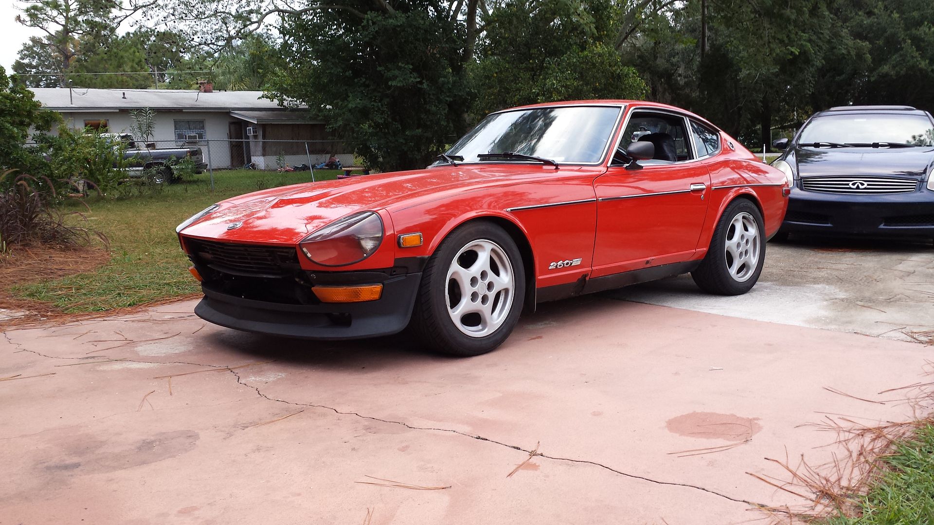

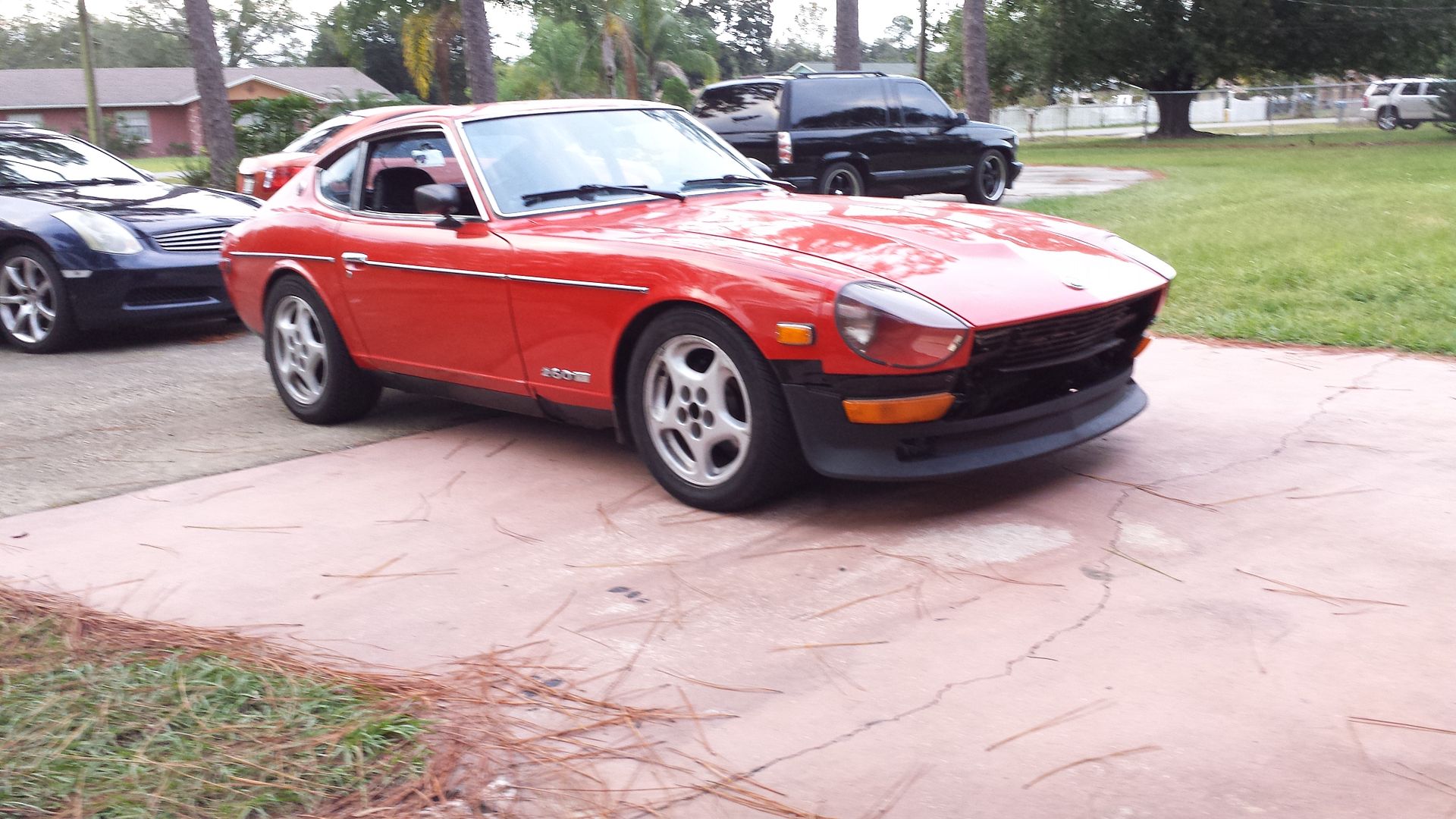

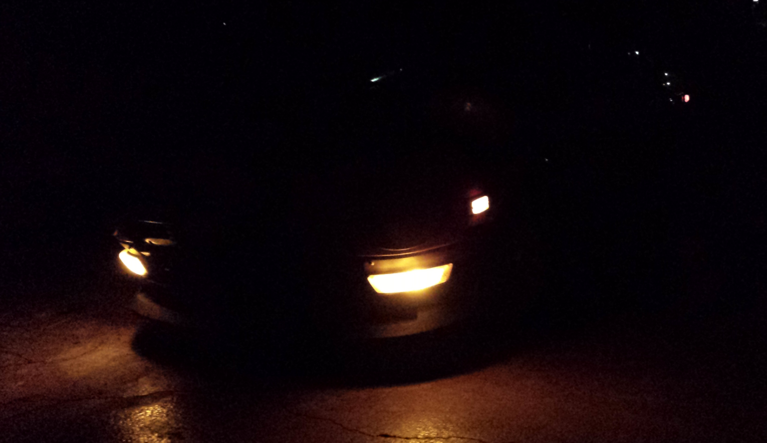

tooquick260 Posted November 2, 2013 Author Share Posted November 2, 2013 (edited) Car is to much fun, front spoiler bolted up with the 240z turn signals. I like it............ Edited May 4, 2015 by tooquick260 Quote Link to comment Share on other sites More sharing options...

nullbound Posted November 3, 2013 Share Posted November 3, 2013 Looks good, but the spoiler area above the turn signals goes on the back side of the headlight buckets. Quote Link to comment Share on other sites More sharing options...
tooquick260 Posted November 3, 2013 Author Share Posted November 3, 2013 Thanks for the correction. I tried that way first. I figured someone would notice. The holes for the fenders would not line up with the lower spoiler. Lined up this way. Getting bumpers soon and will correct it at that time. Quote Link to comment Share on other sites More sharing options...

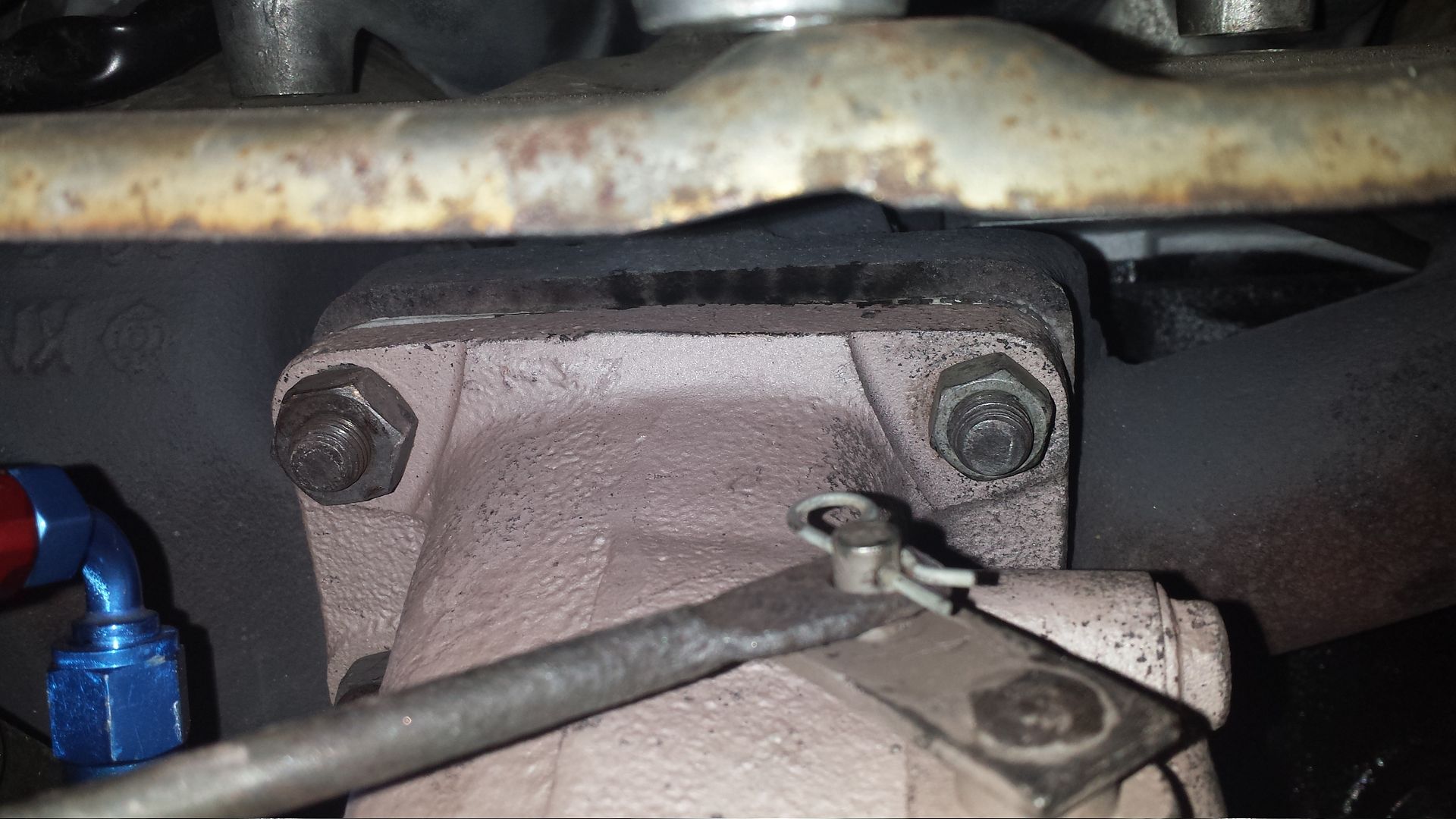

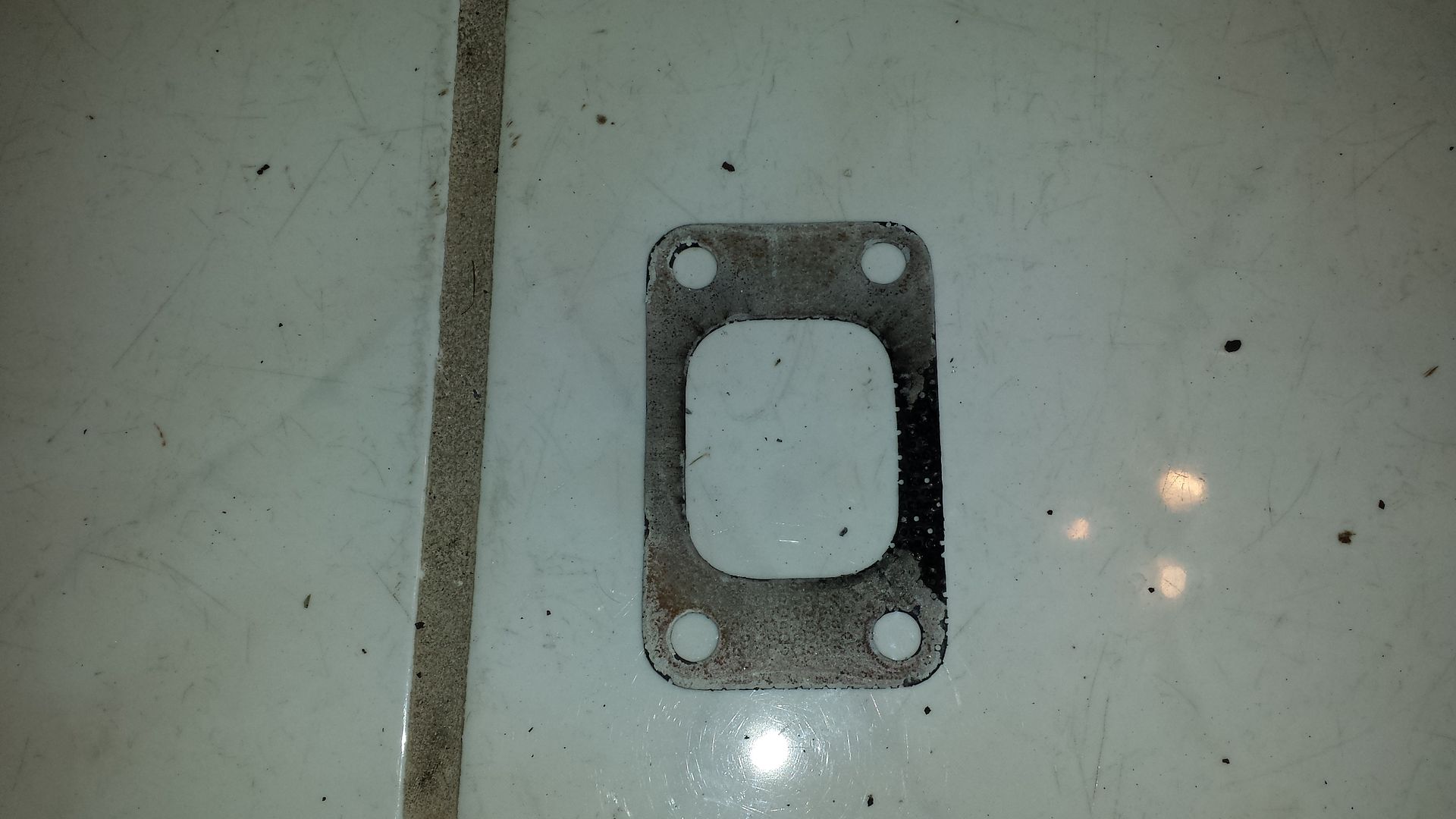

tooquick260 Posted November 5, 2013 Author Share Posted November 5, 2013 (edited) Here is the exhaust leak. Lost one nut on the turbo to exhaust manifold flange. Blew out the gasket. I tried re-installing the nut and tightening the other nuts, but did not work still leaked. Edited May 4, 2015 by tooquick260 Quote Link to comment Share on other sites More sharing options...
tooquick260 Posted November 6, 2013 Author Share Posted November 6, 2013 (edited) Fixed the exhaust leak. Pretty quick took me an hour. I think I could do it in 30 min now. Edited May 4, 2015 by tooquick260 Quote Link to comment Share on other sites More sharing options...

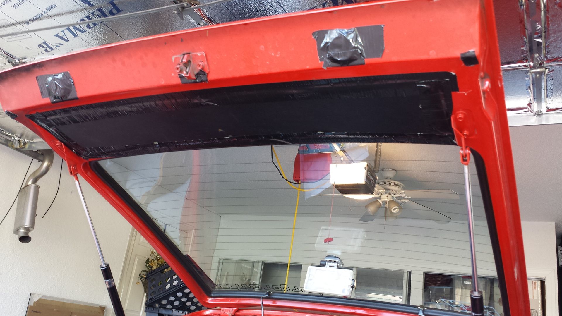

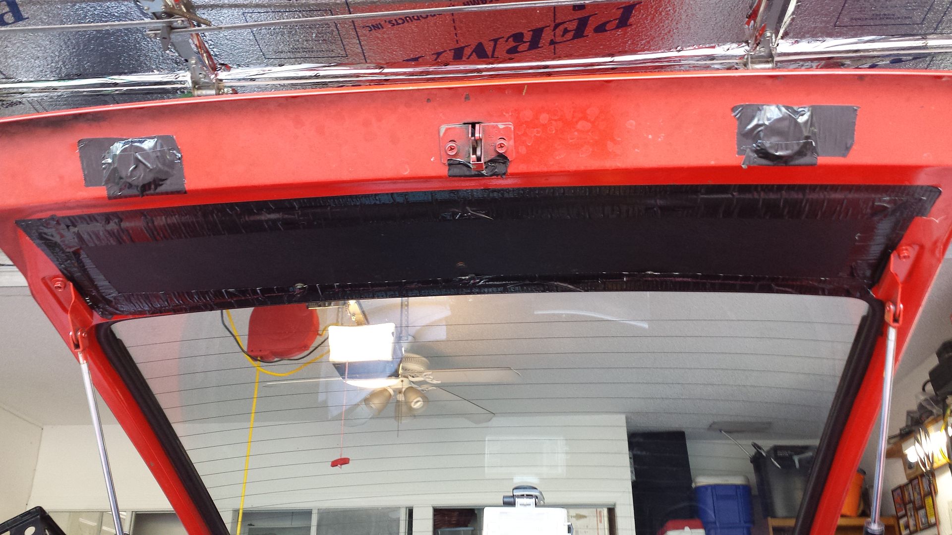

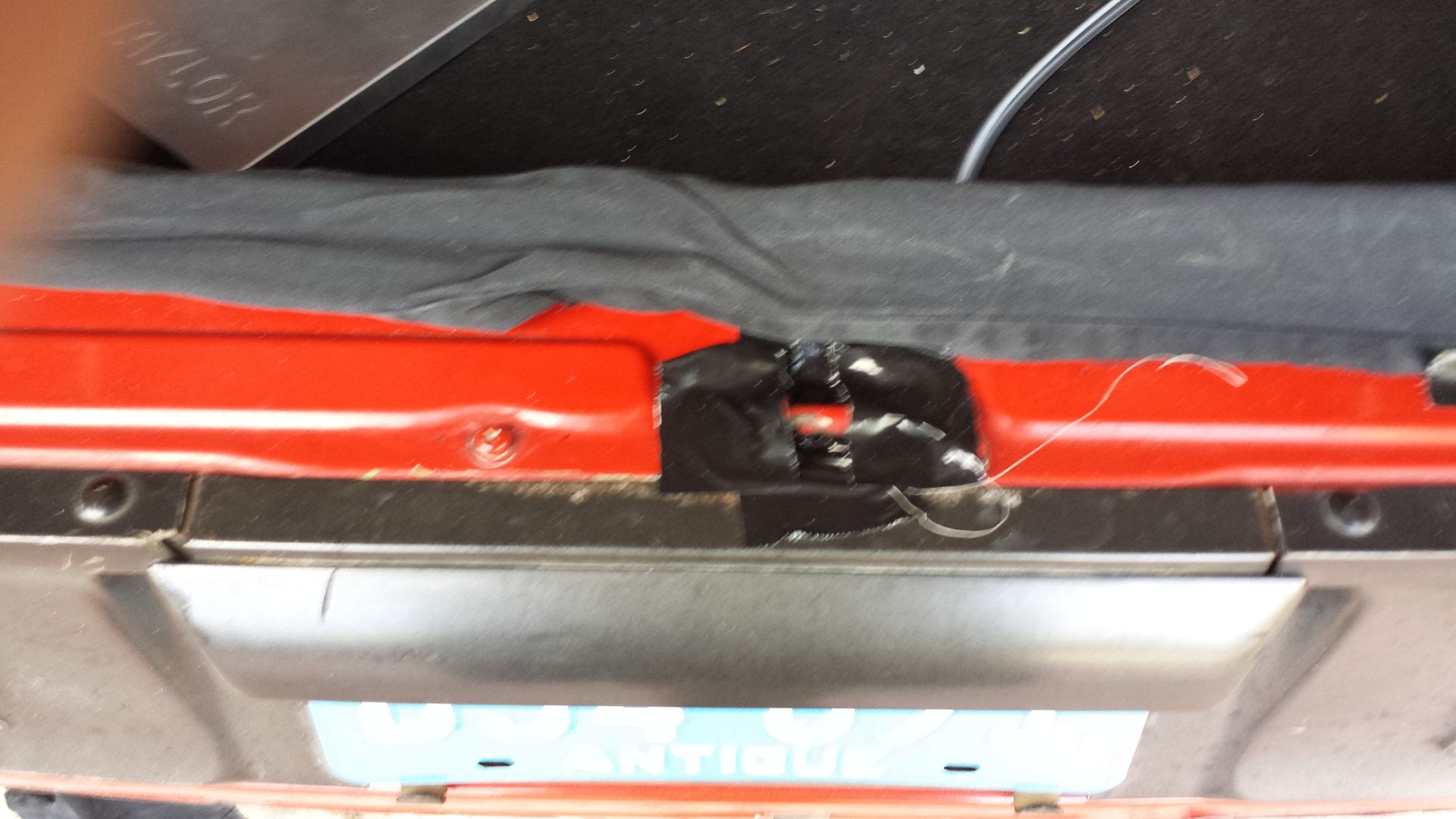

tooquick260 Posted November 15, 2013 Author Share Posted November 15, 2013 (edited) Today while I am in Wi, Dad and brother pulled the center console and installed a rubber mat around the hole for the shifter. Trying to cover up any holes that may leak exhaust fumes. I also sealed all the tail light housings. Covered up the hole for the antennae drain. Covered the mysterious holes in the sub frame. Still have exhaust fumes coming in. What gives. Also brother says that the diff bolts are loose again. He retightened them will see. He says that the car has created a stumble on light throttle. Fixed exhaust leak, it was the bolt holes left open in the rear hatch compartment that held the 260 z bumper shocks in place. They were removed when i took the bumpers off. Never filled the holes! Edited May 4, 2015 by tooquick260 Quote Link to comment Share on other sites More sharing options...
