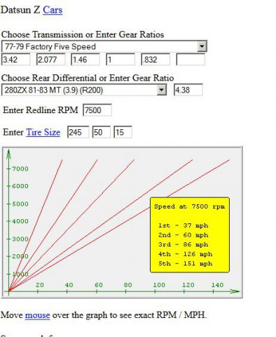

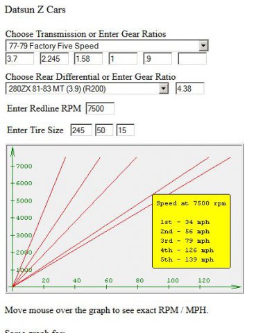

duragg Posted May 10, 2013 Author Share Posted May 10, 2013 (edited) From Norm (the legendary 12 second SU dude): Subject: SECRET TRANNY RATIOS REVEALEDAuthor: norm ()Date: 12-10-1998 14:06Okay, I'm sure that this isn't a total secret, but I'm willing to bet 95% have never heard this one.Here's the deal, you can put a 74 260 4 speed trans. input shaft and front countershaft gear on an 81-83 5 speed and get some killer low end acceleration .The stock ratios are as follows. 3.06 1.858 1.308 1.00 .745 MODIFIED Ratios 3.70 2.245 1.58 1.00 .90 You run hard out of the hole with this setup but you do have a less than perfect gap on the 3rd to 4th shift.However I think this is a killer setup for autocrossers where speed doesn't go over 75, that is when you have to shift if you are running a 3.9 and 195/60 14 tires(If you shift at 7100 rpm).I liked this for 1/8 mi. drags, but unfortunately I had to shift to 4th gear about 90 ft from finish line and I didn't like the possibility of a missed shift costing me a race.However this would be great combo for someone with less hp because they would cross finish line in 3rd gear.Okay, the next setup is what I am currently running in my 240 .This setup works better for 1/4 mile drags because the 3rd to 4th gear gap is better.Take an input shaft and front countershaft gear from a 75-79 5 speed and put it on the 81-83 5 speed and you get this setup. 3.42 2.07 1.46 1.00 .8326Either of these setups really improves the drivability of any Z car and would really help accelerate a heavy 280 zx off the line without having to resort to a high rpm clutch drop to spin the tires up to the engines powerband. The last combo is this one. .Take the 81-83 input shaft and cs gear and put them on a 79 5 speed and you get this setup 2.98 1.85 1.17 1.00 .77 I guess this would work well with a4.11 to 4.44 rear diff and would give an ultra close shift from 3rd to 4th.I have not tried this combo yet. If you drag race and don't run slicks or street legal drag tires you will not reap the full benefits with the first two optional tranny combos.Good 60 ft times are essential to quick e.t.s and the first setup works terrific with sticky tires.I managed a 1.84 sec 60 ft with Nitto street drag slicks.This was done with an open 3.9 diff and the nittos spun hard off the line.With real good slicks and limited slip rear I am positive low 1.70 sec 60 ft times are possible. If anyone out there knew about this let me know. Because it took me 9 yrs of zzzing before it dawned on me!!!! Edited May 10, 2013 by duragg Quote Link to comment Share on other sites More sharing options...

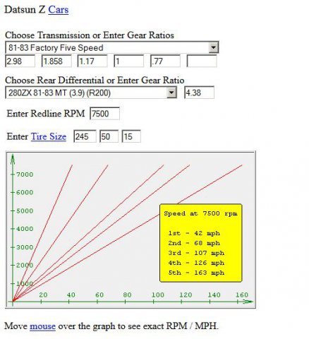

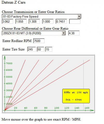

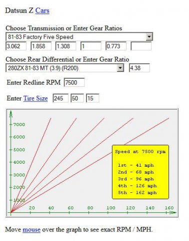

duragg Posted May 12, 2013 Author Share Posted May 12, 2013 I hope I did this right,,, going by above data I tried to capture each configuration. 1) Stock 1983 5 speed (for racing the 4-5 is a little long) 2) 1983 5 speed with 1977 Overdrive gears (not bad actually..) 3) Norms 1st configuration above 4) Norms 2nd configuration above 5) Norms 3rd configuration above COULD A MODERATOR PLEASE MOVE To THE DRIVETRAIN SECTION Pleeze? Quote Link to comment Share on other sites More sharing options...
NewZed Posted May 12, 2013 Share Posted May 12, 2013 #2 is the gear set that 1980 ZX 5 speed uses. For some reason Nissan only kept it around for one model year. I have one and 5th gear does feel like it belongs there, not a big jump to 5th. I had an 83 in my car for a little while and the 4-5 jump was noticeable. Quote Link to comment Share on other sites More sharing options...
duragg Posted May 12, 2013 Author Share Posted May 12, 2013 (edited) Yes. Good eye. I see that now. So a 1977-1980 5th gear would help that 4-5 reach a little for non-highway use. Thanks for pointing that out. I like the 1983 for the reverse-threaded main shaft nut. I have a 1981 / 1982 5 speed in pieces which has same ratios but not the reverse nut. My apology to the Moderators for "reporting" this post instead of just asking it to be moved. But thanks either way for moving it. Tj Edited May 12, 2013 by duragg Quote Link to comment Share on other sites More sharing options...

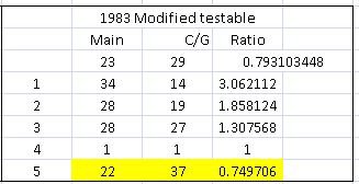

gereed75 Posted July 28, 2017 Share Posted July 28, 2017 (edited) OK, I know I am resurecting an old thread here but I am trying to learn. I am currently running a 510 with a stock 4 speed in vintage racing and sorely need to upgrade the trans. I scored what appears to be a very nice 82 NA five speed. I also picked up an NOS still in the box 32310-58S54 OD gearset. It is definitely 22 x 37. I also got these spreadsheets from another source labelled "83 modified and tested" and "Norm 12 sec mod". Main C/G Ratio 22 31 0.709677419 1 33 14 3.321429 2 27 20 1.902273 3 26 28 1.308442 4 1 1 1 5 22 37 0.837838 The ratios do not match Duraggs for the "83 modified testable" nor the "Norm 12 sec Mod" ..... but the 22/37 set yields a tasty .837 OD!! So now the question is (I guess) does anyone recognize the ratios in this table and what gearsets from where would yield them?? I am beginning to think I should just slap the 82 five into the 510 and take whatever improvement I get - very confused at this point. Great info in these threads by the way, Thanks (The spreadsheets got scrambled going over into the post so I had to just put the info in this table) Edited July 28, 2017 by gereed75 Quote Link to comment Share on other sites More sharing options...
