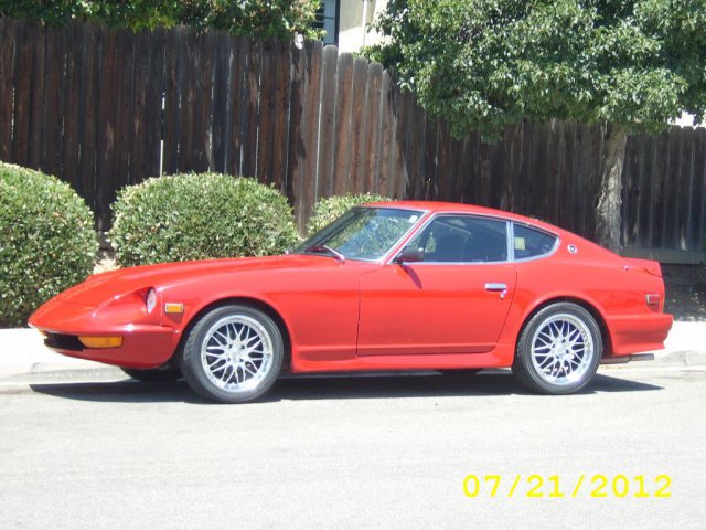

FrankieD Posted May 12, 2013 Share Posted May 12, 2013 The shop that's been working on my 71Z is hot to put an all aluminum Chevy LS something into it. I rode in a V8 powered Z once and it was fast but didn't handle the same or "feel" the same. They are saying that the aluminum V8 is lighter than the stock Z engine & will not change the handling. Any feedback will be appreciated. I'm also concerned about the Z suspension and R200 rear handling the extra power. Let me know what you think. Thanks, Frank Quote Link to comment Share on other sites More sharing options...
