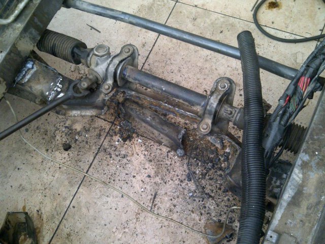

docaam Posted June 10, 2013 Author Share Posted June 10, 2013 Working on the engine mounts, cross member had to be dissected quiet a lot, will reinforce it with steel sheets where the line is, which will be done once new forester steering rack reaches here on Thursday. Might need to relocate the oil filter as well. Took a rollcage style pipe 1.5" will use it as new cross member welded to two plates which will lie on stock chassis rails, as we can weld anything on the chassis so will drill the rails and install steel tube to hold the bolts might put less stress on the rails. Mounts will be using stock for VQ35DE from 350Z, so far spacing seems tight but manageable Main issue which was worried about was exhaust manifold with the turbo so that fits without touching the chassis rails but still engine is more on right side then left so some small alternation might be needed. There is same plate with two holes and some provision is left to move engine front and back incase its needed For gear shifter might need some cutting as well where the red circle is marked but it will be done in the end. Quote Link to comment Share on other sites More sharing options...

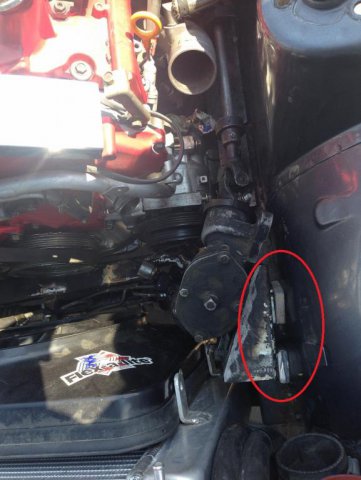

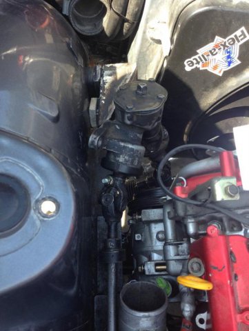

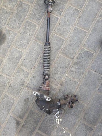

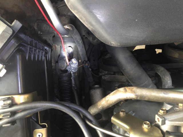

docaam Posted June 27, 2013 Author Share Posted June 27, 2013 Sorry couldn't post updates but there has been some progress, installing this engine sure is difficult We managed to get a custom cross member done for the engine now its in final shape and been tested already, with stock 350Z mounts With mounts on Installed the covers to see some space and test the mounts Drilled holes as will keep screws to hold the mount to avoid any registration issues AC compressor blocking stock steering rack Turbo might touch/melt the steering coupler but it will be removed with new rack Height without upper intake manifold seems ok New Steering cross member, clamps to hold the suby steering is not not finalized will use stock rubber bushes. Its basically will move the rack almost half an inch forward but gives good space for crankcase So with suby steering at least keeping AC compressor with a VQ engine seems to be solved there is around 3/4th of an inch gap and can be moved futher with adding another joint. Height might be an issue need some shaving of intake manifold Once steering rod is done will remove both cross members get those properly welded then grinding some epoxy primer and get it powder coated moving to exhaust manifold and fitting other parts. Quote Link to comment Share on other sites More sharing options...
Pharaohabq Posted June 27, 2013 Share Posted June 27, 2013 Oooh, that's a big change there with the rack, you'll need to be careful getting things lined up because you could really throw off the steering geometry. I'd heard of swapping the stock cross member 180 deg, but you still have the same geomety issue. The steering rack holds the mount for the lower steering arms and thus you can't move it and when you redesign you need to be really careful to keep those arms in the same location. Take a look at how that suspension is going to mount before you do too much more work in that direction. other than that, you can drop the engine another 1-2cm and consider a skid plate to protect the oil pan, that's a lot cheaper than shaving, but put your hood on and check before you change the height/shave. Quote Link to comment Share on other sites More sharing options...
docaam Posted June 28, 2013 Author Share Posted June 28, 2013 Coming to crossmember I checked pathfinder crank case I suggest using that to people it's atleast 2 inches shorter from front but as I made new for steering rack won't change now. Dropping engine also not possible need to do mounts again then and crank case might rub as I will keep car a bit more lower then now. I saw a S15 built with same engine he managed to shave middle and lower intake manifold around quarter of an inch or so will try shaving first and I ported it so might be better airflow there. Now for geometry I'm a bit worried as well on that part but I haven't changed the point where lower control arms meet its the stock one just removed the stock rack and stock cross member and this new fabricated one will make the Suby rack sit an inch forward which makes room for AC compressor as well. Once the mount is finalised will post pictures and might look for opinion. Outer tie rod end might needed to be replaced from Suby legacy to those bent ones common in toyota as Suby ones will be under slight stress just assuming at the moment. Quote Link to comment Share on other sites More sharing options...
Pharaohabq Posted July 1, 2013 Share Posted July 1, 2013 Right, okay, Well looking at the new steering crossmember for your rack, it's quite a bit different than the stock location. You may also need to add longer inner tie rods to adjust the angle. That's not to say it won't work moved an inch forward, but I'm not sue there's that much adjustment in the tie rod ends to allow it to be aligned. You've got it there, so you're going to be the best judge of what works. I get really concerned about the steering linkage angles using those Subi U joints. They're huge. Is it possible to rotate the Subi rack back so the Pinion points under the AC compressor? If you did that you could lower the rack and move it backward in the compartment under the main crank pully and the AC compressor. you may have to cut a scoop out of the driverside frame rail, to allow the shaft to come up to meet the steering shaft, but you'd get your steering back more to a stock position, while keeping your AC compressor. The Stock 350Z steering U joints are much smaller, which may make it easier to fit. I pulled 3 steering columns from the junkyard so I'd have enough U-joints, I'm sure you can order them from Nissan if your JY doesn't have them. Quote Link to comment Share on other sites More sharing options...
docaam Posted July 7, 2013 Author Share Posted July 7, 2013 Right, okay, Well looking at the new steering crossmember for your rack, it's quite a bit different than the stock location. You may also need to add longer inner tie rods to adjust the angle. That's not to say it won't work moved an inch forward, but I'm not sue there's that much adjustment in the tie rod ends to allow it to be aligned. You've got it there, so you're going to be the best judge of what works. I get really concerned about the steering linkage angles using those Subi U joints. They're huge. Is it possible to rotate the Subi rack back so the Pinion points under the AC compressor? If you did that you could lower the rack and move it backward in the compartment under the main crank pully and the AC compressor. you may have to cut a scoop out of the driverside frame rail, to allow the shaft to come up to meet the steering shaft, but you'd get your steering back more to a stock position, while keeping your AC compressor. The Stock 350Z steering U joints are much smaller, which may make it easier to fit. I pulled 3 steering columns from the junkyard so I'd have enough U-joints, I'm sure you can order them from Nissan if your JY doesn't have them. Yeah i guess inner and out tie rods needed to be changed. Actually so far haven't placed the tie rod ends and checked as I kept that for later once engine is in. Check the picture below steering rack looks a bit different once its all finished, the brackets holding the rack are stock suby ones. 350z U joint is a good idea will look into it, but I will leave all these till engine is IN, as things will be more clear at later stage. Cross members are done with finished. Grinding was done then rust proofed then painted matte black, looks much better Engine one Steering cross-member, still needs to be installed and checked for measurements Gearbox mount Will be using 350z auto transmission mount bushes Shortening of the gearbox is done as well, got almost 4 inches or more out Cut and weld Sent the car to get engine bay painted black Quote Link to comment Share on other sites More sharing options...
