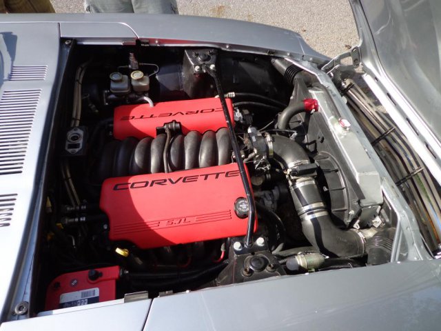

V8's  well there's a ton of engines that'll fit.  The S30 was originally designed for a V8, but the gas crunch and american emissions limited the S30 to the straight 6 that it got, but it fared VERY well with the "L" engines.  The LS engines are awesome, and pretty easy to fit. it's a matter of personal choice v8/v6 on that.  In the end it's your car and especially it's your $ so you do what you want, we will try to help...

As for a swap, for a six cylinder i'd go with either a VG or VQ engine. Parts are relatively cheap and easy to come by for both engines. If I was going V8 it would be a VH45DE. Still a Nissan engine and it makes 300HP stock and can make 350+ with just bolt ons. VHs can be had for a few hundred bucks from your local junk yard and with an adapter you can use either a Z32 or Z33 manual transmission.
