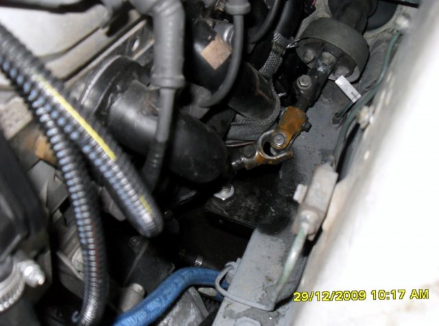

aveloz Posted January 7, 2014 Share Posted January 7, 2014 I used F body header on driver side . Had to cut steering shaft in half and added another joint and carrier bearing , still very close to . That's why I'm going turbo . forward facing manifolds . You won't have any problem with GTs or Camaros . With my stock setup , I was able to keep up with 2010 GT500 convertible ( heavy car , even with 550 HP ) . Mine is a lot lighter now too . No HVAC , no bumper reinforcements . Not pretty but it works . Joint angle is maxed . JPEG Image (30216243).jpg BTW , I sold the 83 T5 for $500 and the turbo motor for $400 . check this out i ended up making these suckers i reaally like them. Quote Link to comment Share on other sites More sharing options...

nismoluv Posted January 24, 2019 Share Posted January 24, 2019 On 8/29/2013 at 11:49 AM, Domzs said: I used F body header on driver side . Had to cut steering shaft in half and added another joint and carrier bearing , still very close to . That's why I'm going turbo . forward facing manifolds . You won't have any problem with GTs or Camaros . With my stock setup , I was able to keep up with 2010 GT500 convertible ( heavy car , even with 550 HP ) . Mine is a lot lighter now too . No HVAC , no bumper reinforcements . Not pretty but it works . Joint angle is maxed . BTW , I sold the 83 T5 for $500 and the turbo motor for $400 . What joint did you end up using. I am having problems finding the right spline count joint Quote Link to comment Share on other sites More sharing options...
G-Tech Posted January 24, 2019 Share Posted January 24, 2019 thats a pretty old post, you will be lucky to get a reply. looks like he drilled threw the shaft on both ends and just put a bolt threw it. there isnt any splines on the universal joint he used. your going to want to support that somehow or it will be floppy. he mentioned a carrier bearing, i think thats what the black painted tab you can barley see is for. the carrier bearing is probably mounted to that tab but you cant see it. Quote Link to comment Share on other sites More sharing options...
