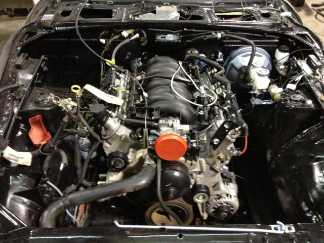

socorob Posted December 9, 2013 Author Share Posted December 9, 2013 ....And it's in! I must have looked at it for 20 min. Has anyone had any issues with the oil sending unit adapter? I can't screw my sending unit all the way down because it hits the block about halfway down. Should I just get a small threaded extension for it? Quote Link to comment Share on other sites More sharing options...
EastTnZ Posted December 9, 2013 Share Posted December 9, 2013 (edited) First of all congrats I did the same thing just staring at mine lol! Where's the sending unit going? Mine is behind the intake on top of the motor and I used an autometer fitting, then a 45 npt fitting and it works flawlessly. Or is yours located above the oil filter? Found the adapter: Autometer 2268 - 16m x 1.5 to 1/8" OPSU Plug Edited December 9, 2013 by EastTnZ Quote Link to comment Share on other sites More sharing options...
socorob Posted December 9, 2013 Author Share Posted December 9, 2013 Yes it's above the oil filter using johns cars little adapter. It's like 1/4" off. Quote Link to comment Share on other sites More sharing options...
Thisguy Posted December 9, 2013 Share Posted December 9, 2013 That motor looks brand new Quote Link to comment Share on other sites More sharing options...
socorob Posted December 9, 2013 Author Share Posted December 9, 2013 Yeah I lucked out. It only had 43,000 on it. Quote Link to comment Share on other sites More sharing options...

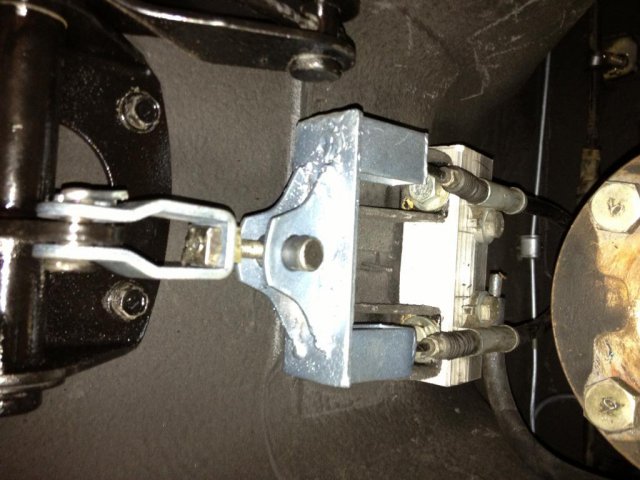

socorob Posted December 14, 2013 Author Share Posted December 14, 2013 I received my driveshaft from JCI yesterday so realized I couldn't put off dealing with the e brake hook up any longer. I have a combo of Z32 and Q45 brakes in the rear. The easiest thing I decided was to bolt a piece of angle to the brake cable mountings and bolt the Q45 cables to that. Then I had to make some sort of bracket using pieces from the Z and Q45 welded to a piece of flat bar. I probably could have made something a little prettier but it was a rainy day and I only had a few hours that I was able to squeeze in so I decided to do it with what I just had laying around. Quote Link to comment Share on other sites More sharing options...
RebekahsZ Posted December 14, 2013 Share Posted December 14, 2013 That looks great!! Quote Link to comment Share on other sites More sharing options...

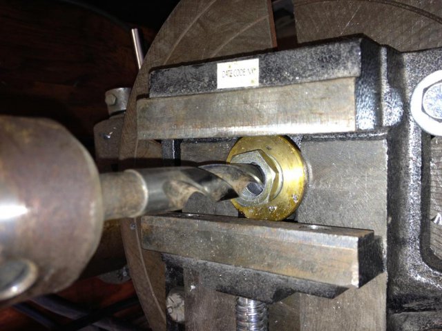

socorob Posted December 18, 2013 Author Share Posted December 18, 2013 Yeah I think they are more concerned about you catapulting yourself. I saw truck break the front u joint at a sand drag when I was a kid and it almost went back over front when the driveshaft speared into the ground. I had the same problem with the water temp sender I saw a few other people had in some old posts where the sending unit wouldn't fit into the JCI adapter. I just centered it up in a drill press and used a 9/16 bit to drill it down. I stopped about 1/8 from going all the way through to leave a lip for the wider part of the sending unit to contact/ seal against. I put a little WOG on the threads just to be sure it doesn't leak Quote Link to comment Share on other sites More sharing options...

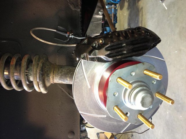

socorob Posted January 12, 2014 Author Share Posted January 12, 2014 Today I was able to make some decent progress after not touching the car all week. I put the 300zx hubs with longer studs on with Toyota calipers, hawk pads and slotted rotors. To use these hubs you need the spacer for the rotor. I used 86 hubs and slotted rotors. I used 300zx outer bearings, 280z inner bearings and 300zx wheel seals. I also drilled all the spot welds out of the slam panel on the hatch and removed it and did a small rust patch under it. Tomorrow I'll try to put the new one in. I think I will try to use body panel glue on it since its not structural and I think that will help keep water from being able to get under it again. Next I'm thinking about cleaning up the inside and using the rest of the lizard skin on it. Quote Link to comment Share on other sites More sharing options...
