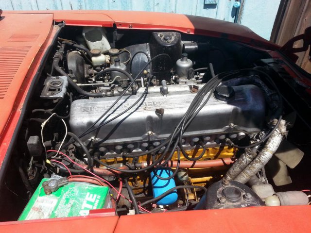

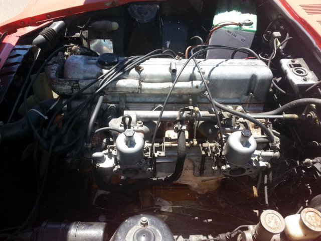

post-41064-0-35903200-1377975279_thumb.jpg Early SU swap was done by the previous owner, I found a receipt for a carb rebuild kit from MSA in the center console along with a Hitachi Instruction sheet

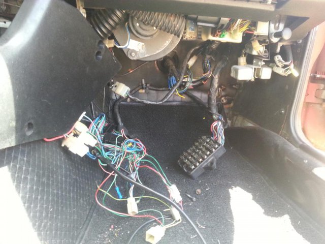

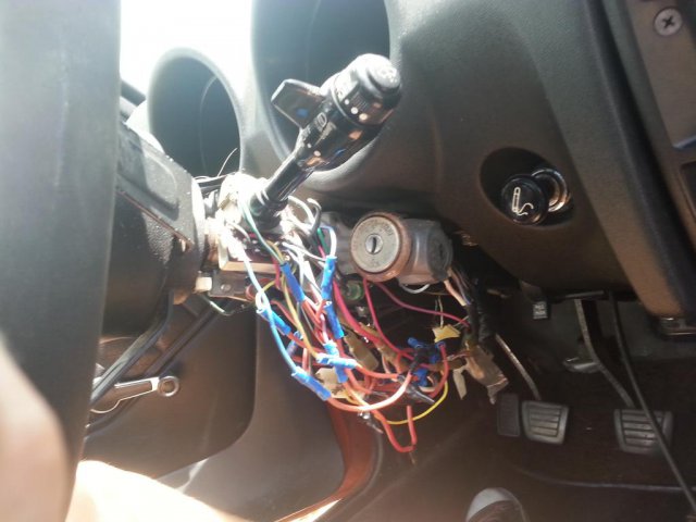

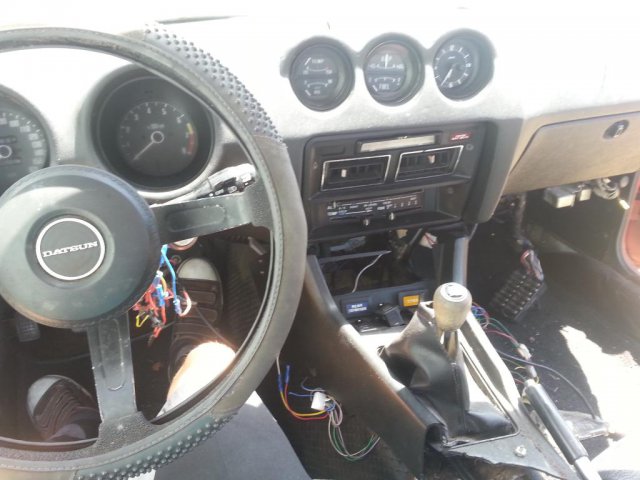

post-41064-0-77421700-1377975489_thumb.jpg the owner back in Washington seemed to have tried to do some rewiring, the guy I bought it from said he thought it was for a stereo and sure enough I found a used Alpine head unit under a rag in the hatch haha, anyone interested? :D

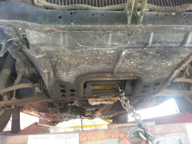

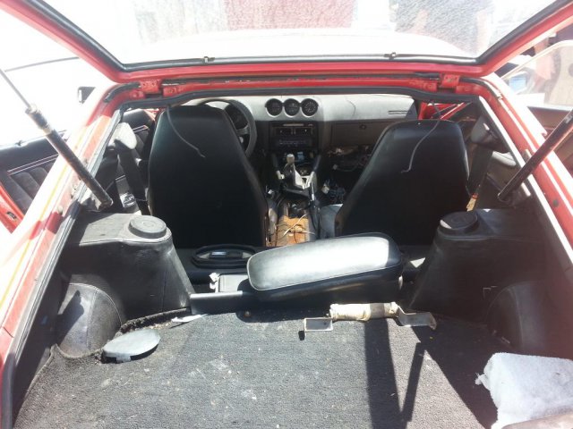

post-41064-0-28586200-1377975299_thumb.jpg Basically no rust on the car save for the edge of the hatch underneath the latch area, it looks like it might not be the original hatch but the hatch struts are and at least they work perfectly

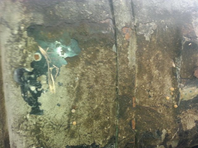

post-41064-0-28606700-1377975310_thumb.jpg Gas tank looks rock solid, except for a few spiders

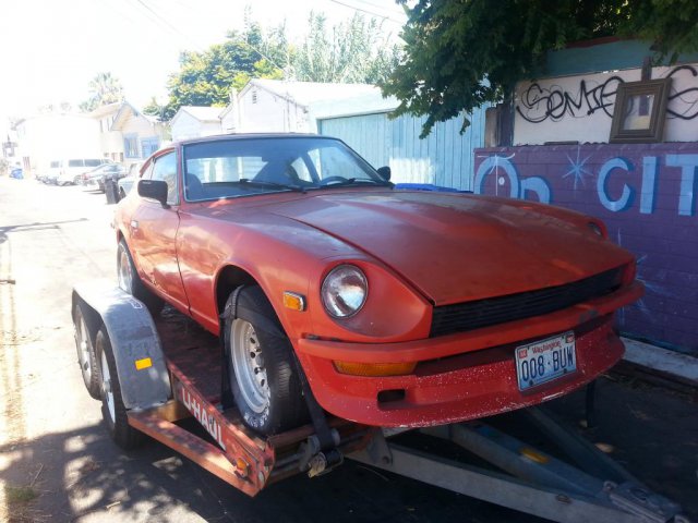

post-41064-0-35288300-1377975673_thumb.jpg On her way to her new home... my friend's neighbor's driveway haha, hopefully only for a week or two before she's running

So me and friend threw in a new electrical fuel pump (Facet-Purolator, 1.5-4psi) and bypassed the mechanical pump and the car fired right up! (With a jump, gonna need to see why the battery lost charge since last week...). When we disconnected the fuel line from the mechanical pump the line going from the pump to the carbs was bone dry, seems like the punp might be seized. But we just threw in another piece of hose and it's running great! I drove it around the block a little and everything actually feels really solid, no squeaks or rattles, clutch felt good, brakes actually felt better than my friend's 240z. Right now the pump is just wired to the battery so we will have to wire it through the ignition or something first. And then we'll tackle the electrical (I have no working headlights, turn signals, or any gauges) then maybe see if we can't tighten the hand brake cable. Overall it drove like a dream! Can't wait til she's ready for the long haul.

One of their guys took off and left the rest of them with a bunch of stuff to work on. I'm thinking I'm only gonna have them do the wiring and then I'm going to do everything else I can myself... they at least said the wiring should be done this weekend.

So what I need now is a new fuse box... any suggestions on what I can grab from the junkyard that will work? Basically no Zs in any yards by except very rarely, but basically everything else. Or my friend suggested I try the marine supply store in the area, they should have some good choices on modern blade-style boxes with enough cicuits. I need 14 fuses...
  • 2 weeks later...
So I eneded up buying two nice marine blade style fuse boxes.... only to have the shop tell me they won't work... two days after I gave them the boxes and they said "oh looks good". So they ended up being able to use the regular round fuse boxes they had gotten before, and pretty much everything seems great:

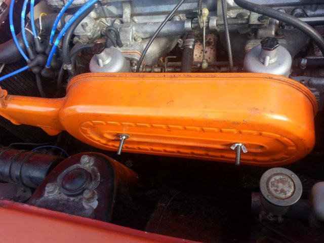

So I bought some M8-1.25 all thread and cut some bolts for the air filter and mounted it.

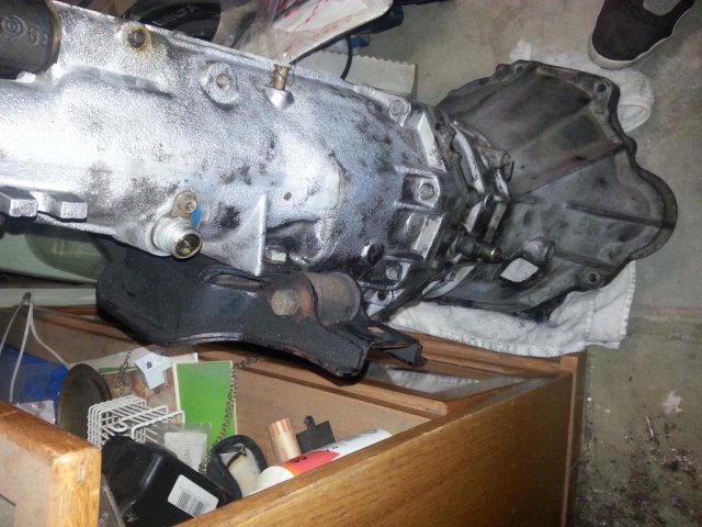

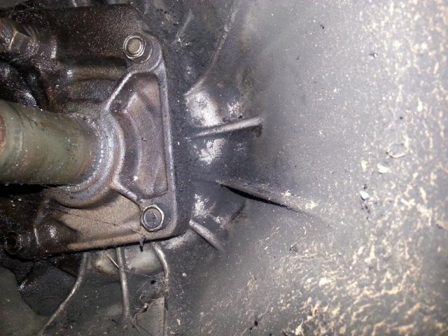

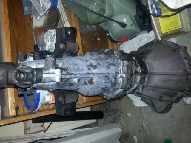

4) 5 speed transmission, just bought one today for $125 (couldn't pass it up, a steal and also is supposed to be one of the refurbished ones by Nissan), probably gonna throw it in sometime over break since it's here and I can do it quickly and easily with some help.
Odd angle, but everything look great in the bellhousing and putting through the gears felt brand new, can't wait to put it in the car.
