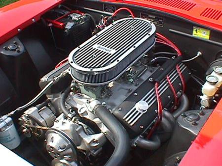

I used the MSA V8 kit on two 350 SBC T5 trans projects. I prefer it to the JTR kit because the trans mount goes up inside the trans tunnel and allows more flexibility in setting drive shaft angles. The MSA kit is designed for the 700r4 transmission, but also works with the T5 transmission.  The JTR kit also has benefits. Search for JTR and MSA kits for details.

I currently have an older 4 bolts 350 block with the vortec heads and and T-5 in my 74 260Z.  I used the JTR setup for the mounts and crossmember.  The crossmember bolts thru the floor pans on each side.  I used fender washers to help spread the load as much as possible.  I used a wildwood master cylinder (bolt pattern match exactly) with a braided line to the original slave cylinder on the T-5.  You will either have to buy the adaptor to couple this line to the slave cylinder or take the original fitting from the slave cylinder and modify it to allow the screw on line to couple to it the push and pin to slave cylinder.  The information regarding the piston size and other information is all in the JTR book.  It has many other items such as how to make all  of you original gauges work with the conversion.  The speedo is 5 mile hr off and the clock don't work.  Every other gauge works fine including the tach.  Blast to drive.
