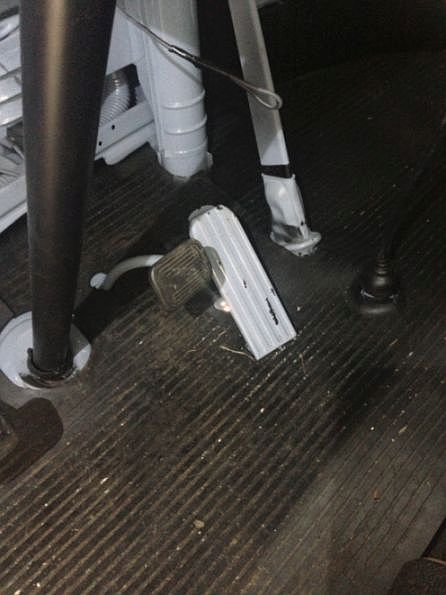

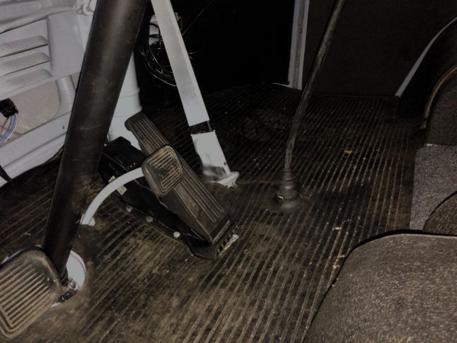

Tony D Posted June 9, 2014 Share Posted June 9, 2014 Obviously intent on not overthinking the problem presented (snapped leaving MSA this past April): Quote Link to comment Share on other sites More sharing options...
Administrators RTz Posted June 9, 2014 Author Administrators Share Posted June 9, 2014 Pretty functional I would guess. Quote Link to comment Share on other sites More sharing options...
