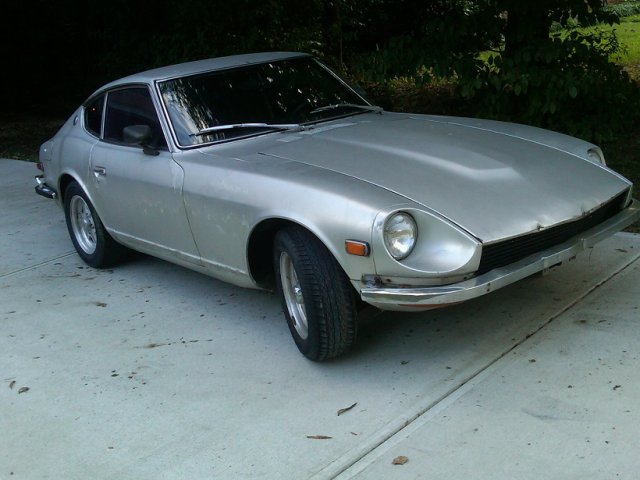

BobG Posted September 16, 2013 Share Posted September 16, 2013 Just got a '72 240Z - first time owner... car sat for a bout a year in previous owner's driveway. Ran new fuel lines and ran new wiring to the alternator and VROOM she started up immediately. While driving around this weekend (first time out) there is a noticeable "thump" in the rear end when I let go of the gas. Is this normal? There is no loss of engine power, no loss of steering control, no effect at all. Just a "thump". A friend used to have a 260 and said it did the same thing. Anyything to be concerned about? Quote Link to comment Share on other sites More sharing options...
