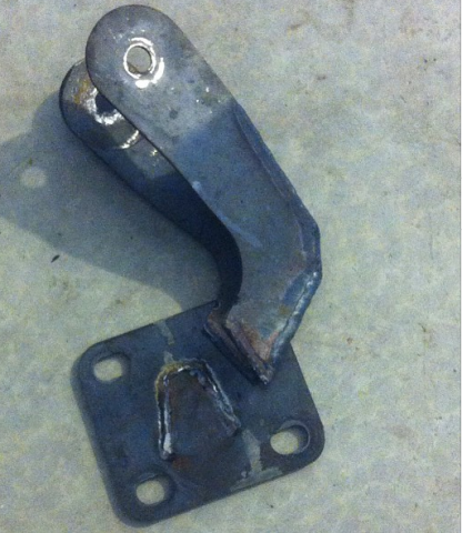

rzamvilla Posted October 17, 2013 Share Posted October 17, 2013 Some guy on instagram (lookitsrich), possibly a member here has the whole CX racing mounts and stuff. I saw a picture of a snapped motor mount, keep in mind he does race his Z. Now that's not saying any of you won't, but fact is it was broken Quote Link to comment Share on other sites More sharing options...
Big Ben Posted October 21, 2013 Share Posted October 21, 2013 Welds look shitty..I have seen some other their other products and most of it is cheap knock off crap. Buy Mckinney products and a pan from Pat! Quote Link to comment Share on other sites More sharing options...

Spoony Posted October 28, 2013 Share Posted October 28, 2013 These engine mounts look like crap, sorry. There is so much that can go wrong when you weld metall. Imagine the welding didnt go through the complete mount, would look good but would break when you put power on it. Thats the main problem with chinese stuff. Would be ok for a unimportant car part like exhaust manifold. You can weld it when it breaks, but you will get big trouble when the engine mounts break. Go and buy some mounts from mckinney, they look much more solid and have proofen to hold big powers. Same with the oil pan, get someone who can weld well or just buy it from pat. same here, everybody seems to be lucky. Like a wise man said: Im to poor to buy cheap stuff Quote Link to comment Share on other sites More sharing options...
24zer0 Posted November 10, 2013 Share Posted November 10, 2013 I got the mounts and pan, mounts look ok but after seeing the pic of the broken one I added some more weld on the inside of the mount as it was only welded on one side. The pan flange was far from flat and I chose to have it surfaced and they took off .008 to get it flat, also a few of the holes where not lined up properly and needed filing to clear the bolt holes. And finally the pickup that comes with the pan sat up to high in the pan for my taste, so I modified a stock unit to sit better in the pan. I should have got a pat pan and suggest others to do the same. Quote Link to comment Share on other sites More sharing options...
