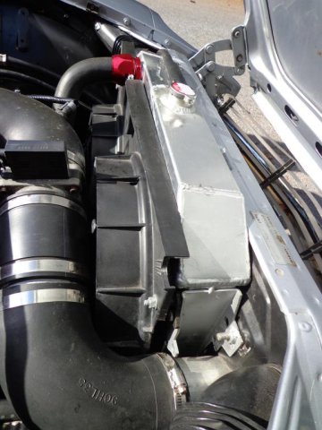

Zfan1 Posted October 12, 2013 Share Posted October 12, 2013 I am having strange cooling issue and was wondering if anyone else has gone thru this. Â Driving around town it runs around 180 degrees, on the highway it runs around 190-200 into a head or cross wind. As soon as I drive down the highway with a tail wind the car heats up to 225 and eventually will overheat. Has anyone had similiar issues? Â I am running a L76/4L80E combo with 4 core Griffin radiator/Ford Taurus fan on high, fan comes on at 180 and shuts off at 170. Was wondering if I have a turbulance issue, trans cooler and cone air filter are out in front of the radiator which can effect airflow but why only with a tail wind. I am looking at blocking all circular vents on the radiator core support and sealing up around the radiator core support to force more air thru the radiator to see if that helps, kind of crazy, never was like this with my old set up. Â We took it to my buddies shop and made sure all the air in the system was evacuated, installed a new radiator cap (15 lb), not sure what to do next, maybe an air damn deflector or something to drive/guide more air into the radiator area. Â Thanks for any idea's or comments you might have. Â Mike Quote Link to comment Share on other sites More sharing options...

Zfan1 Posted October 13, 2013 Author Share Posted October 13, 2013 Well, I moved the large cone filter away from the front of the radiator and also found the the new radiator cap was not sealing, replaced it and drove it around last night. It ran 180-195 on the highway and 165-180 around town. Hopefully fixed the issue. The Taurus fan is wired on high thru the ecm and comes on at 180 and shuts off at 170, I am running a 160 thermostat. Â I am going to seal around the radiator and core support as I have a gap of around 1" on either side of the radiator that is open and see if that helps force more air thru the radiator. Quote Link to comment Share on other sites More sharing options...

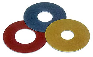

Miles Posted October 14, 2013 Share Posted October 14, 2013 I had the same problem and solved it with a Moroso water flow restrictor:Â Â http://www.jegs.com/i/Moroso/710/63440/10002/-1 Â Try the middle sized restrictor. Quote Link to comment Share on other sites More sharing options...

ktm Posted October 16, 2013 Share Posted October 16, 2013 (edited) Keith, the Ford Taurus and Lincoln Mark VIII fans are dual speed fans with a single fan. Â There is a ton of information on the 'net as well as Hybridz/LS1tech about this (and the Lincoln Mark VIII) fan. Â With the Taurus fan and Volvo relay, you get 2 speeds with the single fan. The low speed grounds the low speed relay and the high speed grounds the high speed side of the relay. There is a wiring diagram I think I found it on LS1 tech for this setup. Â Exactly. Â Mike, your car really should not be overheating. Â I have a very similar setup: LS1/4L60E, cone filter protrudes from the side into the radiator area, and the trans cooler hangs down a little in front of the radiator. Â I know you said you and your buddy made sure you tested the system for air, but it could not hurt to check again. Â Have you checked the thermostat? Â Is it opening? Â It sounds like your fan is operating on high the entire time you are driving (both around town and at highway speeds). Â Just had a thought.....what about your lower radiator hose? Â I had a helluva time trying to source mine so I cobbled together an ugly frankenstein hose. Â Recently, Â got tired of looking at it and decided to replace it. Â Well, all of my replacements wound up severely kinking after one heating cycle. Â I went a slightly different route and used two 90ish elbows with a section of aluminum pipe. Â What is the condition of your lower hose? Edited October 16, 2013 by ktm Quote Link to comment Share on other sites More sharing options...

Zfan1 Posted October 17, 2013 Author Share Posted October 17, 2013 (edited) I am going to check the thermostat this weekend, it's a first gen sbc 160 thermostat, reason is we used the straight neck billet water outlet in place of the traditional LS style that is mentioned on this site. The lower hose has not collapsed that I know of, the condition of the hose seems ok, maybe I need to install a spring though just for insurance. I do not know if you can control both fan speeds by ecm only, currently I have the hi speed hooked up but will switch it to the low speed and see what happens. We evcuated all the air from the cooling system at my buddies shop, they use a machine for that purpose.  What would restricting water flow do to help keep the car cool on the highway, not sure I follow that one, sorry. We are going to redesign the fan shroud as well, the newer cars have flaps that allow air to move thru the radiator and shroud more efficiently. Edited October 17, 2013 by Zfan1 Quote Link to comment Share on other sites More sharing options...
