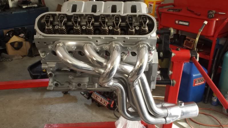

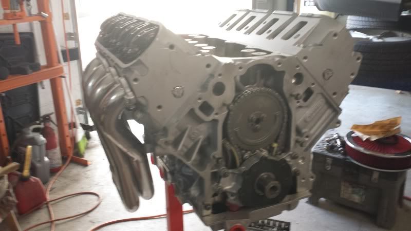

Mikelly Posted November 8, 2013 Author Share Posted November 8, 2013 Motor has arrived... Quote Link to comment Share on other sites More sharing options...
