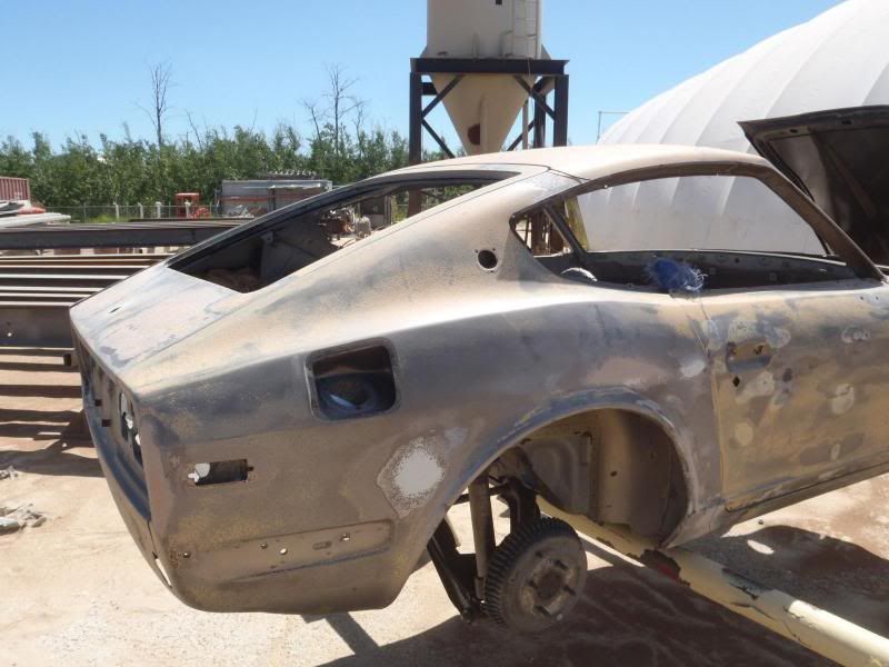

takayuki Posted October 30, 2013 Author Share Posted October 30, 2013 So I bought this car sight unseen. Picture on the ad looked great, seller sounded honest..Boy was I wrong! The only good thing about this car was the interior. Engine bay had a lot of overspray and the paint was orange peeling. I was not impressed. This is the point where I decided to do a complete restoration on the body. Since I have no patience and skill with bodywork, I sent my car to a local custom bodyshop, after I stripped the entire car. This is where it gets ugly. The bodyshop started blasting the body, but had to stop part way because this car was CAKED with bondo. They didn't want to heat and warp the body. I was told that this car had 5 layers of paint and a ton of bondo that hid dents and rust. Quote Link to comment Share on other sites More sharing options...

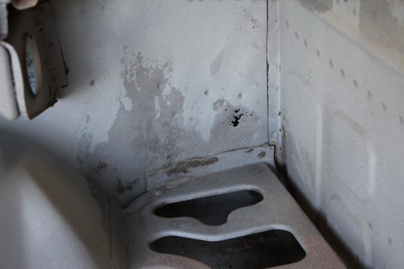

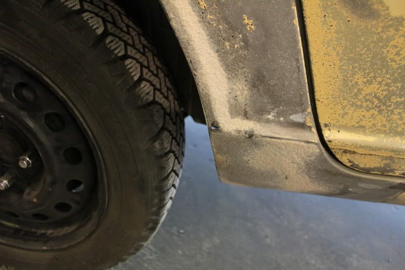

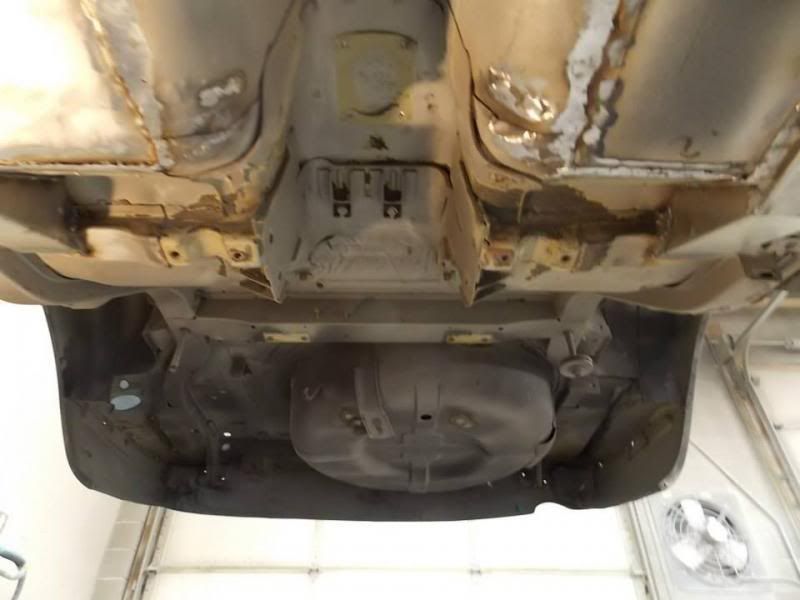

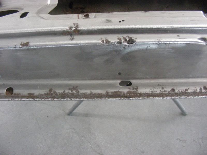

takayuki Posted October 30, 2013 Author Share Posted October 30, 2013 Since sandblasting didn't work, they removed all remaining product by hand Here are some pictures of damage and rust that became apparent and there's more but I think this is enough.. Quote Link to comment Share on other sites More sharing options...

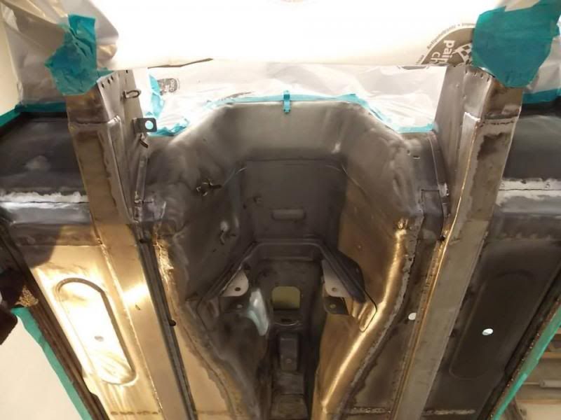

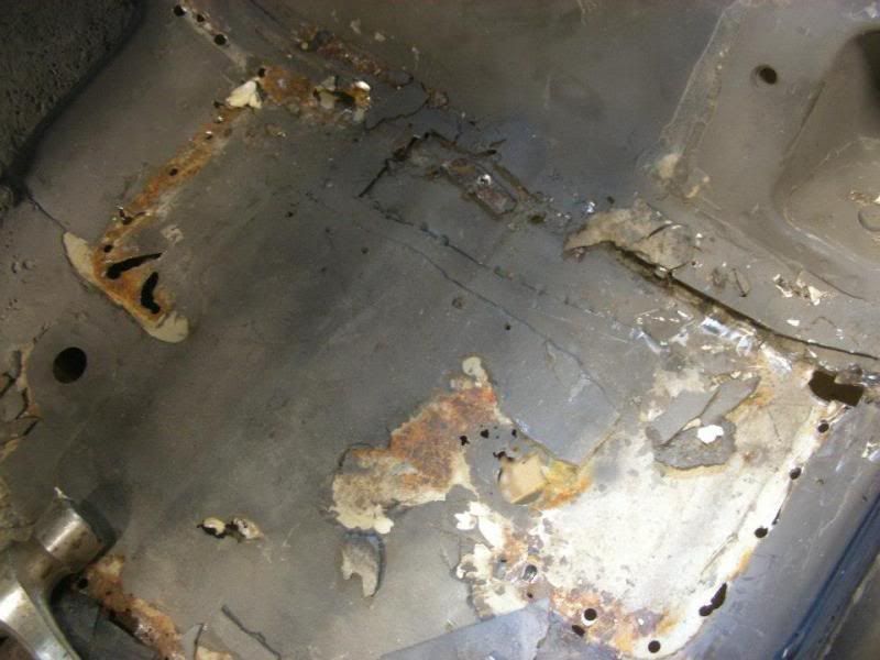

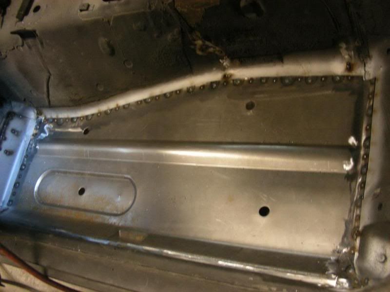

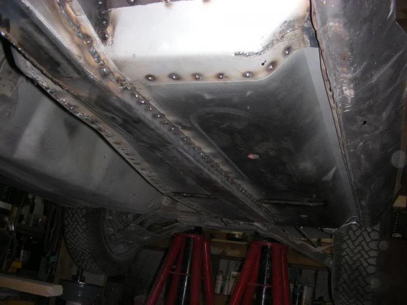

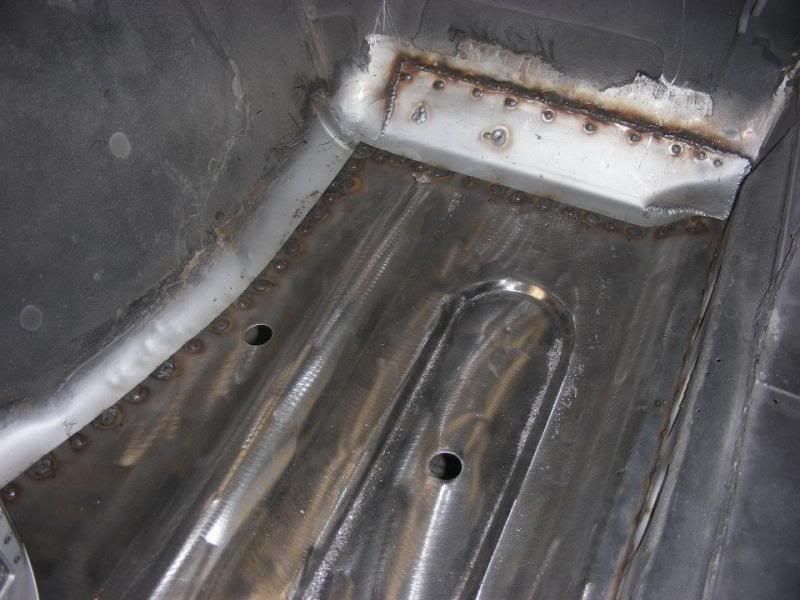

takayuki Posted October 30, 2013 Author Share Posted October 30, 2013 since both passenger and driver side floors were rusted, it was replaced with zeddfindings floor pans and bad dog frame rails and seat brackets. Quote Link to comment Share on other sites More sharing options...

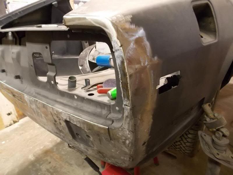

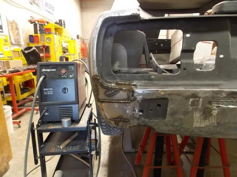

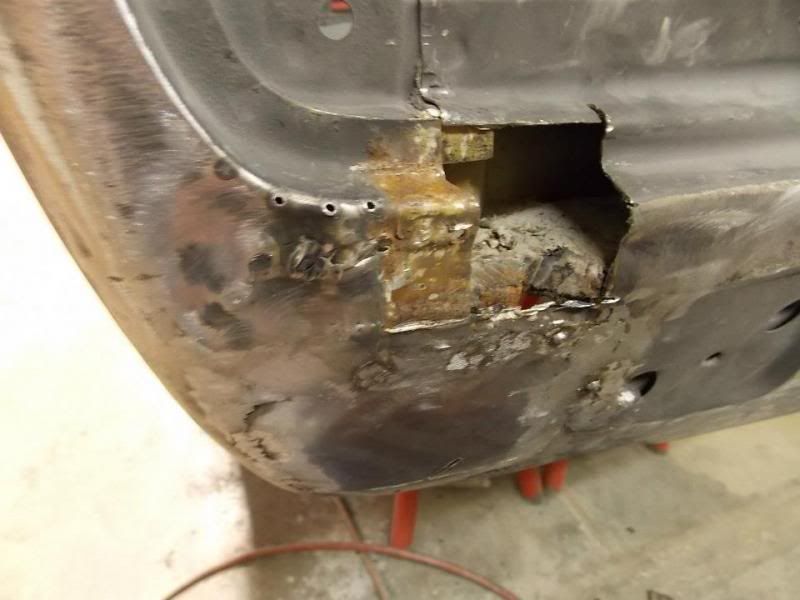

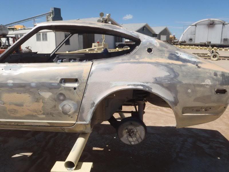

takayuki Posted October 30, 2013 Author Share Posted October 30, 2013 There was some damage at the rear driver side corner. Rust and damage repaired! Also shaved bumper shock holes. I will install 240z bumpers using JDM bumper brackets. Quote Link to comment Share on other sites More sharing options...

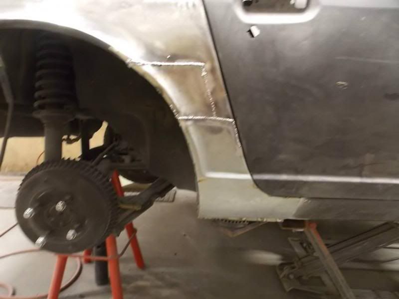

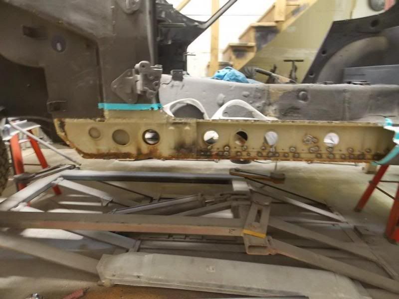

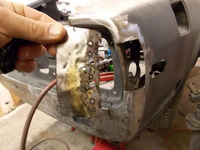

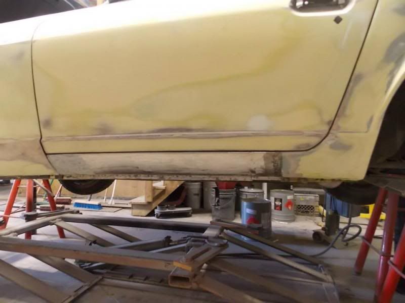

takayuki Posted October 30, 2013 Author Share Posted October 30, 2013 Next up, driver side rocker panel. It had a dent the size of my forearm. So we decided to replace the whole thing Repaired! Quote Link to comment Share on other sites More sharing options...

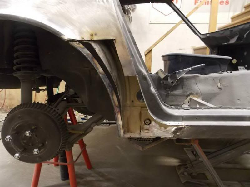

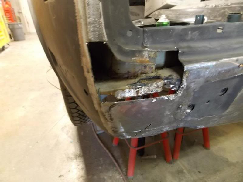

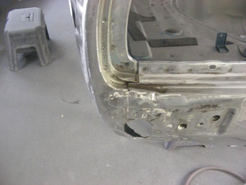

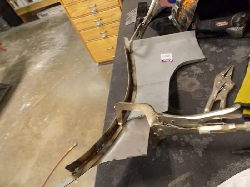

takayuki Posted October 31, 2013 Author Share Posted October 31, 2013 more pictures..... fixing rusty dog leg on passenger side. Drivers side was just as bad. cut fab with tabco replacement panel. (had to do a lot of reforming) weld in dented corner repaired antenna hole shaved Quote Link to comment Share on other sites More sharing options...

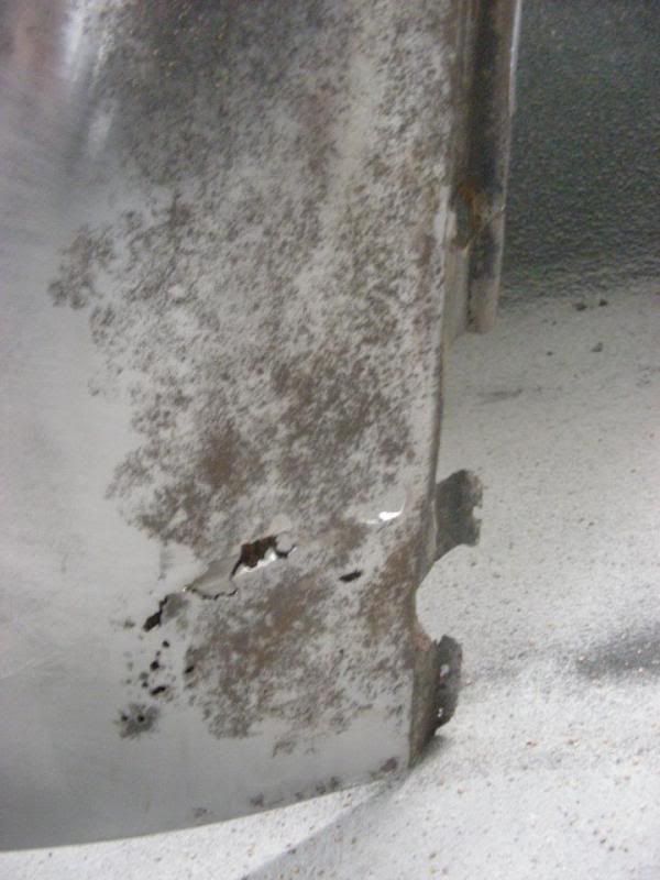

takayuki Posted October 31, 2013 Author Share Posted October 31, 2013 this is why sometimes its good to get a blast. Metal was so thin, it made a hole. It wasn`t there before! Quote Link to comment Share on other sites More sharing options...

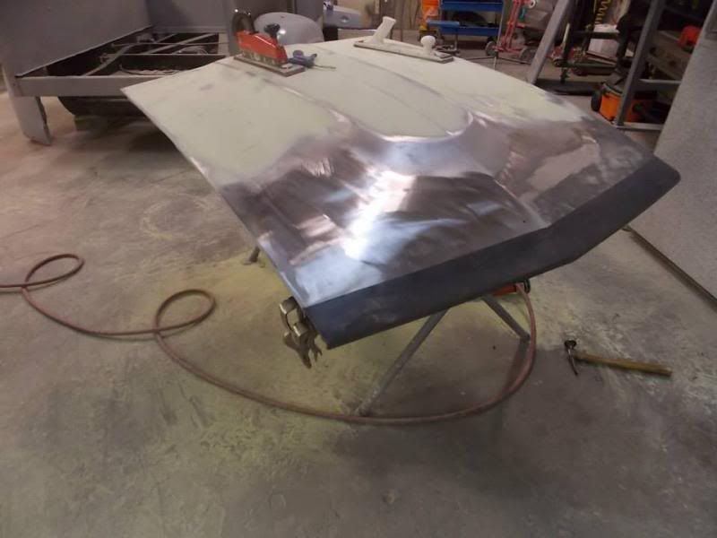

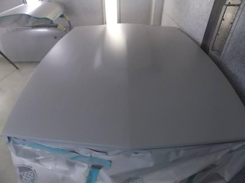

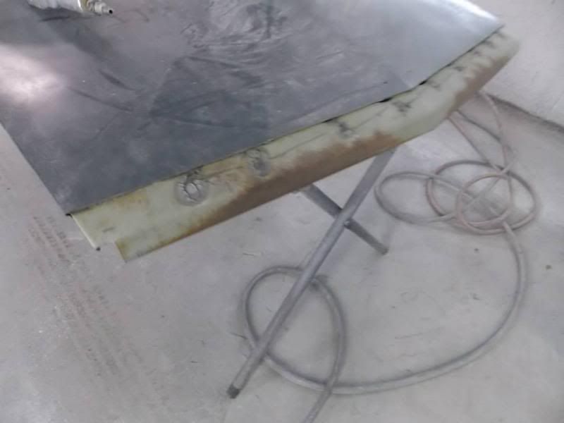

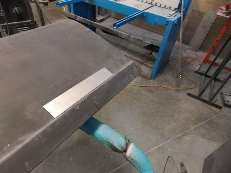

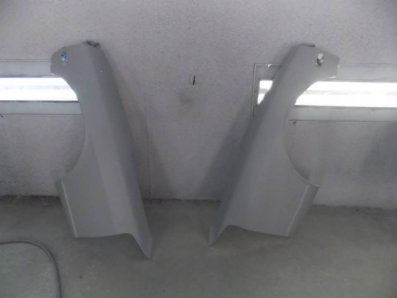

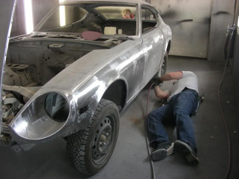

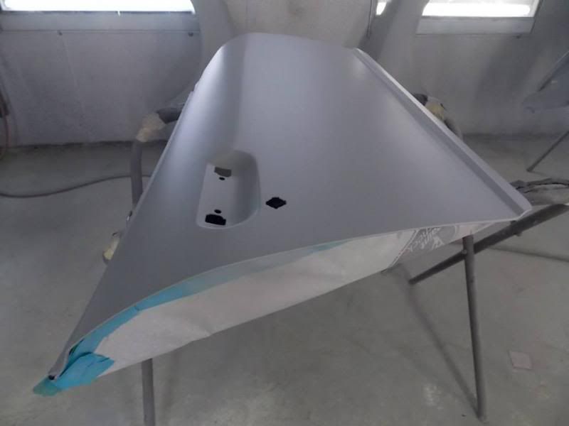

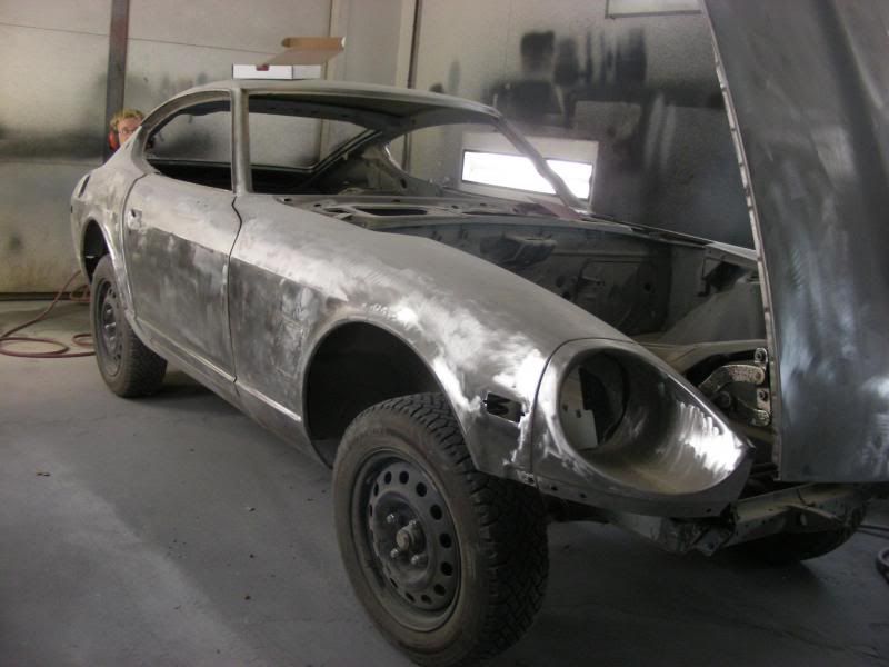

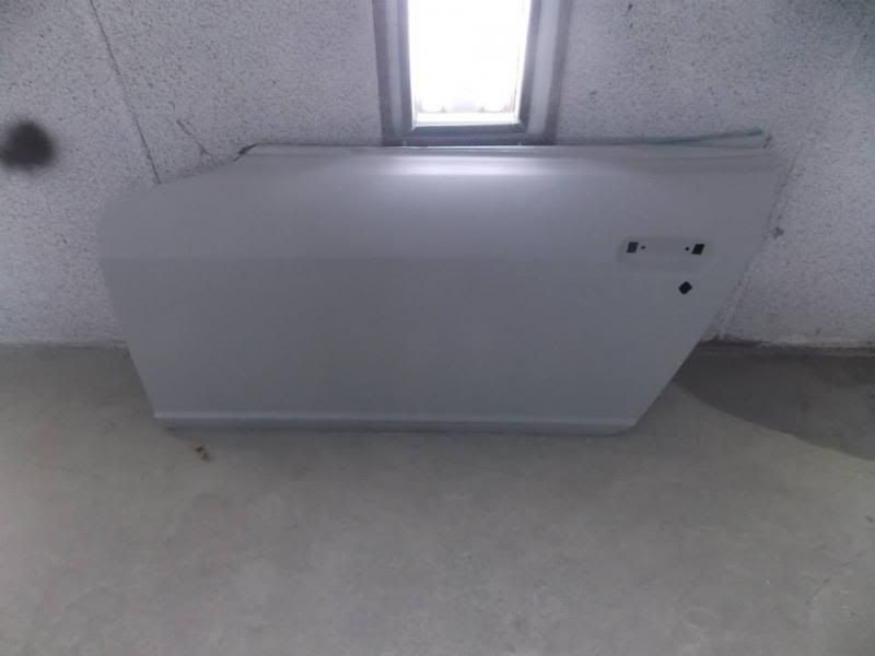

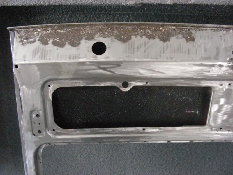

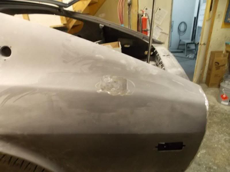

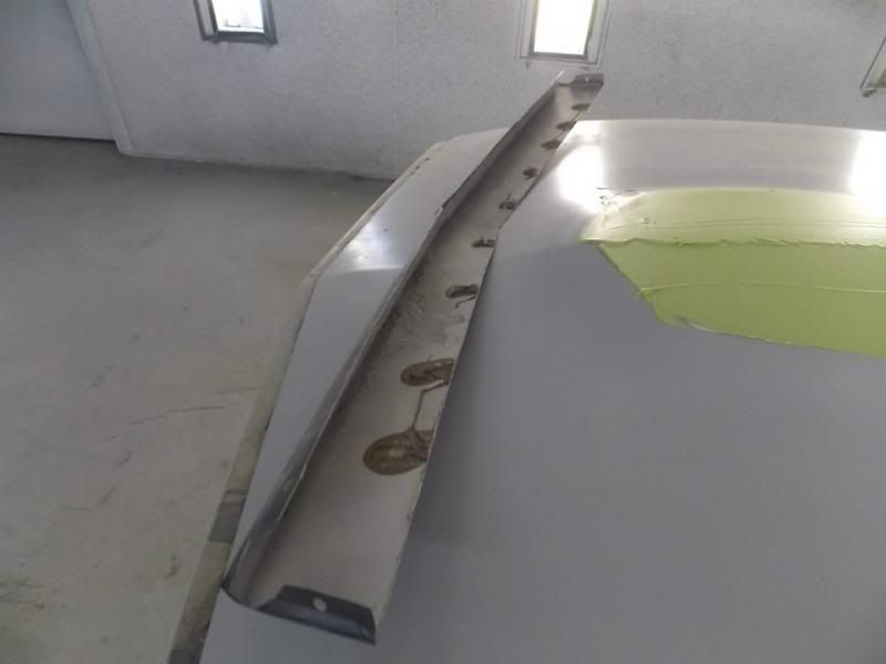

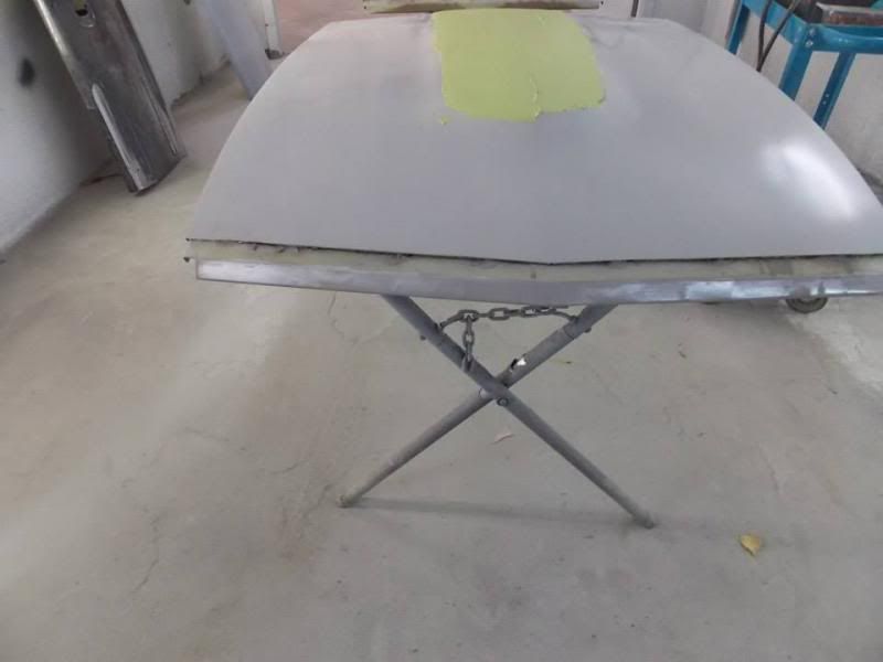

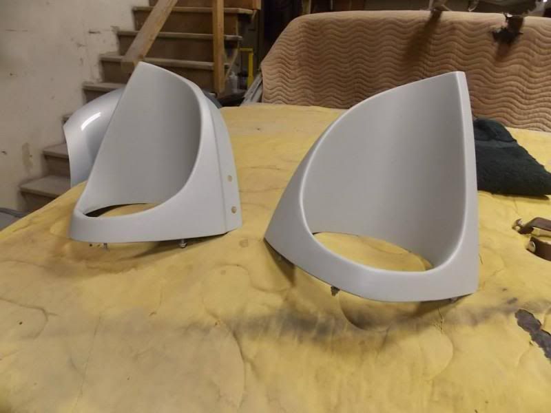

takayuki Posted November 9, 2013 Author Share Posted November 9, 2013 So the original hood that came with the car was dented in and full of bondo. I purchased a used hood. It looked good initially but after sandblasting it, it revealed heavy rust pitting at the nose. The old hood had a good nose piece so we used that as a donor remove nose from old hood remove nose from other hood Repaired! all ready in some slick sand Headlight buckets were the only good thing on this car. lol. Ready to go in slick sand as well. Driver side door all repaired! This door had some rust repair done. Had door mirror holes welded.(i'm going with fender mirrors) passenger side door likewise. Nice and straight! Both front fenders ready! Passenger side is brand new OEM. Suprisingly, it needed some work to make it fit right. Had to add metal and take metal off at some places. up to this point, its been 2.5 years! Quote Link to comment Share on other sites More sharing options...

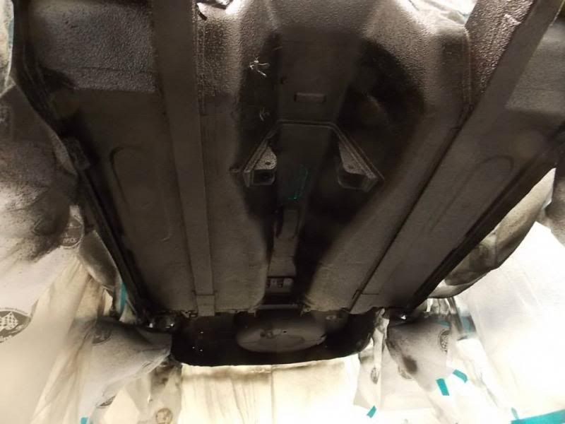

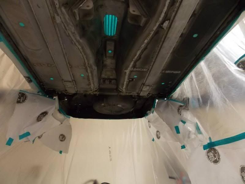

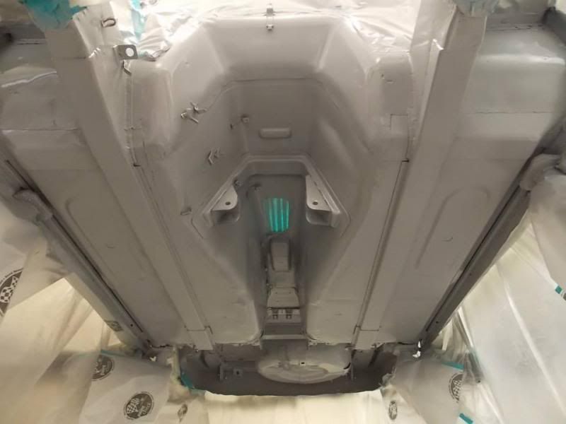

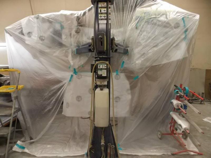

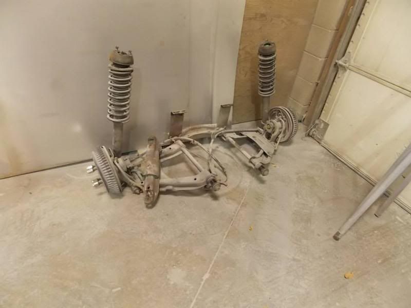

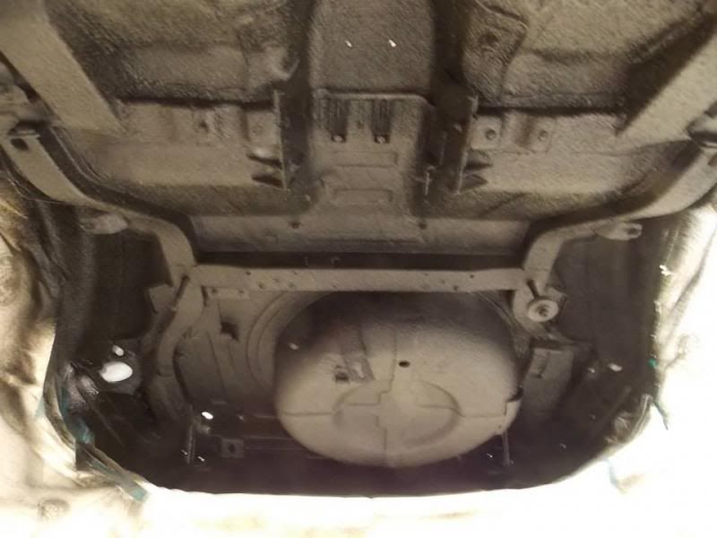

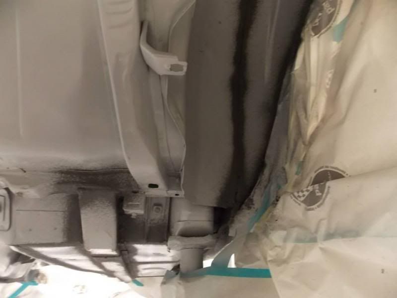

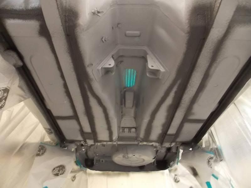

takayuki Posted November 15, 2013 Author Share Posted November 15, 2013 Things are finally moving on. Underside was mostly completed this week Dropped rear suspension assembly Final Weld and cleaning up Time for some epoxy underneath! Epoxied! Some seam Sealer. You can also see the BAD DOG rear frame rail extension. Sealed with some Scorpion undercoating. Looking much better! Next up, should be rear hatch repairs, fitting on some flares.. Shouldn't be too long after that! I can't wait until I get my car back.... Quote Link to comment Share on other sites More sharing options...
