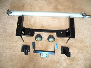

devil280Z Posted January 7, 2014 Share Posted January 7, 2014 If someone here can confirm for us that your motor mounts sit at the same spot as mine do, I can build you a pair when I fab mine up. I am running a 2jzge in a '73 240z. I am looking to get some made for my 1JZ swap also. Its pretty much the last thing i need to get done to finish my project. Please let me know if you are able to make a set for me also and when you will be making them. If you could message me with your number so i can call and get it all figured out that would be great. Thanks, Ben Quote Link to comment Share on other sites More sharing options...
AJA S30 Posted January 8, 2014 Share Posted January 8, 2014 Hi guys. This would be my first reply to Hybrid Z. Great forum! I thought some of my info might be useful. I have a 72z that's getting a 1jzgte vvti/R154. I bought the kit to install my engine/trans combo from Tech2 Motorsports and I have to tell you, it's very nice. The driveshaft BTW, is alum and becaues I'm using an r200, he made sure to have the correct u-joints for my install. Carlos, the owner, not only is a good guy but has a ton of 1j/2j experience. He is a big fan of the JZ engine and has done many Z's with them. So far I've been in the 'collecting' mode for my project and haven't had a chance to see how it lines up in the car. But, if it goes in half as good as it looks, I'm going to be 'ok'.... devil280z, how is your project coming along? Any words of advise?..lol... Quote Link to comment Share on other sites More sharing options...

JacobsZ Posted January 9, 2014 Author Share Posted January 9, 2014 My fiance saw that i'd been looking at the kit and she purchased it. Theres no refunds so i already know i'm going to have to modify it but hopefully it isn't to much difficulty. Quote Link to comment Share on other sites More sharing options...

devil280Z Posted January 10, 2014 Share Posted January 10, 2014 devil280z, how is your project coming along? Any words of advise?..lol... Just picked up the motor today from the machine shop, looks great!! Saturday i am going to put the intake and exhaust on. I cant wait, going to be amazing. The only thing hanging me up right now is that fact that i need a engine mount. I dont trust my own skills to make it myself and i cant spend 1500 for the Ebay kit. Soo freaking close i cant stand it..... I will try and get some pics uploaded for you guys on my build post. Quote Link to comment Share on other sites More sharing options...
JacobsZ Posted January 16, 2014 Author Share Posted January 16, 2014 So, i have realized that my fiance is an idiot, bless her heart. But the kit will not work at all with my 280. So, i'm selling it for 1000 bucks for everything or trading it for mounts for my zx. Pass the word round. Quote Link to comment Share on other sites More sharing options...
grayson260z Posted January 21, 2014 Share Posted January 21, 2014 Hi all im new to this forum so take it easy on me. I recently got a stellar deal on a '74 260z that has "a little rust" but i picked it up for 800 dollhairs then come to find out it had 4 boxes over flowing with nissan boxes and spare parts. not to mention some tinted headligh covers and factory rubber (traded for a 5 speed swap for the l26.) But anywho I am super interested in a VVTI 1jz swap for it but a solid idea for a motor mount still eludes me. As soon as i started looking into the idea i came across BetaMotorsports and their crossmember and all they sold but they shut down. And im sure that image isnt right but i was wondering if anyone has the specifications of the beta crossmember that they might "share" with the community so i could have a better idea of recreating one (with all credit due to John from BetaMotorsports) thanks guys - Grayson http://images.google.com/imgres?q=betamotorsports%20crossmember&safe=active&bih=695&biw=1440&tbm=isch&tbnid=Cd07xccpCnT-RM%3A&imgrefurl=http%3A%2F%2Fforums.hybridz.org%2Ftopic%2F61936-my-1jz-260z%2F&docid=4voAHrbLJi5zAM&imgurl=http%3A%2F%2Fi176.photobucket.com%2Falbums%2Fw178%2Ftimbo1j%2F260z003.jpg&w=1024&h=768&ei=xJreUtXRDoudkQeP14CIBw&zoom=1&iact=rc&dur=447&page=1&start=0&ndsp=17&ved=0CFkQrQMwAQ Quote Link to comment Share on other sites More sharing options...
