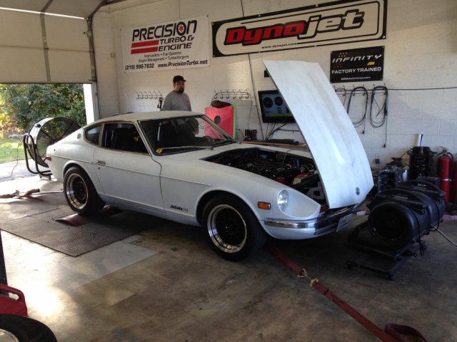

EastTnZ Posted October 27, 2014 Author Share Posted October 27, 2014 Well I was recommended to a local performance shop to get my car dyno'd before I install a cam in the next few months and will go back there to see the gains. I should've cleaned the soot out before going but the ole 5.3 didn't do too bad. 3 pulls for $60. Considering its a stock factory rated 285hp at the crank that's ok for a baseline pull. Longtubes may help a few horses but not worth the headache to me for the price. If I can find one I'm thinking LS6 intake. Stock 5.3 - LS1 Intake - Tunedbyfrost Mail Order Tune 93 Octane Pull 1 - 5200 rpm (259/287) Pull 2 - 5200 rpm (263/291) Pull 3 - 6000 rpm (274/302) (Hp/tq) TSP Torquer V2 might be happening in the future... 232/234 .595/.598 112LSA Quote Link to comment Share on other sites More sharing options...
