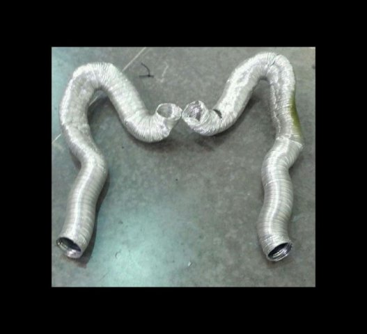

This didn't rub and worked great until I added another 100hp and a really short track.
Can't find my pic of them installed.
3" aluminum flanges from Aircraft Spruce, up and over wheel arch and direct to rotor center.
