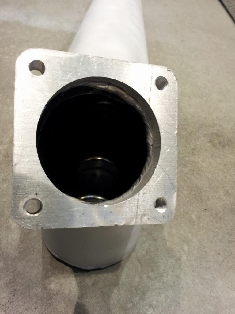

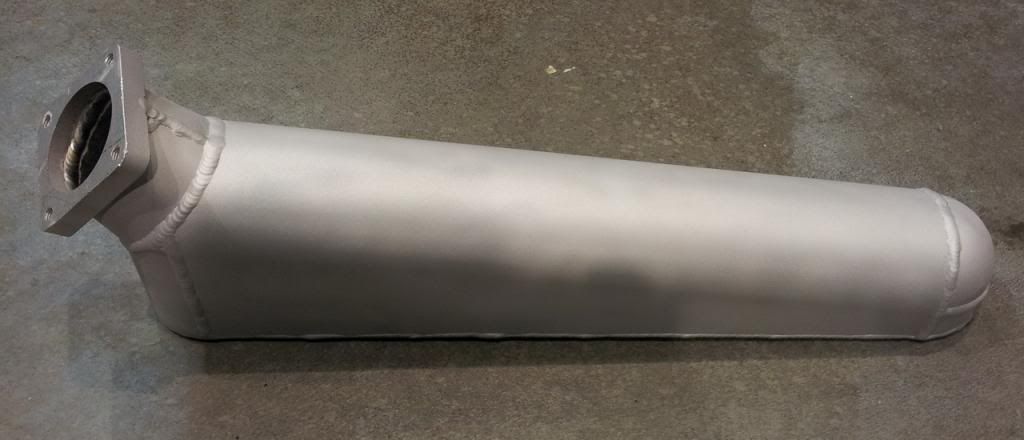

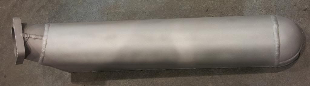

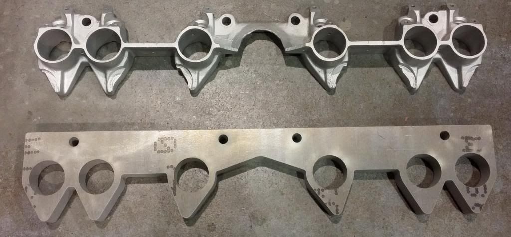

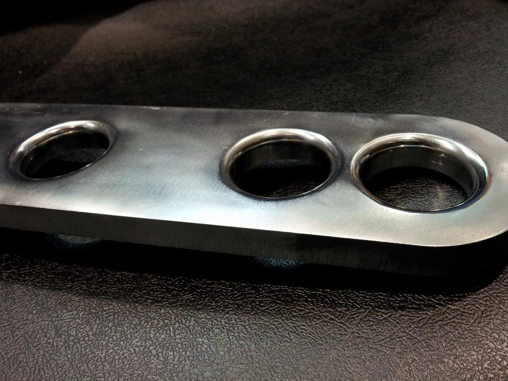

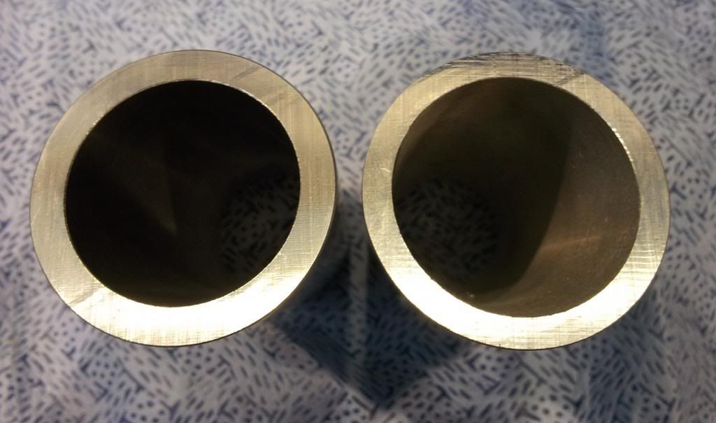

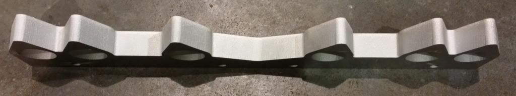

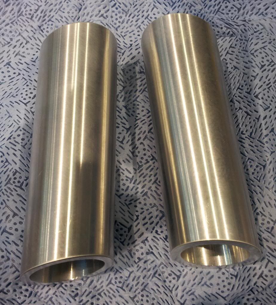

FricFrac Posted January 17, 2014 Share Posted January 17, 2014 Here is my project I've been brewing for a LONG time finally starting to come together. Almost ready for injectors Radius for the runners Plenum body with tapered and angled neck ready for 60mm TB Tapered runners - tapers by 2.5% to increase velocity Flange ready to be machined for injectors/fuel rail. I was going to use a hacked off stock flange but I didn't like the abrupt transition. Quote Link to comment Share on other sites More sharing options...
