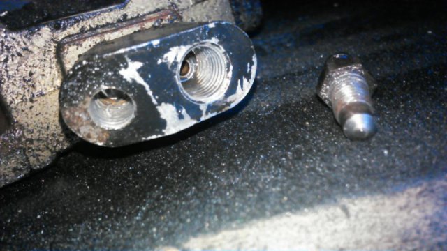

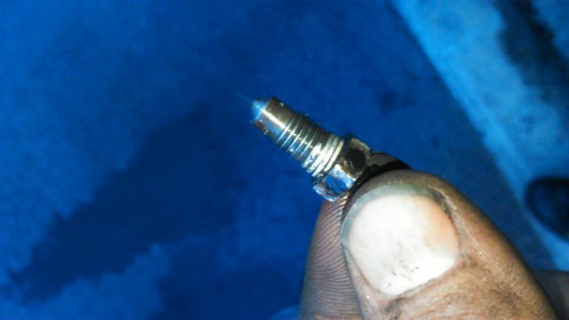

Things brake at the worst time but some times you look back after you have been pissed off and go wow I was lucky. I have put a few hundred miles on the car sense I finished up the suspension so it was time to go re torque all the bolts and re check everything. Found a few slightly loose bolts nothing to bad I also re tightened my gland nuts due to a slight CLUNK when I let off the gas. As we all know that means un hooking the brake lines and a re bleeding of the rears. Called a friend over to pump the pedal cracked the bleeder air comes out go to tighten it back down and the threads are striped out of the wheel cylinder. A few select words were said due to the fact I was planing on auto-crossing the car for the first time this Sunday. After I had cooled down I realized how lucky I was to have not got to the track this weekend with only 1 thread holding the bleeder in it could of popped out under hard breaking. So now I have a new wheel cylinder on the way and am starting to piece together a rear brake swap for after I get my S12+8's on the front  in a few weeks. I also found the cause of a exhaust on body noise turned out do be a busted rubber exhaust isolator, so I made a new one out of some Eaton syn-flex hyd hose its some really tough stuff rated up to 3000 psi and a strong braid in it so should last a good long time.
Till next time.

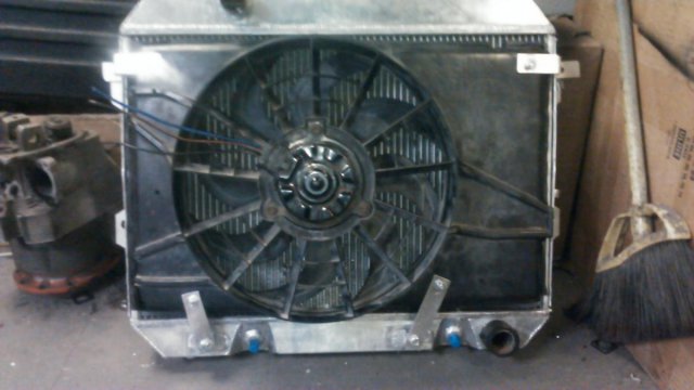

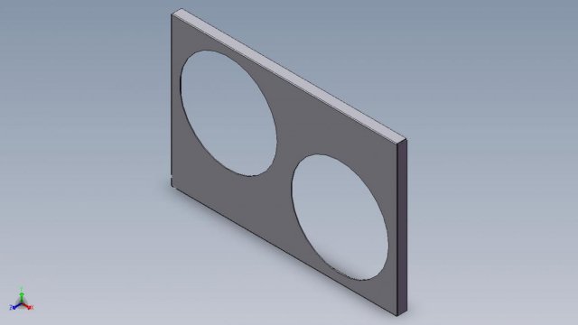

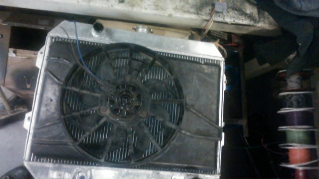

On another note I got the final design for my fan shroud done in solid works looks great if any one would like the fine just let me know the I/D is 16 1/4" x 24 3/4"  with 10 3/4" fan openings
post-19246-0-04565700-1403288231_thumb.jpg  by hwvigo & Alex M.
Edited by hwvigo

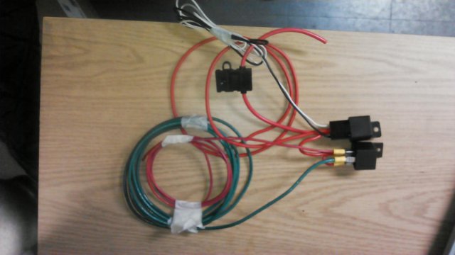

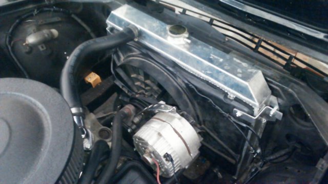

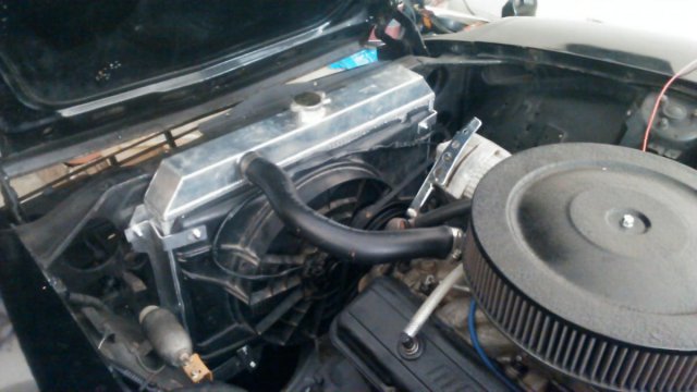

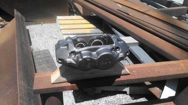

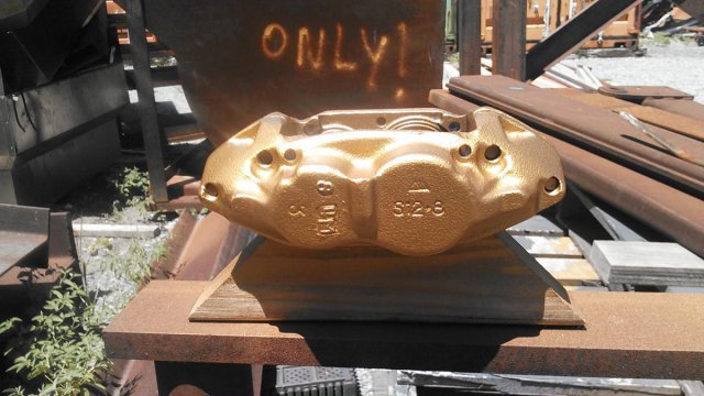

Well it has been a busy 3 weeks for me. I got married on June 28th and it was a killer wedding followed by a amazing honey moon in San Antonio TX. Got back on the 4th of July and ordered some parts as a birthday / wedding present to my self Toyota S12+8 calipers , SS lines for the Toyota calipers ,SS lines for the rear drums, Poterfield 4rs pads for the Toyota calipers, and also had a buddy grab me a Taurus fan for the pick and pull so I needed a fan wiring kit so I grabbed  one off eBay. Now the work starts, I made the choice to tackle the Taurus fan first for most this is a easy install. But in my case due to that  have a Johns cars v8z kit not so much the water pump was much in the way of the fan just slipping in so i trimmed .5" off the shroud still not enough. So I pulled the radiator so I could have a good look at how to get more clearance and the 280z radiator has wing that fold in over the core and add 1/4" of height so those got very carefully dremmiled off along with 1/4" more of the shroud and all overhanging bits of too. And it fit after all the cutting and trimming all it needed was some foam to seal and protect  and to make some mounting brackets and re test fit, so I bent up some mounting brackets and all worked out good. So then came the wiring I decided to go for a 195F thermo controlled low speed and a switched high speed the kit I bought off eBay needed some work and a extra relay and more wire to make it work how I wanted I used a 60 amp 5 pin for the high and a 40 amp 4 pin for low all power and ground wires 10 gauge with 16 gauge trigger wires and soldered  connections. I was able to hide the two relays in the stock relay cover under the hood and ran all the wires with the factory harness for a clean look. Filled the radiator with distilled water and water wetter and jacked up the front and burped the system and tested the new cooling setup and low and behold @ 195F  fan kicked on and with in 2 mins temp was below 180F. I could not be happier that fan moves some air sitting in my garage it never got hot! Much better than my old fans that did nothing to keep it cool. and That all I have had time to do other that paint the new calipers Brembo gold because we all know gold brake calipers make the car stop quicker,but all the parts are in and I get need some time.

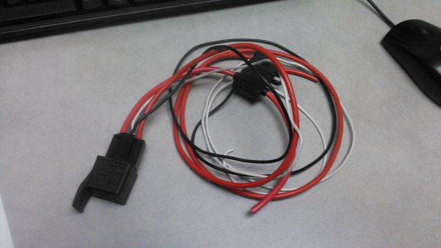

Curious as to how you have your harness mounted? Is this feasible/safe for street use? I will get a harness eventually and just would like some input.
It is very safe for street use, the relays are mounted in the stock box on the right side of the bay them the wires travel down through the stock wire holders down to the frame rail and follow the harness to the front. Keep in mind that i did weather proof the relays and connectors with rubber insulation tape and shrink wrap then silicone the pin exits on the relay and then wrapped the whole thing in E tape. I am good at over kill!

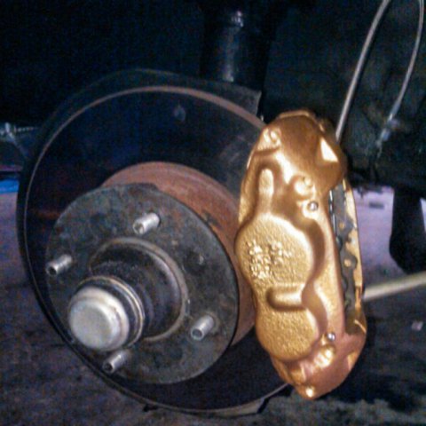

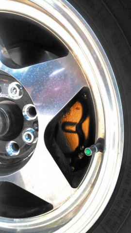

Ok I have got the Toyota brakes on with SS lines along with a new wheel cylinder for the driver rear drum with new SS lines and the whole system bleed out. Oh did I say that this is my second set of calipers I got the vented type the first time and like a ding-dong bleed them out and went to put my wheels on and the calipers hit my wheels. So I bought a set of non vented and problem solved. While the car was on the stands I decided to change out the old leaky trans tail shaft seal and re check ever bolt on the suspension of my car. All was good went and test drove brakes felt better than ever. I had done a good old tune up on it also re gapped plugs messed with the timing re tuned carburetor, and it runs much stronger now I have never had it running this good brakes the tires loose so much so I half to feather it off the line a bit and when you get on it and it shifts in to second it shoves the tail out to the right about a foot or so. So I decided it was time for its first trip up on the highway in 5 or so years all was going good till my temp started creeping up. Come to find out my lower radiator hose was sucking shut so popped a spring in it and the problem looks to be fixed. I decided to throw together a little OKZCC dinner last Saturday and had a very good turn out and meet a hybridz member josh280z, really nice guy gave me a ride in his ZX it’s a very nice car in the works. Then on Tuesday night I decided to go to a 99% American muscle show at the Tulsa Fudruckers. I got a few dirty looks as I was pulling in and them some very odd ones when my Z was loping through the parking lot finding a place to park. Had quite a few people come check out the car and many more due double takes as they walked by the engine bay, Had a very nice photographer come by and love my car and too some killer shots of it and I plan on getting a full shoot done when I get some work done.

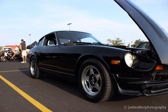

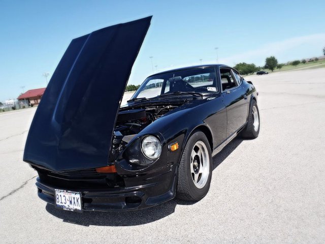

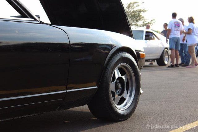

Also had a few cars shows two weeks ago and had a few good shots taken of it.
post-19246-0-91358800-1412346996_thumb.jpgpost-19246-0-78079600-1412347001_thumb.jpgpost-19246-0-12444800-1412347031_thumb.jpeg
