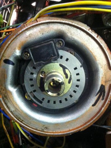

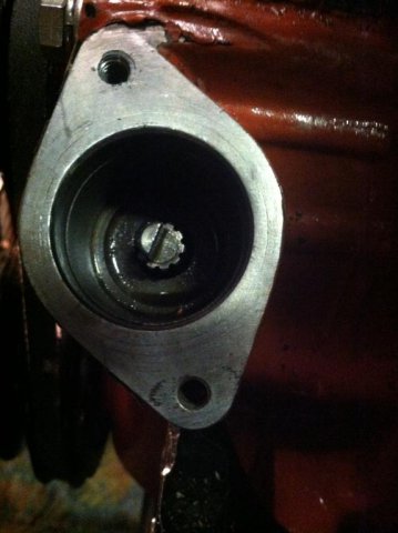

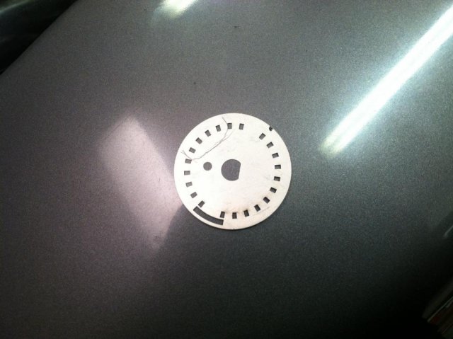

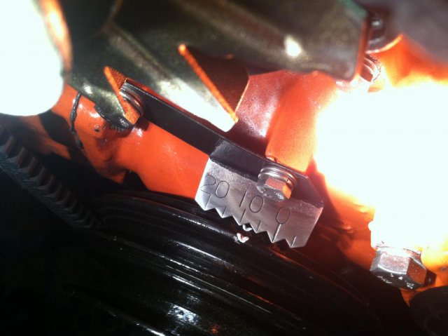

280~Master Posted March 4, 2014 Author Share Posted March 4, 2014 No I am not using one.. Should I? I can grab 3 or 4 from a JY if need be. What are some good ones to use? Here are some pictures I took tonight of the Dizzy and timing marks. Was wonder if you might be able to help me get the tooth #1 angle. Pretty sure the Drive spindle is off a tooth. Quote Link to comment Share on other sites More sharing options...
loy Posted March 4, 2014 Share Posted March 4, 2014 It appears to be around 250ish. Need to check with a timing light. Quote Link to comment Share on other sites More sharing options...
winstonusmc Posted March 5, 2014 Share Posted March 5, 2014 Looks to be close. Whats your #1 tooth angle with your timing spot on? Mine changed with this firmware upgrade. What firmware are you running? When I uploaded the new firmware, my #1 angle changed. I noticed in the previous posts that you dont know the #1 angle is. Make sure you set that with a timing light. Dont go off of someone elses tune, then it doesnt matter where yor distributer is set. Timing lights arent expensive and a must for a megasquirt owner. Quote Link to comment Share on other sites More sharing options...
