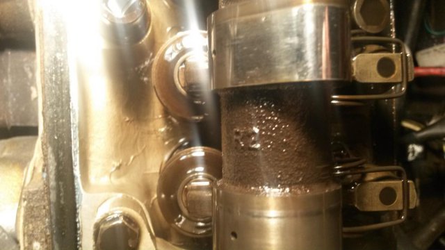

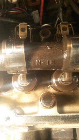

Milenko2121 Posted March 14, 2014 Share Posted March 14, 2014 (edited) It has N-15 and R2 stamped on it. There is no stamp at the rear of the cam. I'd really appreciate the help. Thanks, Mil Edited March 14, 2014 by Milenko2121 Quote Link to comment Share on other sites More sharing options...
NewZed Posted March 14, 2014 Share Posted March 14, 2014 The stamp on the back of the camshaft can be hard to see. Did you wipe the grunge off? Might take some carb cleaner or solvent to get it clean enough to see. The numbers you see are cast in to the blank shaft. Before it's ground. So they're meaningless. Quote Link to comment Share on other sites More sharing options...
Milenko2121 Posted March 14, 2014 Author Share Posted March 14, 2014 I wiped the back clean, and even tried to feel for a stamp with my fingernail, and nothing. it's perfectly smooth. Quote Link to comment Share on other sites More sharing options...
yhlz Posted March 19, 2014 Share Posted March 19, 2014 Is there reason for you to believe they are not factory cams? Quote Link to comment Share on other sites More sharing options...
Milenko2121 Posted March 19, 2014 Author Share Posted March 19, 2014 I got the engine from a junkyard, and swapped it in. It ran rough so I checked cam timing, and it was fine. I swapped my old stock P90 head on, and it runs perfect. The head with the assumed aftermarket cam looks to be in great condition. The fact it has no visible markings like normal stock cams is what has me confused. I'm going to sell the extra P90 head, but I wanted to be sure I have the right information for the buyer. Quote Link to comment Share on other sites More sharing options...
ctc Posted March 19, 2014 Share Posted March 19, 2014 Is there anything on the front of the cam under the timing gear? I have seen some aftermarket cams stamped there. Quote Link to comment Share on other sites More sharing options...
Xnke Posted March 20, 2014 Share Posted March 20, 2014 Possibly a rebuilt head with an aftermarket cam core...similar, but not the same as a "CWC" core. Does it say E30 JAPAN anywhere on it? If not, then it is not likely a factory cam core, and will not have a cam stamp corrisponding to the factory cam grinds. Quote Link to comment Share on other sites More sharing options...
