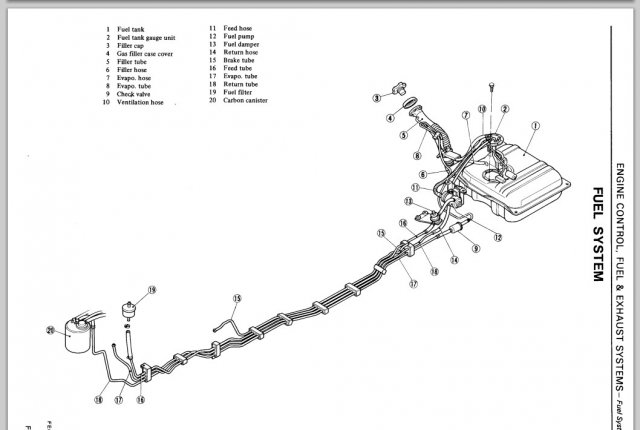

NewZed Posted March 16, 2014 Share Posted March 16, 2014 The factory system has a vented fuel tank. Sounds like yours are clogged or someone blocked them off. Maybe to get rid of "emissions crap". Check your vents. There's a nice diagram out there somewhere of all of the various hoses and valves. Quote Link to comment Share on other sites More sharing options...
johnc Posted March 17, 2014 Share Posted March 17, 2014 You car originally vented the fuel tank to a charcoal canister. Most likely an ignorant previous owner removed "all the emission crap" as mentioned above. A pressurized fuel tank is dangerous. Fix the venting system on your tank. Quote Link to comment Share on other sites More sharing options...
Tony D Posted March 17, 2014 Share Posted March 17, 2014 I will be the third voice of reason here--the charcoal cannister on the inner side of the front right wing has a cap on it, that cap regulated how much pressure built up in the tank due to expansion. After a given point, it released it to the container, which then flowed the releasing gas through the activated charcoal bed and to atmosphere. This adsorbed the fuel vapors. The important thing here is this: If the vent was plugged, there is little chance the fuel expansion due to heat would overcome the fuel sucked out of the tank in that time and cause a net pressure rise. Generally if you plug the vent, at highway speeds you will see in about two hours problems with fuel pressure being low...and a VACUUM in the tank, as opposed to pressure. In short drives, I can see this being an issue. In long term drives, especially at high speeds it should draw down the tank if it's indeed plugged. You need to quantify the pressure there---it should be inches of water, and the volume can be quite great. A compound mm H2O gauge (reads pressure and vacuum) on the Evaporative Emissions Line from the cannister to your tank should read the working pressure of the tank. Sitting idling it will rise to a set point, and then relieve to the cannister. If that valve is sticking it will cause that pressure. It's a separate flapper that breaks the vacuum to your tank...and like I said, I can't explain pressure in the tank after 100 miles of high speed driving, every one I've been in with a plugged line pulled heavy vacuum in about 2 hours-so much so it stranded the guy on the roadside. That gauge may be your only hope of diagnosis. What you think is 'excessive' may indeed be normal. If you have 120mm H2O with a full tank it will give a short "psssh"... but that same pressure at an almost empty tank will blow for much longer. Chances are you have a sticking relief valve but not a plugged / capped line. Let us know what you find! Quote Link to comment Share on other sites More sharing options...

aarang Posted March 18, 2014 Share Posted March 18, 2014 Crawl underneath the rear of the car. The fuel sender/supply assy sits on the top of the tank. If you look on the front of the tank you should see three lines coming from it. One line is the inlet to the pump. One is the return to the tank. The smaller line of the three is the vent that should have gone to the charcoal canister (this is on a US market car at least, so your car may be different). Follow that line towards the front of the car and see where it has been capped or blocked. Chances are the previous owner didn't cap it by the tank, but in the engine bay somewhere. Quote Link to comment Share on other sites More sharing options...
NewZed Posted March 18, 2014 Share Posted March 18, 2014 These might help. "fe" is for Fuel and Exhaust. The attached picture is from the 1982 version. http://www.nicoclub.com/datsun-service-manuals Quote Link to comment Share on other sites More sharing options...
