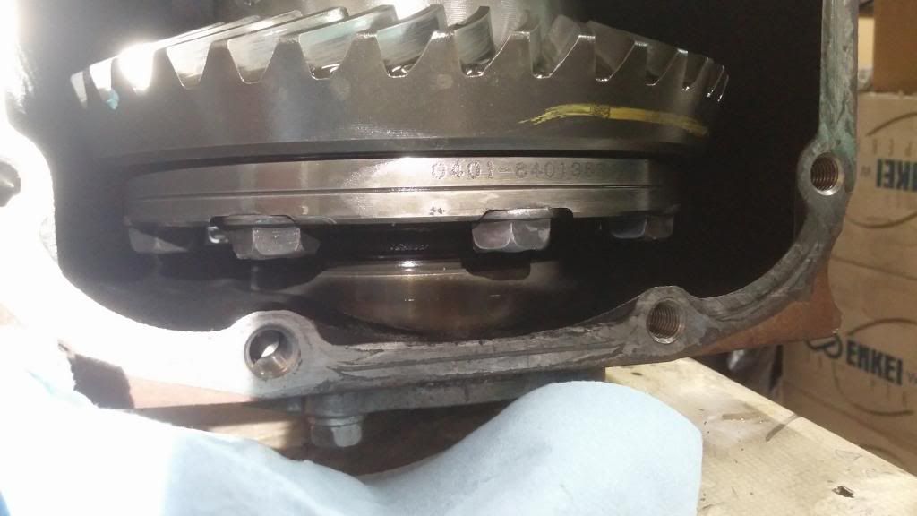

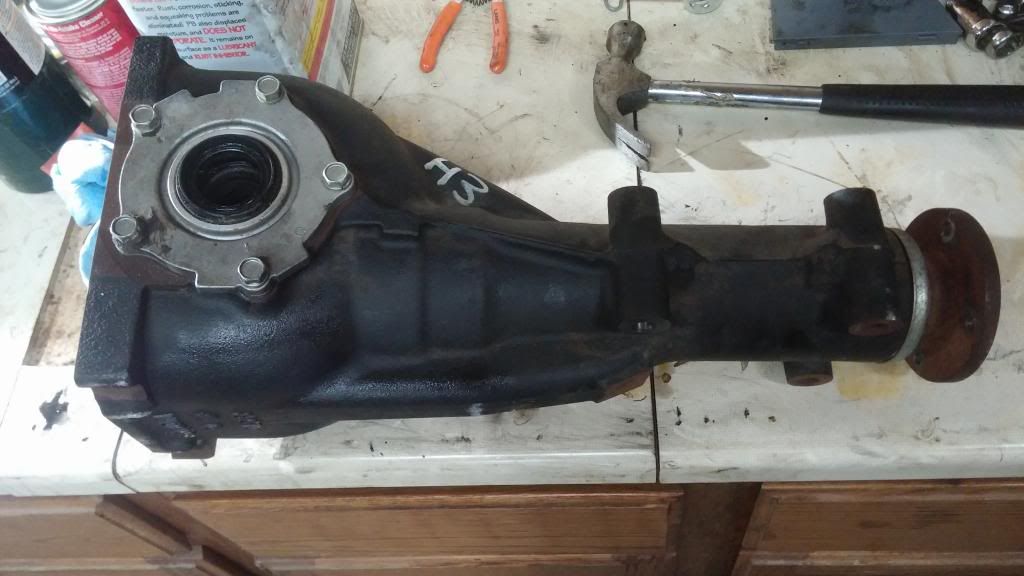

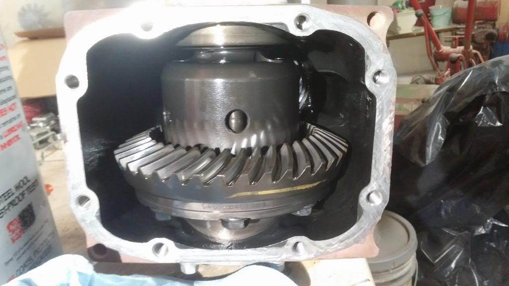

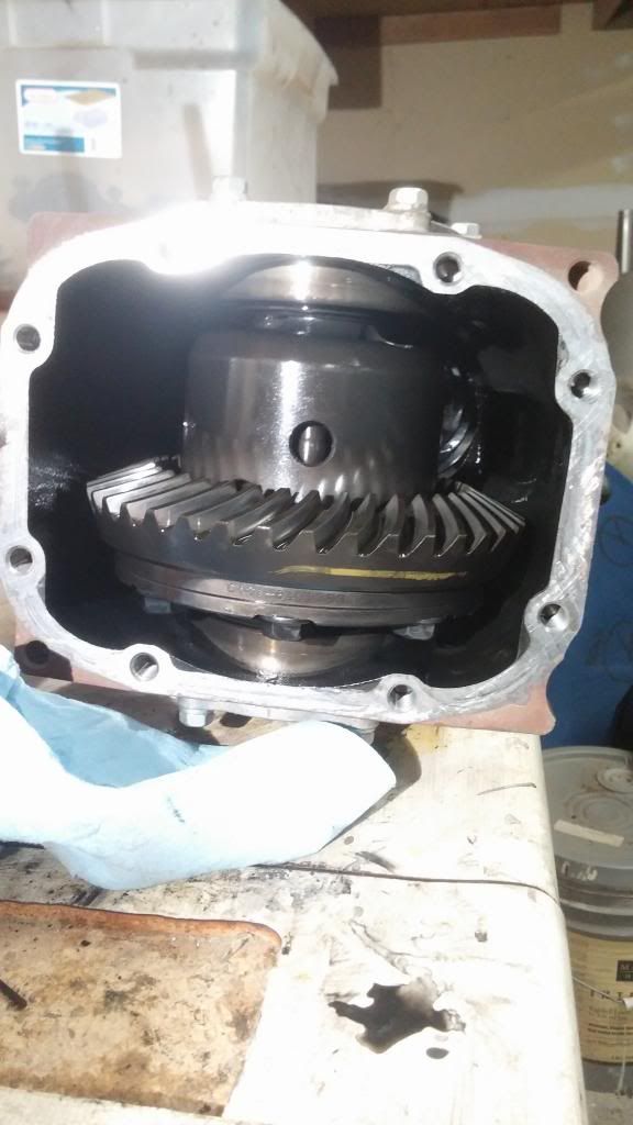

Black Pearl Posted March 21, 2014 Share Posted March 21, 2014 Hello all, I'm doing a STi limited slip differential swap into my 1978 280z, and I was wondering if someone could help me identify my STi differential. I was told it was out of a 2008 STi which would make it a 3.54 gear ratio with a Torsen limited slip unit, correct? I cannot find the gear ratio stamp on the ring gear where others have shown it located. Also, does it look like it has the Torsen LSD unit? Any help is appreciated! Thanks, Keaton Quote Link to comment Share on other sites More sharing options...
Mike C Posted March 25, 2014 Share Posted March 25, 2014 It is a limited slip of some sort with the 2 piece case based on the seam on the ring gear flange. It looksl like it has helical gears like a Torsen to me. I've never seen a ring gear that didn't have anything stamped on it, so rotate it around and look for markings where that yellow paint mark is now. Otherwise, with the the cover off, count the teeth on the pinion gear and count the teeth on the ring gear. Divide the pinion into the ring and that's your gear ratio. Quote Link to comment Share on other sites More sharing options...
mrcheeze36 Posted March 26, 2014 Share Posted March 26, 2014 Torsen but an 07' is 3.54 and an 08' is a 3.9: http://forums.hybridz.org/topic/38251-complete-differential-list-need-help/?p=681962 Quote Link to comment Share on other sites More sharing options...
Black Pearl Posted April 1, 2014 Author Share Posted April 1, 2014 I appreciate all the help. I counted the teeth and came up with the 3.545 ratio. I could not locate a stamp anywhere on the ring gear.. Thanks! Keaton Quote Link to comment Share on other sites More sharing options...
mrcheeze36 Posted April 2, 2014 Share Posted April 2, 2014 If a 3.54 with a Torsen, then it's off of an 07'. Quote Link to comment Share on other sites More sharing options...
