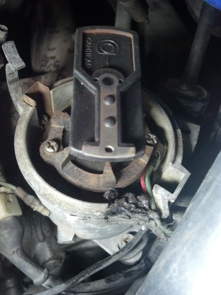

konradlip Posted April 4, 2014 Author Share Posted April 4, 2014 i checked my wiring and found out that there are two wires coming from the dizzy. one is red the other is green. Green is connected to ms1 v3 pin 7(ground i think) and the red one is connected to pin 24. it seems like the dizzy is already welded up but when i rev it i can hear some kind of mechanical noise Quote Link to comment Share on other sites More sharing options...
konradlip Posted April 4, 2014 Author Share Posted April 4, 2014 Quote Link to comment Share on other sites More sharing options...
Metro Posted April 4, 2014 Share Posted April 4, 2014 (edited) Dude, you need to spend a lot of time reading about MS and other ECUs. The fact that you can "rev it up" means it's connected and working in harmony with MS. There's no reason to change your distributor. I can see fresh weld beads under the reluctor, so it looks like the PO did the correct thing by welding the arms of the mechanical advance. You change your timing by connecting to MS with a laptop and a serial cable. Install Tunerstudio and check your ECU's version, settings, and then once you know what you're working with and have a basic understanding of MS, come back here and we'll help you out with any questions. http://www.tunerstudio.com/ http://www.msextra.com/doc/index.html Edited April 4, 2014 by Metro Quote Link to comment Share on other sites More sharing options...

BLOZ UP Posted April 4, 2014 Share Posted April 4, 2014 If your distributor isn't locked (looks like it but I would take it apart further to verify), then you have additive timing from both MegaSquirt and the mechanical advance. That's bad. It should just be megasquirt. Quote Link to comment Share on other sites More sharing options...
konradlip Posted April 4, 2014 Author Share Posted April 4, 2014 is there any write up on how it should be locked. Also should the negative(green) wire be connected to MS pin 1 instead of 7 like it is. My MS seems to be set up for VR sensor Quote Link to comment Share on other sites More sharing options...

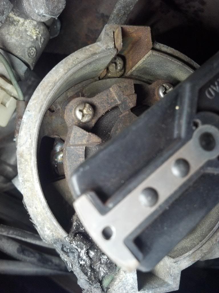

Six_Shooter Posted April 9, 2014 Share Posted April 9, 2014 It looks like it is locked to me, the weld in the third picture would be pointless otherwise. You can easily check that it's locked out by simply grabbing the rotor and attempting to twist the rotor one way and the other. If the rotor moves a significant amount and you can actually see the mechanicals moving in the dizzy, then it's not locked. If the mechanicals do not move, then it is locked. Back when I was running a dizzy on my car, I found the stock (replacement) rotors had significant play in them. I mention the play just to forewarn you about it and not think it's the mechanical advance not locked out. Don't take offense to me mentioning small things like this, I don't know your skill level when it comes to stuff like this, so I assume people know (next to) nothing about it when I try to explain some things. You don't need a turbo dizzy. The reason there is a "turbo dizzy" is because Nissan changed the control of the engine when they went to the turbo version. They decided to add or change the way the ECM/ICM was triggered. Since your MS is capable of using pretty much any ignition input signal as an RPM reference, the NA dizzy is fine. I ran my turbo L28 with an NA dizzy (locked) for the first few months it was turbocharged, then switched to DIS. I actually couldn't use a turbo dizzy due to the ECM I am using anyway. As far as adjusting timing, you do that through a combination of mechanical manipulation and through the SA tables of the MS. You need to set "base timing" using the dizzy itself. Depending on the application this is usually between 0 and 10 degrees BTDC (Before Top Dead Center). You then adjust overall timing through the SA tables in the MS. I can't help you on setting the base timing, I use a different ECM than an MS, that allows for easy adjustment of base timing by disconnecting one wire temporarily (similar in concept to disconnecting the vacuum advance of a carb set-up. You will have to do some research there, I'm sure the MegaManual and MS forums will be of help there. So in short, don't be worried that it's an N/A dizzy, just be sure that it is locked out, and that base timing is set correctly, along with MS doing what it should be doing. If you don't have a timing light, get one, learn how to use it, correctly set timing can solve a multitude of problems. I'm only mentioning this last part as an FYI, but a non-locked out N/A dizzy could be used in conjunction with EFI, provided that the SA tables are set correctly in the ECM to account for such a method. This is a sort of advanced topic, and has no real benefit in doing so, but I mention it, because it could be done and with such a universal ECM as the MS, it could be set up a multitude of ways, along with the actual mechanicals that it is attached to. Quote Link to comment Share on other sites More sharing options...
