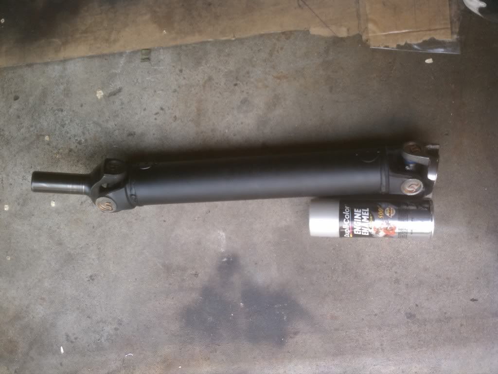

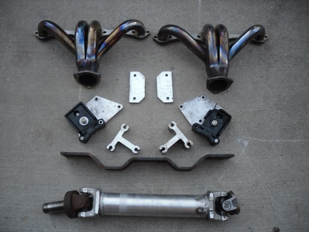

JMortensen Posted April 23, 2014 Author Share Posted April 23, 2014 (edited) One cool thing about the internet is you can put pictures on it... Edited April 23, 2014 by JMortensen Quote Link to comment Share on other sites More sharing options...
SUNNY Z Posted April 23, 2014 Share Posted April 23, 2014 I had a camaro shaft shortened for my SBC setup. Had the same local shop build one for the original LSx swap The Driveshaft Shop built my current shaft, and its currently getting shortened due to the changes this winter! Woot! Shafts! If you have a local builder you trust, and is capable of properly balancing it, I say go local. Thats just me though! I've had great luck with the DSS as well. Bigger company, more business, and more turnaround, but they have absolutely hooked me up on everything. Quote Link to comment Share on other sites More sharing options...

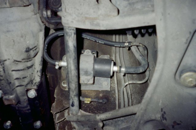

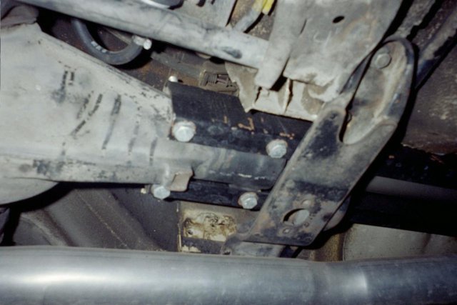

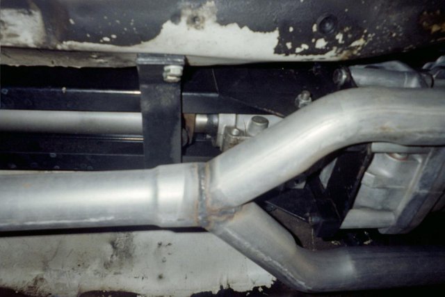

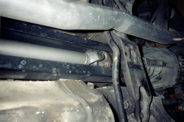

Phantom Posted April 23, 2014 Share Posted April 23, 2014 (edited) Jon, Old photos and not real clear but the best I have at this point. These were taken back in 2004 when I still had a Y pipe into a single 2.5" exhaust. The 'Y' has been replaced with an 'X' and dual 2.5" exhausts to the back to a single Magnaflow muffler. You can sort of see the frame that bolts to the tailshaft of the trans, the dual channels running from the trans to the diff and how the channels bolt to the diff. The cross brace you see in the third photo is not a trans mount - it is a driveshaft loop. Edited April 23, 2014 by Phantom Quote Link to comment Share on other sites More sharing options...
JMortensen Posted April 23, 2014 Author Share Posted April 23, 2014 That definitely gets the point across, thanks for posting. I might have a look at that down the line. Want to see where my weight is first. Looks like a lot of metal there, even if it were aluminum it would be a chunk of weight. Quote Link to comment Share on other sites More sharing options...
Phantom Posted April 23, 2014 Share Posted April 23, 2014 Couple more pieces of info. When I did the conversion the car only gained a total of 30 lbs and it was all on the rear axle so it can't be too bad. Obviously the weight is low, between the axles and near the CL of the car, Torque/twist is transferred straight through to the diff rather than the body. Quote Link to comment Share on other sites More sharing options...
