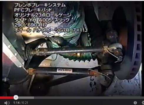

socorob Posted December 24, 2015 Share Posted December 24, 2015 https://youtu.be/eWXiRxxiqNM This is an old video and at 1:13 you can see they used heims for the outer tie rods, the control arm, and tc rod. 3 rods cover everything. looks like they use a rod end instead of a balljoint too. Quote Link to comment Share on other sites More sharing options...
socorob Posted December 24, 2015 Share Posted December 24, 2015 So you wont have to watch the video. Quote Link to comment Share on other sites More sharing options...
