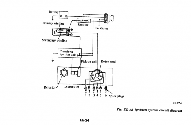

Next on my list will be checking verifying timing marks, valve timing, etc. This vehicle does have a distributor out of an 81ZX with the matchbox ign unit. Also - What is the spark plug firing order? Mine is setup as 1-4-2-6-3-5.
