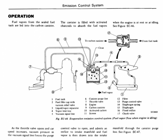

Ozzie831 Posted July 27, 2014 Author Share Posted July 27, 2014 (edited) Sooooooo I went to pick and pull and grabbed a charcoal canister from a geo and hooked it up. Low and behold the car ran pretty good. I ran the car for an hour and there was very little to no change in fuel pressure.... And this test had about a quarter tank of gas or a little bit less Edited July 27, 2014 by Ozzie831 Quote Link to comment Share on other sites More sharing options...

NewZed Posted July 27, 2014 Share Posted July 27, 2014 Anytime I pull the gas cap on my 76' even right after running I will have a big pressure release which sounds right. Why does this "sound right"? That pressure should be released through the charcoal canister. The big pressure release indicates that something is screwed up. My stock 1976 280Z with the complete venting system (lets pressure out), including the stock charcoal canister, and vented tank cap (lets air in), and aftermarket Airtex E8312 fuel pump is very quiet. A couple of pieces of rubber between the pump body and the mount, and I can only hear it in a quiet garage with the pump only running, engine off. Nobody should have to live with a noisy fuel pump. Quote Link to comment Share on other sites More sharing options...
DuoWing Posted July 28, 2014 Share Posted July 28, 2014 (edited) Hmm I guess I read wrong, for some reason I was under the impression that if you were seeing pressure in the tank it was correct. My old 280zx always had that pressure release whenever I'd go pull the cap off at the gas station. I also could be misunderstanding, but it sounded like with what Tony wrote above that there should be the pressure on the tank to help with the pump and cavitation, but maybe with just an open vent line where it should have been hooked to the canister I'm possibly issues? Maybe I need to see if I still have the charcoal canister and throw that in and try that? The canister has never been hooked up since I did my swap. My pump only seems to become loud after a longer drive. If it's a nice cool day I may never have the pump become louder than being a little audible in an enclosed garage. I actually need to check and see if I'm still dropping fuel pressure once the pump becomes loud. After mounting the regulator directly to the rail I'm experiencing what a few others have mentioned. The fuel pressure reading on my gauge seems to sit very steady vs. the rapid vibration/fluctuation I used to have. I don't know if this will make any difference to the fuel flow and recirculation in the system or not. Edited July 28, 2014 by DuoWing Quote Link to comment Share on other sites More sharing options...
