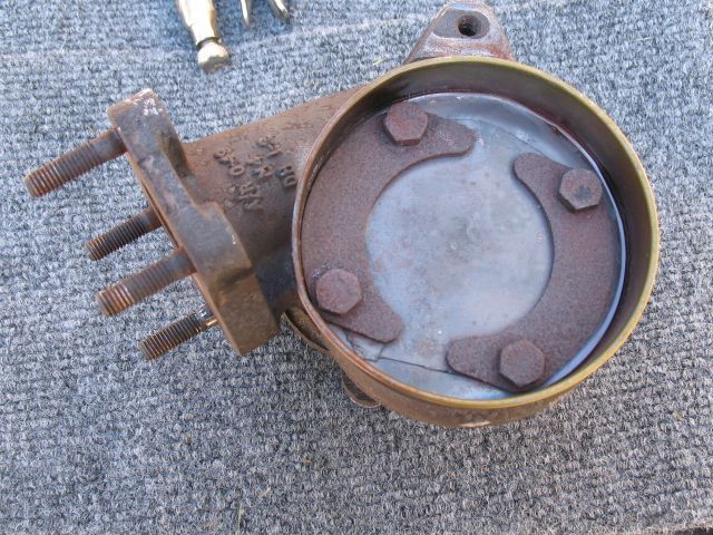

Six_Shooter Posted July 27, 2014 Share Posted July 27, 2014 (edited) Or you could make a block off plate that installs into the turbine housing, where the center section would have. I've seen that done a couple times, easier than all of the work to keep the center section compressor for looks. OR Edited July 27, 2014 by Six_Shooter Quote Link to comment Share on other sites More sharing options...
