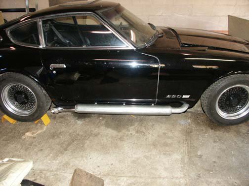

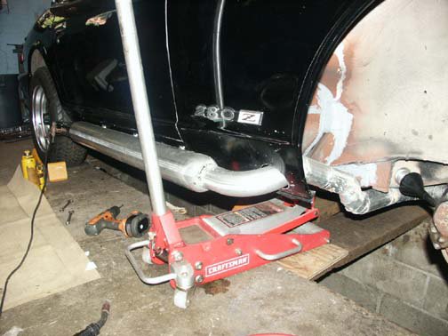

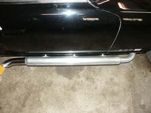

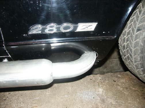

gvincent Posted March 18, 2015 Share Posted March 18, 2015 (edited) Yeah there were quite a few variations from mild to really wild, i say yours is closer to the later. my side pipe exhaust I made is straight from the headers 2.5" pipe to a 2.5" 40" x4" Jones glass pack to a 3" tip chrome exhaust. I welded studs to the glass packs and used hi temp isolation sandwich bushings and drilled holes in the rocker panel the size of the isolation inside ring aligned the holes line up with the existing factory holes on the inside and bolted the glass pack and sandwich mounts together from the inside. All the off the shelf side pipes are way too restrictive this way I was able to have 2.5ID all the way. Here is another Scarab Brochure Edited March 18, 2015 by gvincent Quote Link to comment Share on other sites More sharing options...

gvincent Posted March 19, 2015 Share Posted March 19, 2015 (edited) That exhaust is so cool!!! Thanks for the details on how you did it. If you have a video clip of that exhaust, post it up. I along with others on this forum would love to hear that thing! The Scarab brochures are also really cool to see! here is a couple from 4 or 5 years ago some VID_20110825_174454.mov 280Z black Beast startup.mov Those are not my voices the videos LOL building the exhaust Edited March 19, 2015 by gvincent Quote Link to comment Share on other sites More sharing options...
