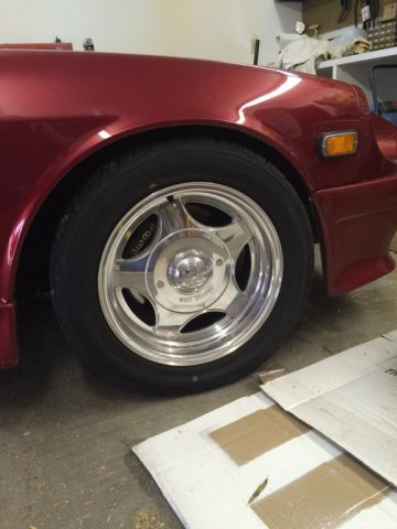

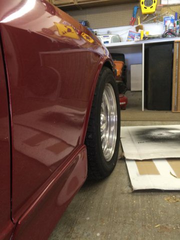

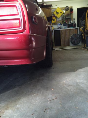

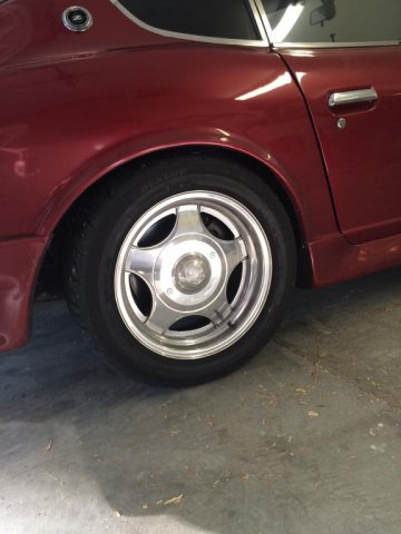

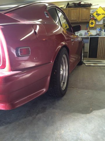

Phantom Posted September 26, 2014 Share Posted September 26, 2014 (edited) Photos of 225/50-16 Dunlop Direzzas on 16x7 wheels with 0 offset on a 1977 280Z. 0 Camber. Edited September 26, 2014 by Phantom Quote Link to comment Share on other sites More sharing options...
EastTnZ Posted September 26, 2014 Share Posted September 26, 2014 Did you roll your rear fenders any? I'm rubbing my rear tires (225/50/16) in corners ever so slightly and am thinking that's all it needs. I only had my tokico's on 3 though so I could've turned them up a little bit to 5 and possibly avoided that. Quote Link to comment Share on other sites More sharing options...
socorob Posted September 27, 2014 Share Posted September 27, 2014 I have some hand me down g35 wheels with bald 245/45-17 on the car now. On the rear inside I don't have much clearance to my coilovers. On the outside I can fit a finger in between the tire and lip. So a custom wider wheel with the width added to the outside and a 255 would fit with no rolling. Someone squeezed a 265 on back of theirs with custom wheels and rolling the fender. i have-1.2 camber on the back. Quote Link to comment Share on other sites More sharing options...
RebekahsZ Posted September 27, 2014 Share Posted September 27, 2014 As opposed to rolling, you may get the clearance you need by cutting off some of the extra flange before you get to the actual spot welds that join the inner and outer fender skins. I just carefully ground mine down with an angle grinder. Quote Link to comment Share on other sites More sharing options...
Phantom Posted September 27, 2014 Share Posted September 27, 2014 I got a bit creative and used a baseball bat on my rear fenders. Wrapped a towel around the handle, inserted the handle end up on top of my rear tire and then, using the ire as the pivot point, pullled up on the fat end of the bat. I worked my way carefully across the top of the fender opening moving about an inch at a time. It rolled the inner lip up a bit and also stretched the fender out minutely. No paint damage which was the goal because the car had fresh paint at the time. I still get a little contact on really hard bumps on the passenger side if I have a passenger in the car. If it's just me, no issues. This was done when I had the stock suspension. If I'd had coil overs at the time I'd have gone with an 8" wide wheel with about a +10 offset. Quote Link to comment Share on other sites More sharing options...
