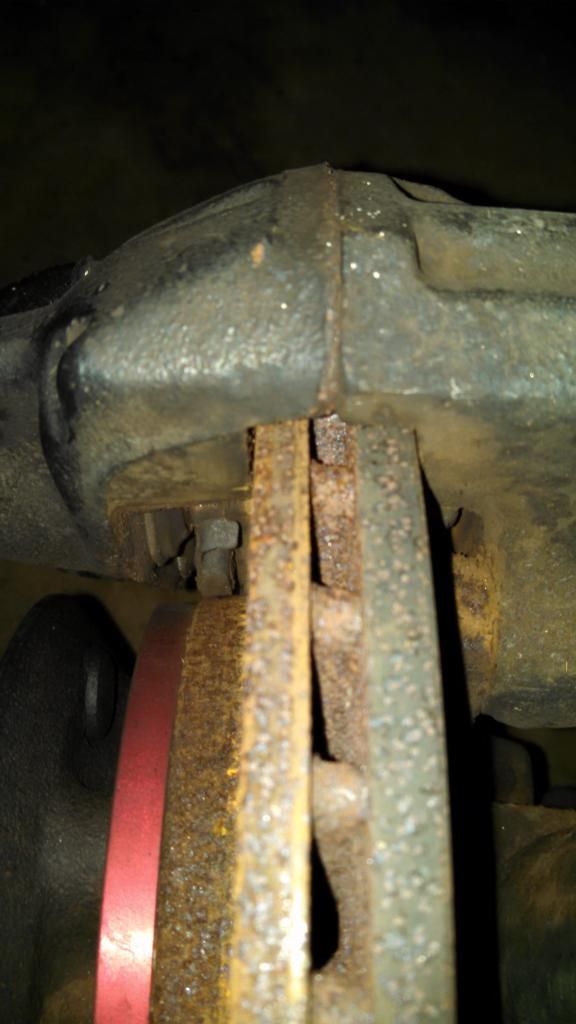

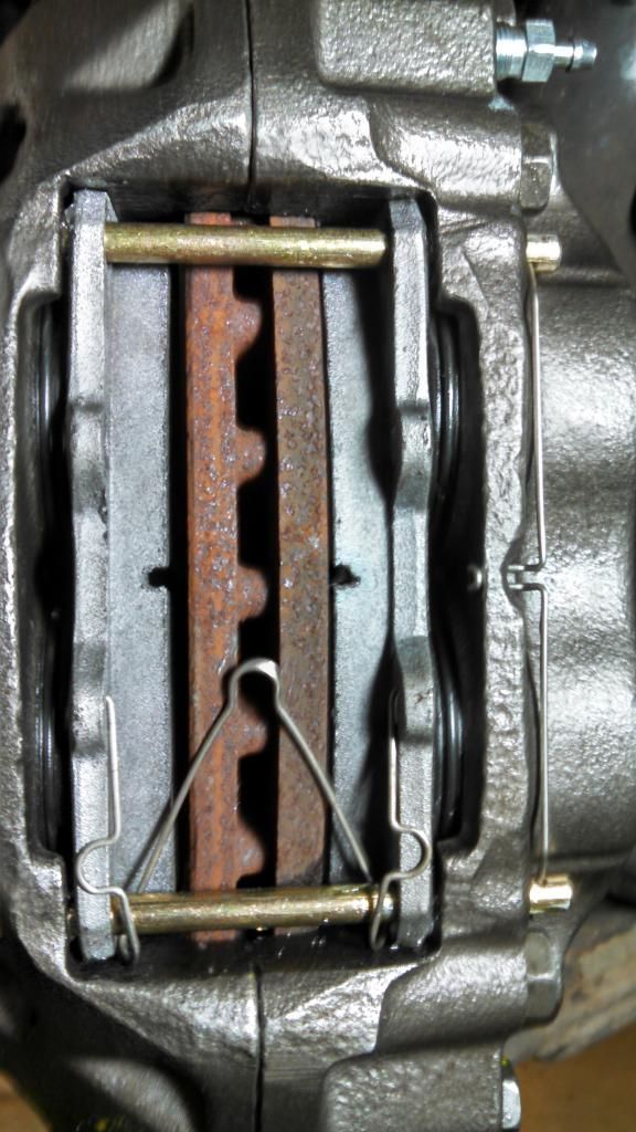

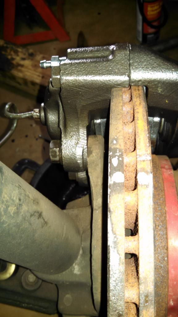

wigenOut-S30 Posted September 29, 2014 Share Posted September 29, 2014 Hello, I did the S12W caliper and brake upgrade about 6 years ago.. Well my Drivers side caliper started sticking.. I tried taking the pins out and using antiseze but it did not solve the issue. I went to autozone and bought a 88 Toyota 4 runner S12W caliper (PN C8465) and new pads. I bolted it on and here is what I found.. The rotor is actually making contact with the caliper. Did I get the wrong S12W caliper or is it a defect in the casting? You can see in the pic that the new caliper is pushed out and has way more spacing on the outside and touching on the inside. The old S12W caliper is evenly spaced at 1mm on each side. New caliper Old S12W caliper Quote Link to comment Share on other sites More sharing options...

johnc Posted September 29, 2014 Share Posted September 29, 2014 You don't need to take it back. Just measure the offset and add hardened steel shims between the caliper and the mounting ears. Quote Link to comment Share on other sites More sharing options...
