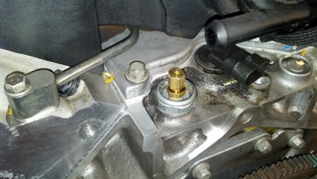

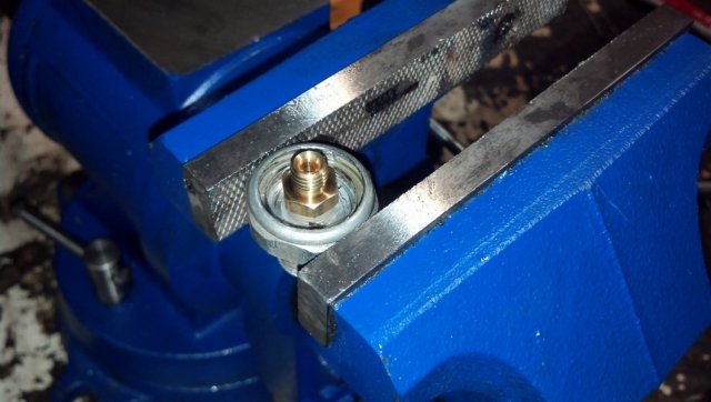

240z72 Posted October 19, 2014 Share Posted October 19, 2014 (edited) A lil tip for running an oil pressure sending unit up top in the stock location (drivers side, just behind the intake manifold). IF you have the stock electric sender, literally break or cut the plastic part off the sender and clean out the metal nut/thread part. Tap it with 1/8th inch NPT or whatever your sender is and bam. No need for adaptors. Plus its away from the headers. I personally dont like the JCI adaptor. Also you can use a stock datsun sending unit for your stock guage. Edited October 19, 2014 by 240z72 Quote Link to comment Share on other sites More sharing options...
SUNNY Z Posted October 19, 2014 Share Posted October 19, 2014 A lil tip for running an oil pressure sending unit up top in the stock location (drivers side, just behind the intake manifold). IF you have the stock electric sender, literally break or cut the plastic part off the sender and clean out the metal nut/thread part. Tap it with 1/8th inch NPT or whatever your sender is and bam. No need for adaptors. Plus its away from the headers. I personally dont like the JCI adaptor. Also you can use a stock datsun sending unit for your stock guage. post-27908-063292100 1348914213.jpg post-27908-070891900 1348914244.jpg Yep. I've done about a half dozen this way. Works well. Only thing that sucks is the autometer mechanical sender is huge, so you might have to run a 45* elbow on it. Quote Link to comment Share on other sites More sharing options...
socorob Posted October 20, 2014 Share Posted October 20, 2014 I did the tap with a 45 elbow from the hardware store with datsun sending unit Works fine so far. Quote Link to comment Share on other sites More sharing options...
