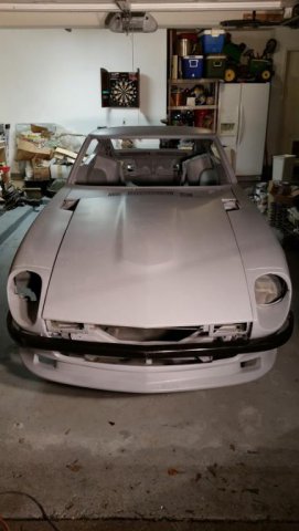

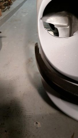

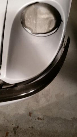

quickdraw Posted November 18, 2014 Author Share Posted November 18, 2014 Looking for a little feedback. Turns out it's a MSA fiberglass bumper. Pics below. Again asked by ZCCJDM to "try and bolt up". Those that have this bumper...did you have similar fitment issues? They've appropriately offered a return but curious if I am going to get the same thing elsewhere? Quote Link to comment Share on other sites More sharing options...

RPMS Posted November 19, 2014 Share Posted November 19, 2014 Looking for a little feedback. Turns out it's a MSA fiberglass bumper. Pics below. Again asked by ZCCJDM to "try and bolt up". Those that have this bumper...did you have similar fitment issues? They've appropriately offered a return but curious if I am going to get the same thing elsewhere? What you're showing looks correct to me. The stock bumpers I've worked with in the past weren't designed to bolt directly to the body. There's a rubber stand-off that goes between the bumper and the body. If MSA is making a replacement-style bumper made out of fiberglass, then what you've got looks correct. Quote Link to comment Share on other sites More sharing options...

quickdraw Posted November 19, 2014 Author Share Posted November 19, 2014 My bumper is off, PM me measurement across from end to end and I'll compare with my OEM piece. Much appreciated. I'll do it when I get home tonight What you're showing looks correct to me. The stock bumpers I've worked with in the past weren't designed to bolt directly to the body. There's a rubber stand-off that goes between the bumper and the body. If MSA is making a replacement-style bumper made out of fiberglass, then what you've got looks correct. Hmmm...that's interesting. This is a 280z conversion to 240z bumpers so I didn't have the reference. What's interesting is that I've seen quite a few z's with the fitment that appears to attach directly to the body. Still a little bit of space but by no means what I have. Any ideas on how they're doing that? Hacking up the option I have, perhaps? Quote Link to comment Share on other sites More sharing options...
