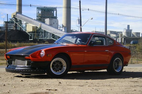

proxlamus Posted November 21, 2014 Share Posted November 21, 2014 (edited) Well, I never put one of these together.. some of you may know me by "proxlamus©" but after the last major board update, it lost all my information so I had to create a new account. I bought the 1978 Datsun 280z when I was 16 years old. I bought some polished iron cross wheels and she looked slick! Then my ex girlfriend saw me driving in the snow and thought there was another girl in the car.. so she crashed into me and wrecked my baby. Soo I rebuilt her and not long after, I began to swap in a L28ET, which my parents would not let me use the garage, so I did it in the street. Edited March 20, 2016 by proxlamus Quote Link to comment Share on other sites More sharing options...

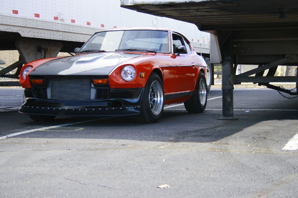

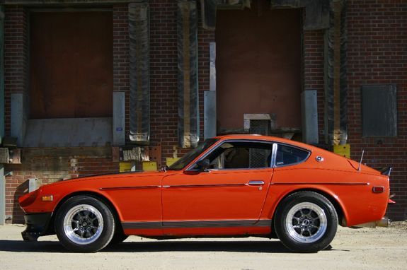

proxlamus Posted November 21, 2014 Author Share Posted November 21, 2014 (edited) Part 2.. Over the years I gathered parts and spent time on the car.. this was the last photo shoot I had with the car before she went down. [/url] I had a huge build planned. L28 with 9mm rods, 88mm Ross pistons (3.0L), 8.5:1 CR, Schneider Stage II cam, Holset HY35W, Megasquirt, Suzuki GSXR ITB's and home made intake plenum, Z32 transmission, Fidanza aluminum flywheel, ACT stage II clutch and pressure plate, coil-overs, vented 4x4 front brakes, 240sx rear brakes, Corbeau FX1 Pro seat Some of you may remember by build thread for my ITB's... [/url] Edited November 21, 2014 by proxlamus Quote Link to comment Share on other sites More sharing options...

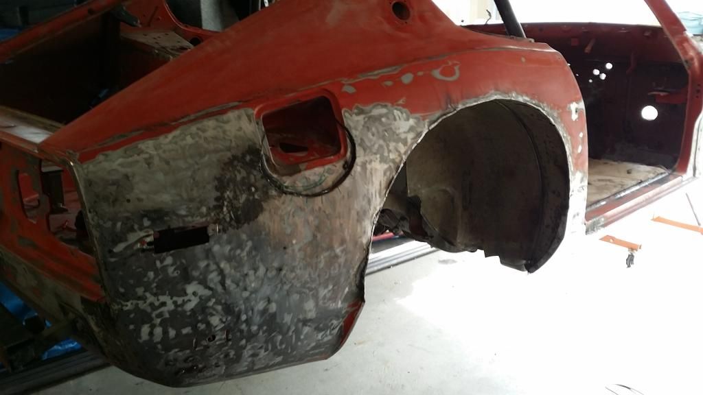

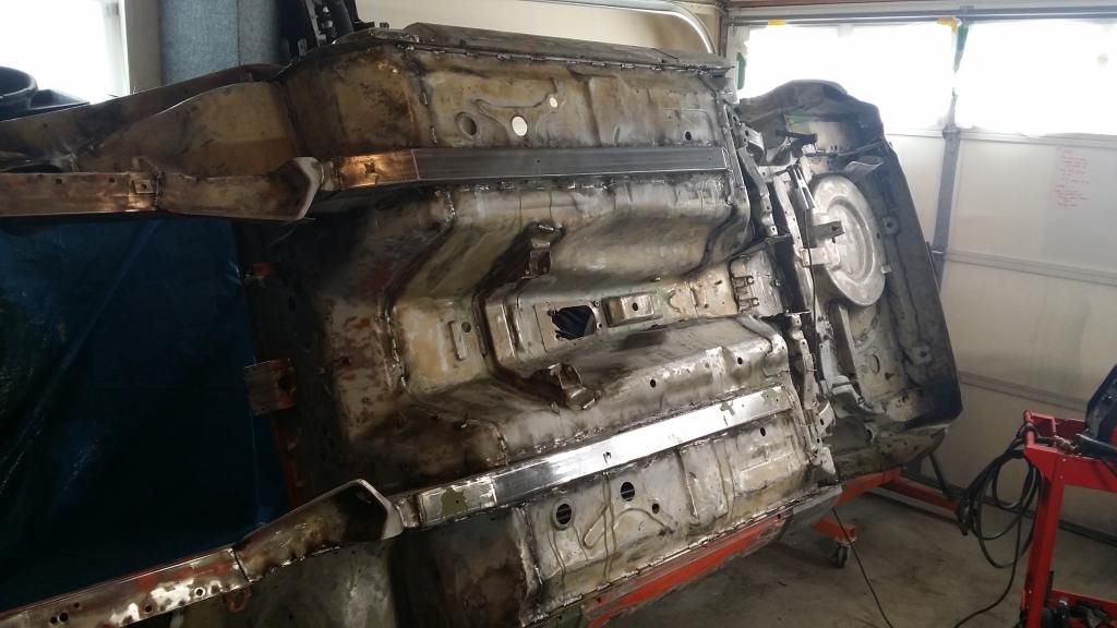

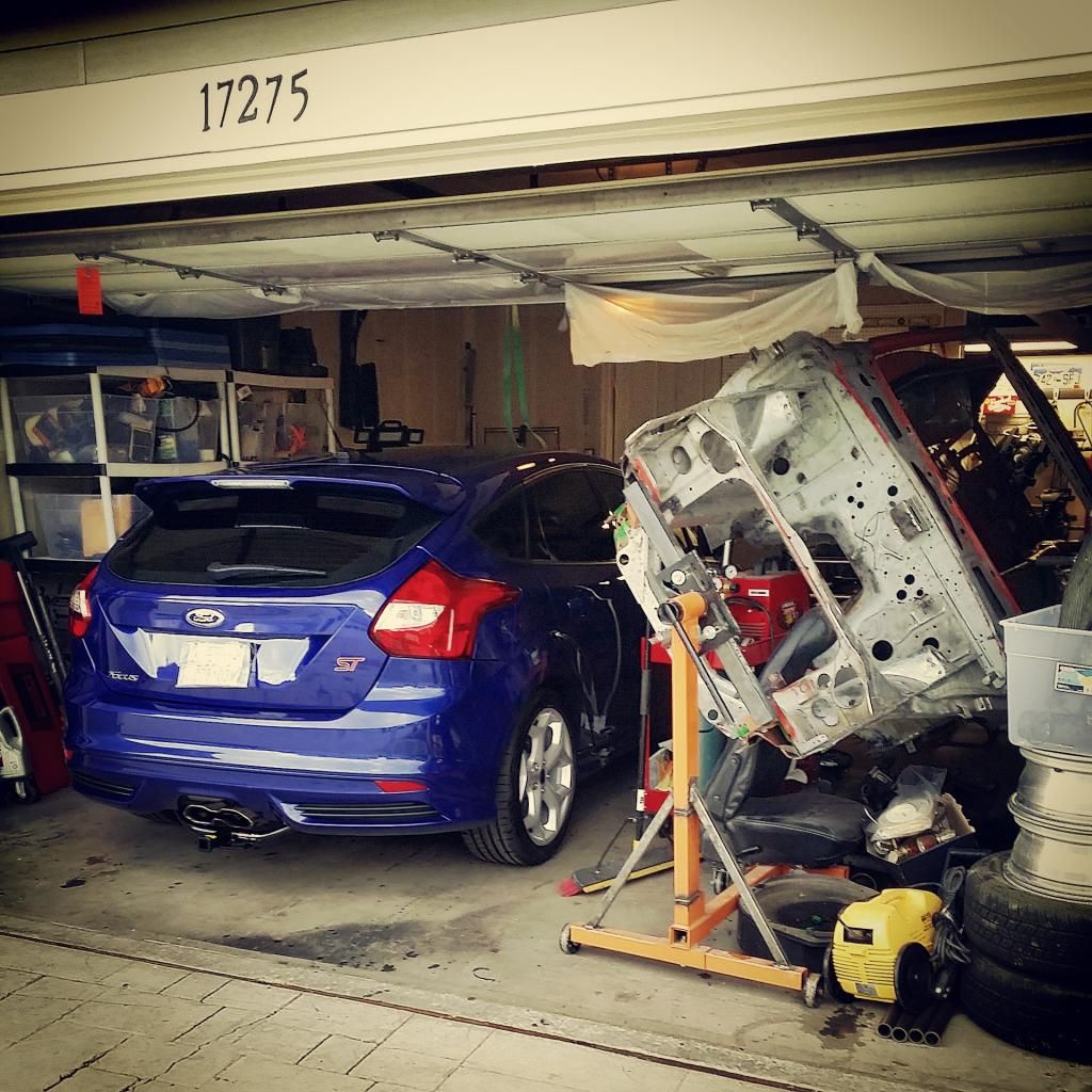

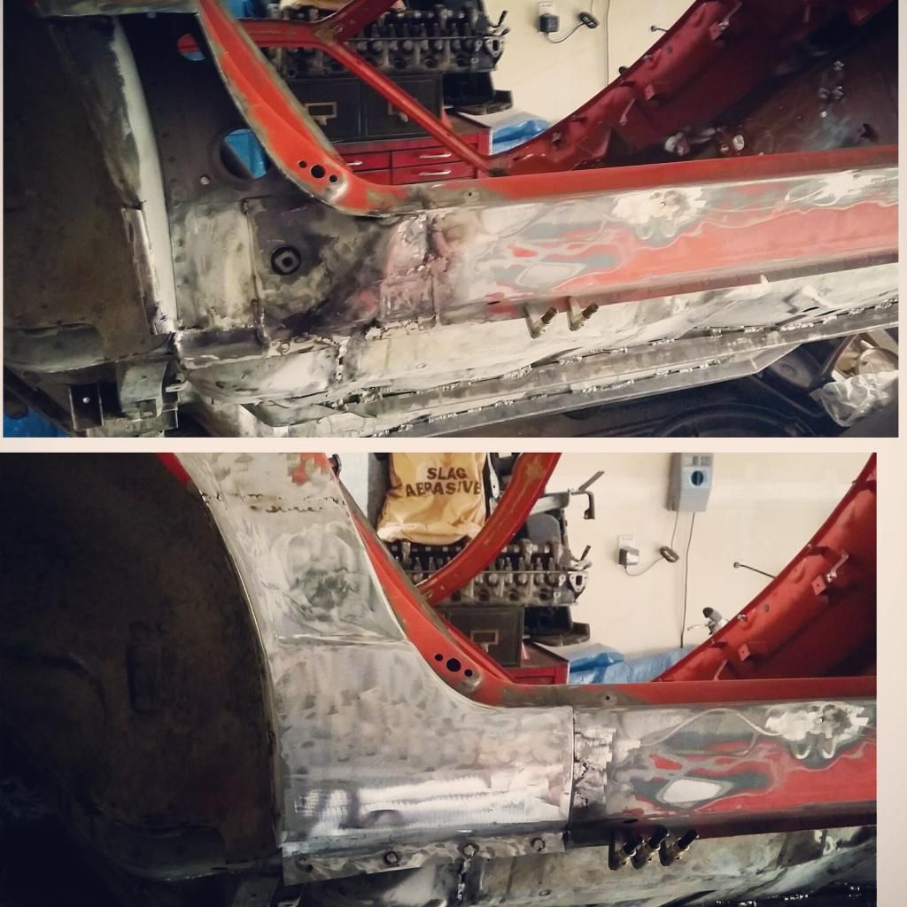

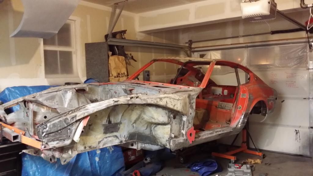

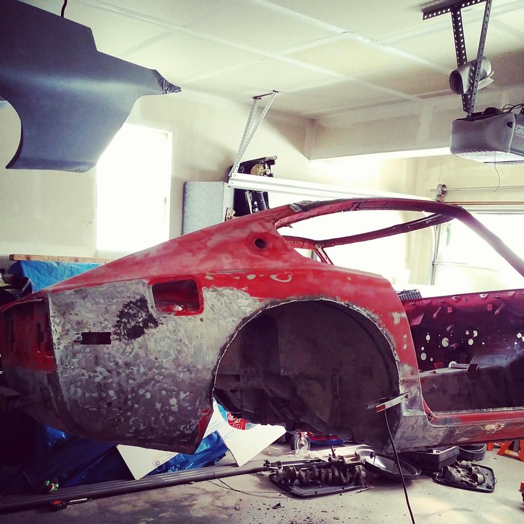

proxlamus Posted November 21, 2014 Author Share Posted November 21, 2014 (edited) Then I did something stupid. Very Very stupid, I had some rust repair I had to do... so I took the car apart and began the rust repair. This turned into a WHILE IM AT IT fiasco. This was farrr too much and I hated grinding under neath the car to install the Bad Dog frame rails.. time to go onto a rotisserie. First step was to try Soda blasting.. which is a huge waste of time and money.. I bought Nickel slag and a eastwood sandblaster and life was much better. At this point, the blast pattern was about the size of a quarter and took multiple passes. I had better luck with a wire wheel and flap disc. Edited November 21, 2014 by proxlamus Quote Link to comment Share on other sites More sharing options...

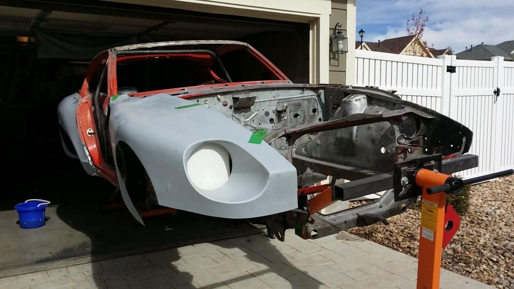

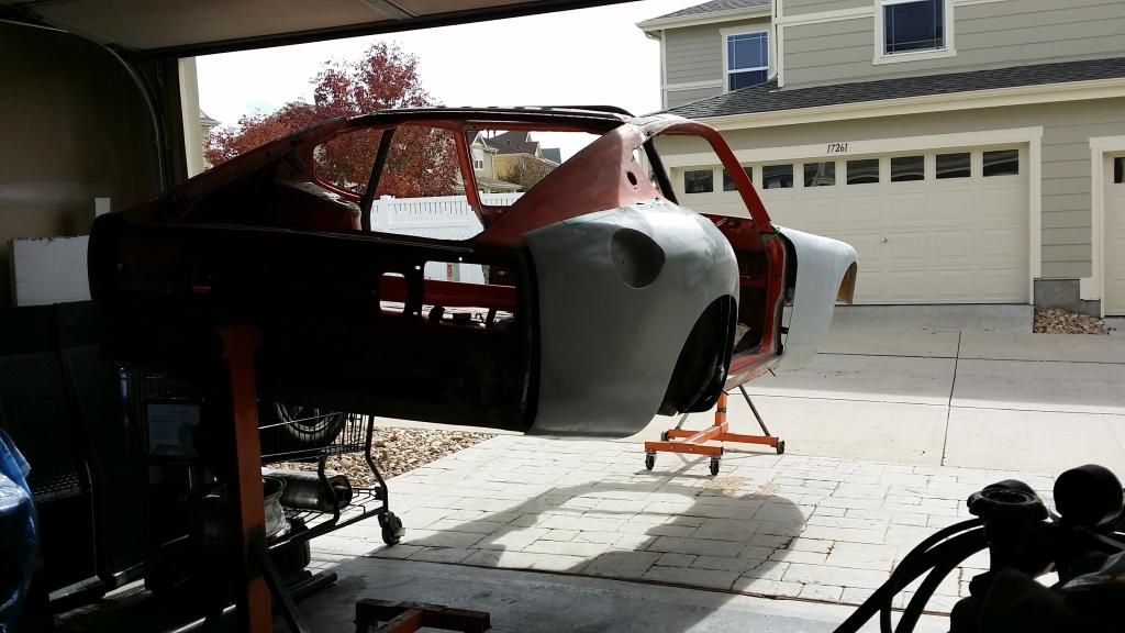

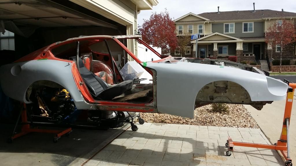

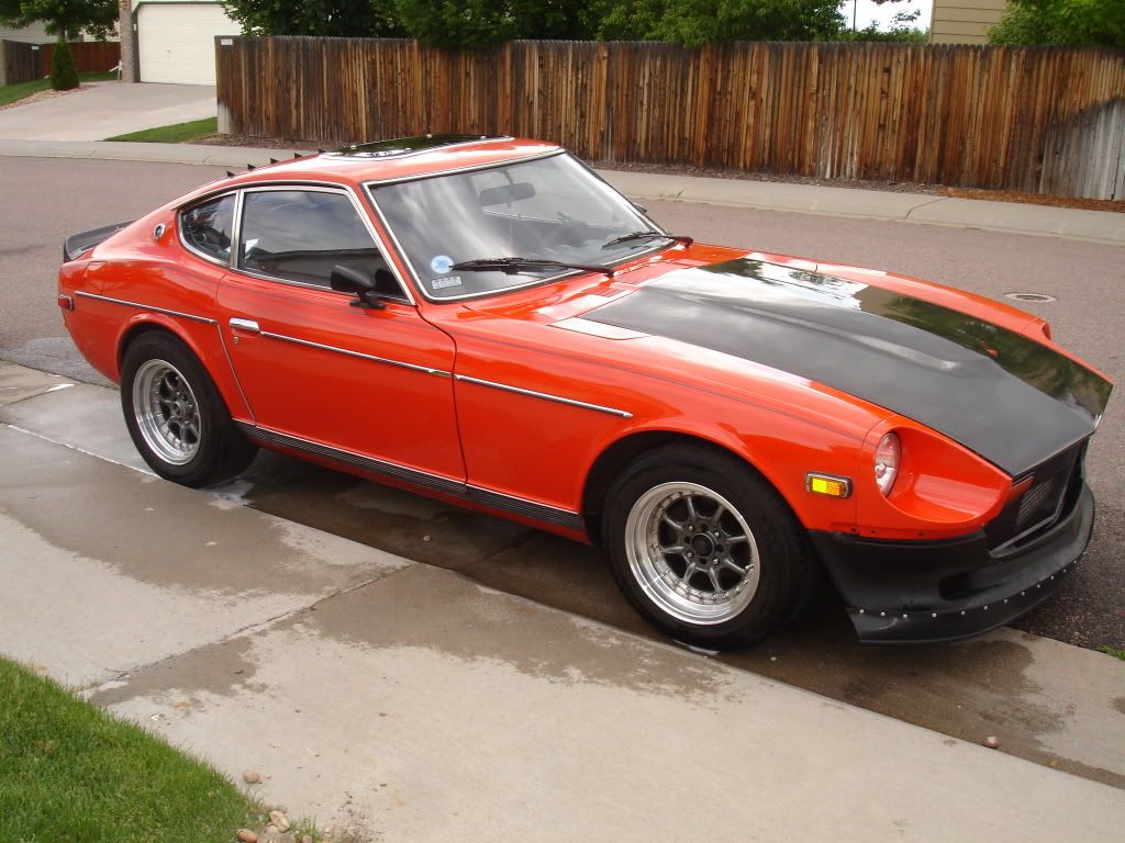

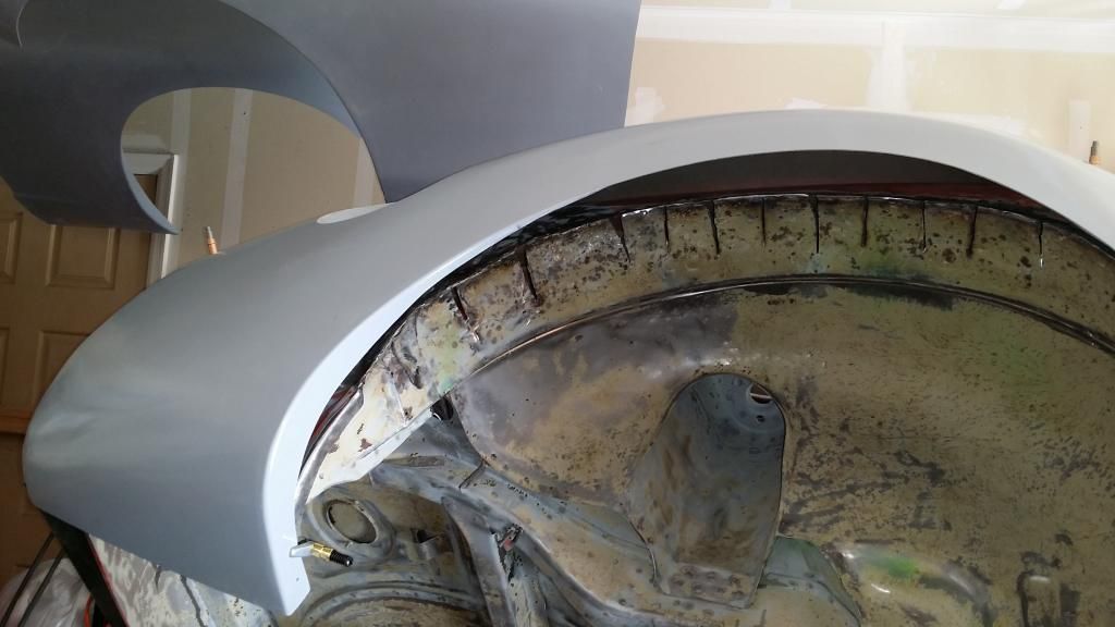

proxlamus Posted November 21, 2014 Author Share Posted November 21, 2014 (edited) [/url][/url] Time to cut the flares for my 280YZ kit! Damn, the fuel door on the YZ kit hits the old fuel filler. Time to cut that out [/url] A brief look at the 280YZ and how itll look. Edited November 21, 2014 by proxlamus Quote Link to comment Share on other sites More sharing options...

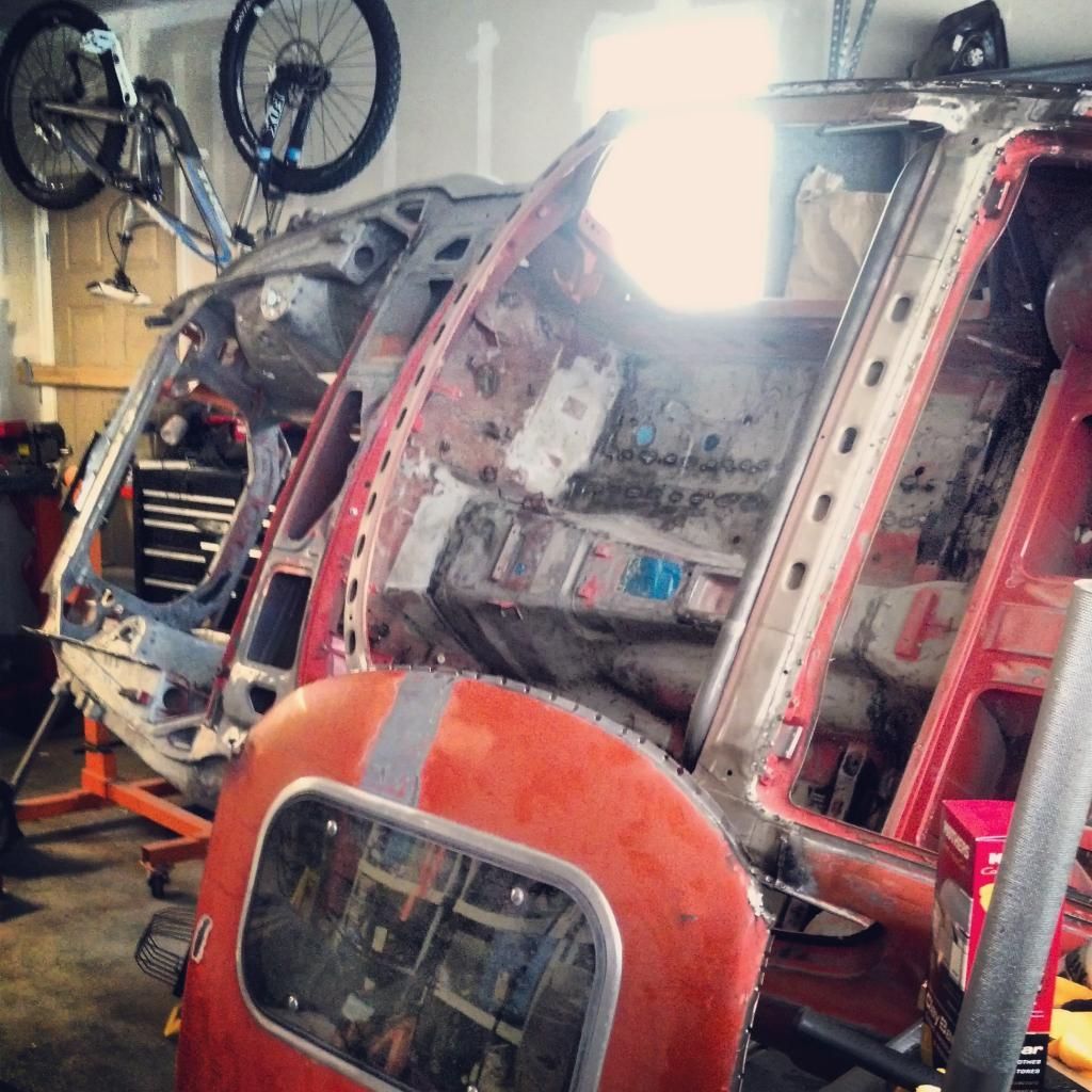

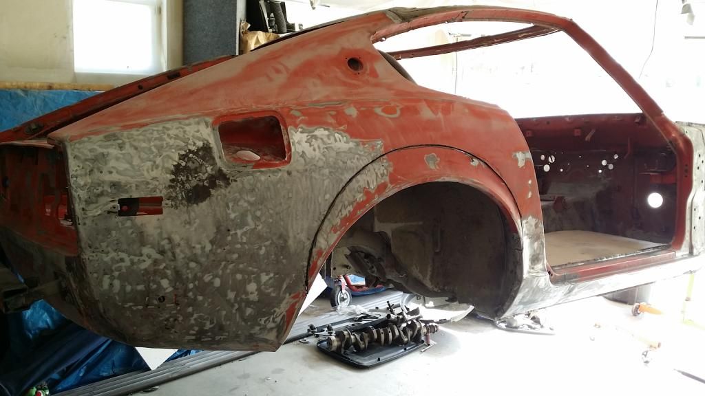

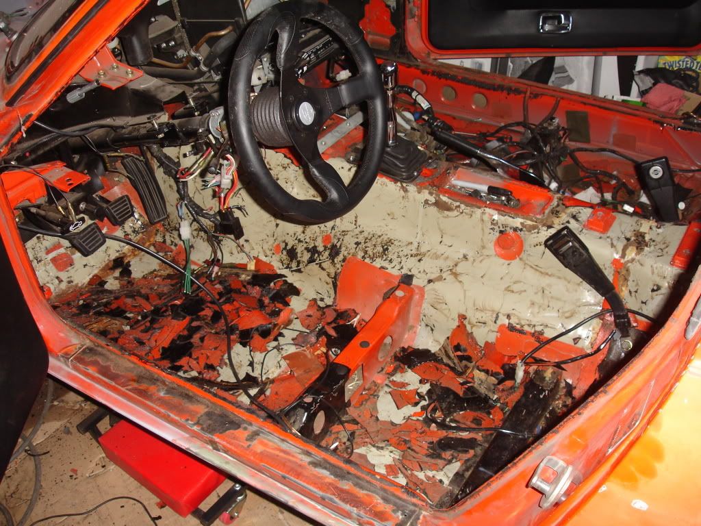

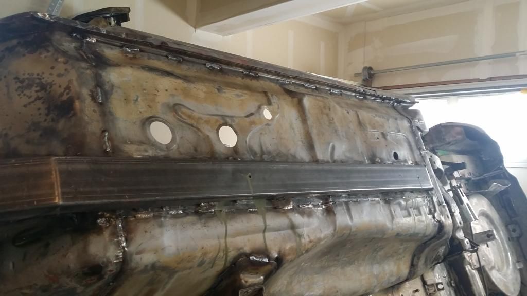

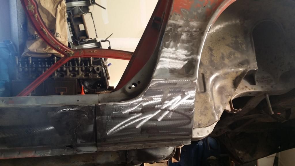

proxlamus Posted November 21, 2014 Author Share Posted November 21, 2014 (edited) Making progress on the seam welding or stitch welding, whatever you want to call it. You can see the Bad Dog subframe connectors installed. Oh yeah, I had a sunroof and I didnt want it anymore. I drilled out all the spot welds and popped that sucker off. Edited November 21, 2014 by proxlamus Quote Link to comment Share on other sites More sharing options...

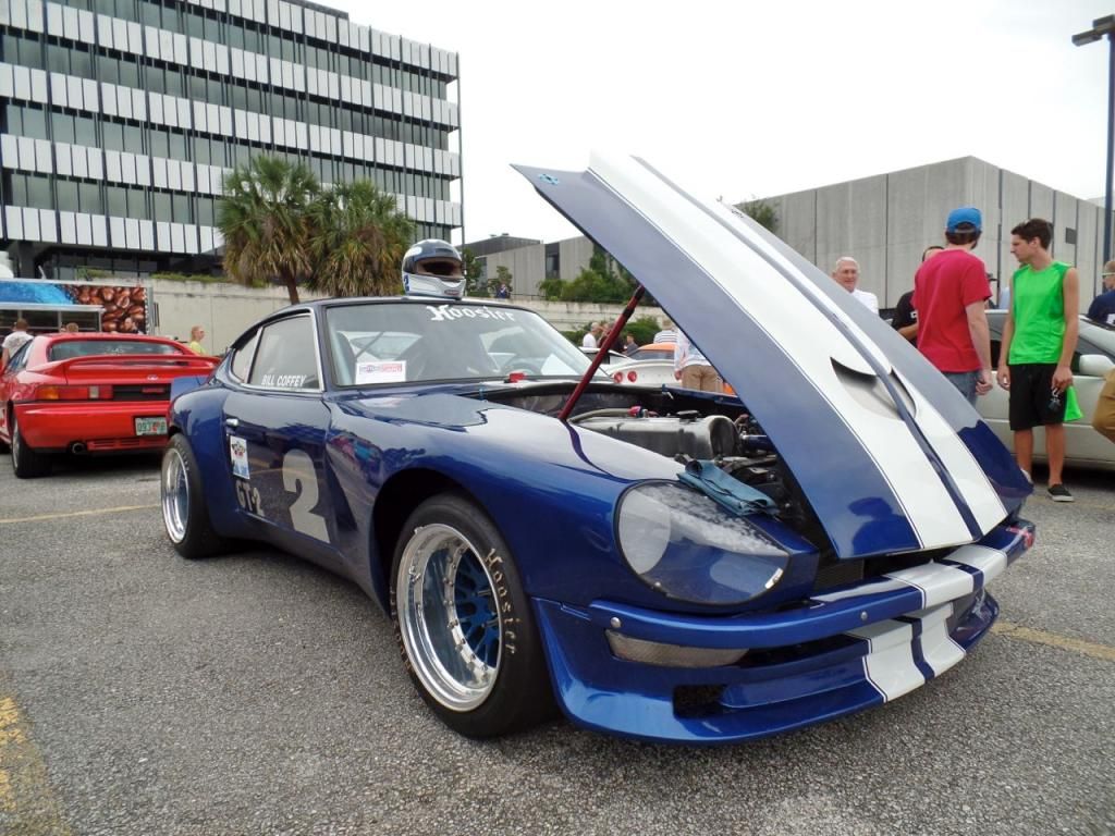

proxlamus Posted November 21, 2014 Author Share Posted November 21, 2014 I would like to follow Bill Coffey's beautiful build. I talked to him and it looks like he extended the front bumper and had to stretch the lower valence. But I love this look so so much. Quote Link to comment Share on other sites More sharing options...
Nelsonian Posted November 21, 2014 Share Posted November 21, 2014 ^^^ That's what the front should have looked like from the get go ! Quote Link to comment Share on other sites More sharing options...

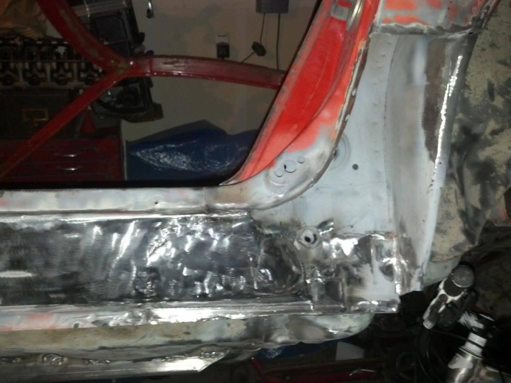

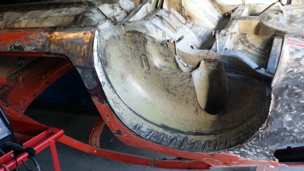

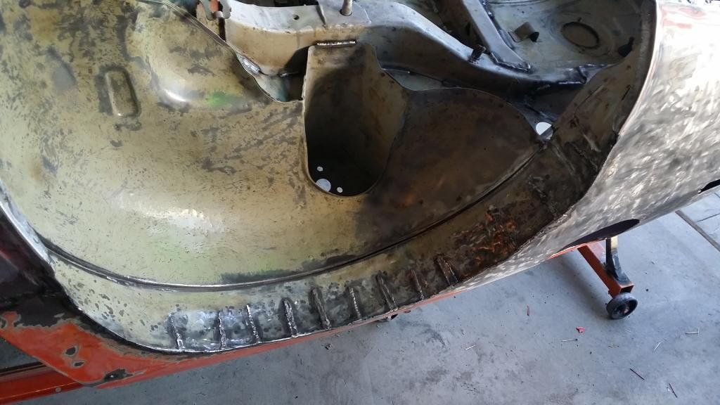

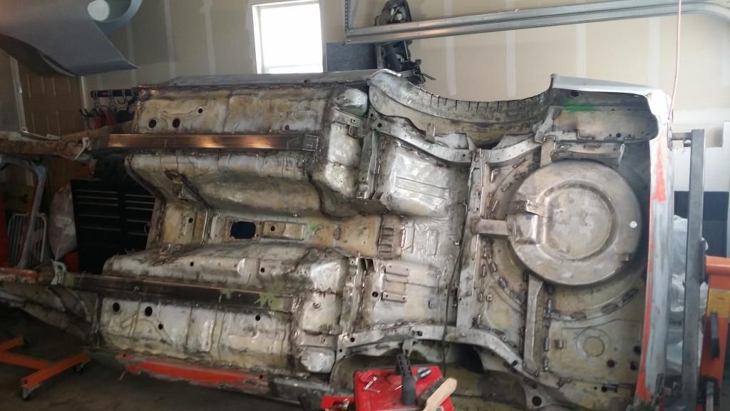

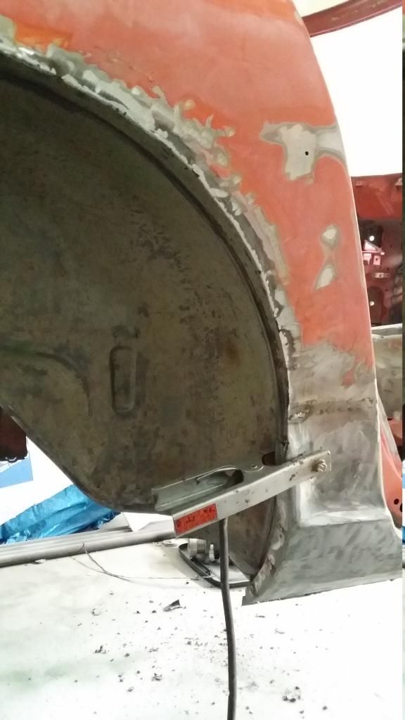

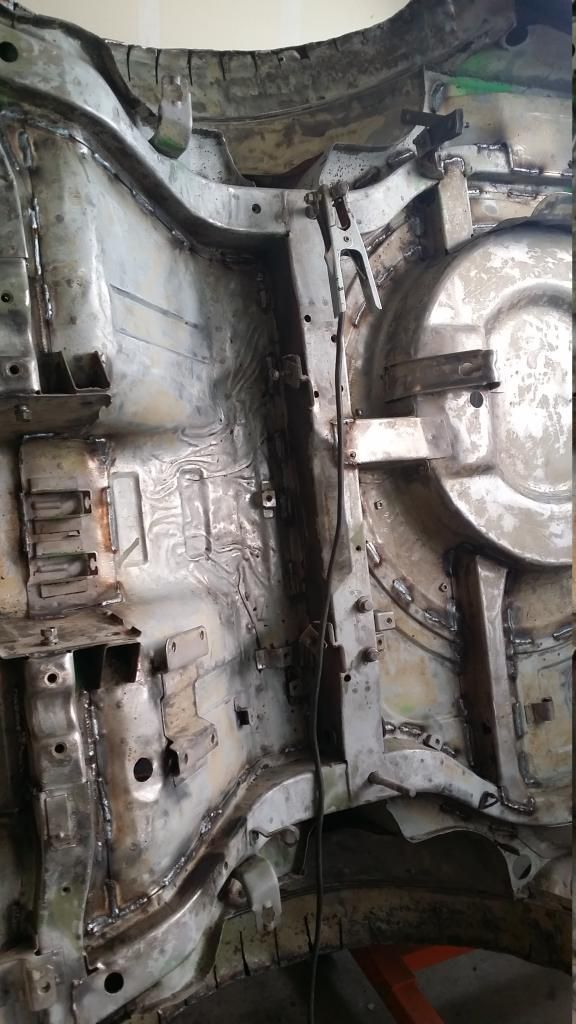

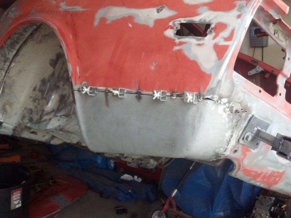

proxlamus Posted November 26, 2014 Author Share Posted November 26, 2014 Since I cut so much out of the inner fender well, the sectioning cuts were pretty big to fill with just weld. So I cut lots of tiny strips and filled in the fender well. The bottom of the car is complete with stitch/seam welding. Moving to the inside next and then the cage begins. Quote Link to comment Share on other sites More sharing options...

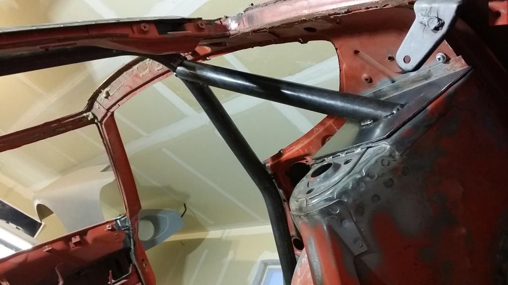

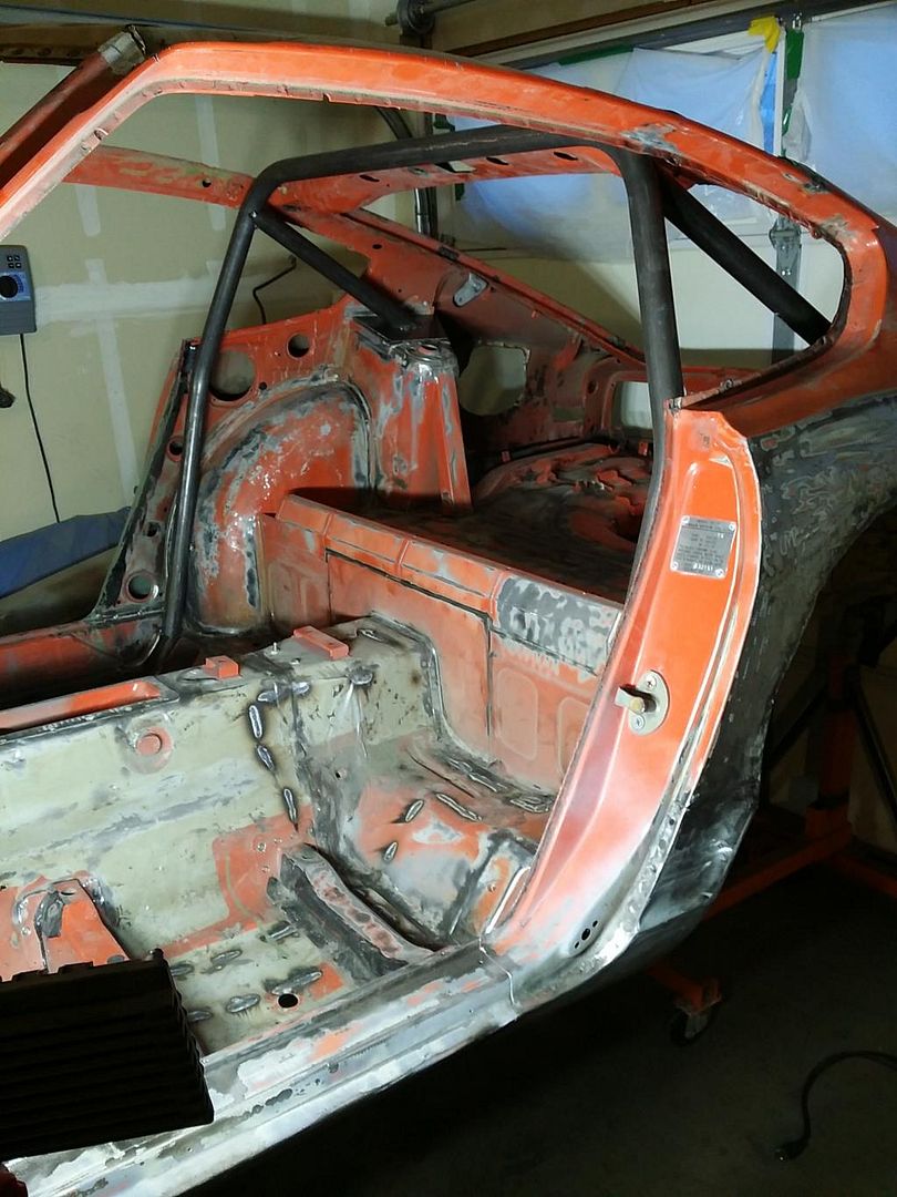

proxlamus Posted February 23, 2015 Author Share Posted February 23, 2015 Finally built up the courage to start the cage. Got the main hoop in and the rear supports. Feels good to learn how to cut and bend tubing! Quote Link to comment Share on other sites More sharing options...
