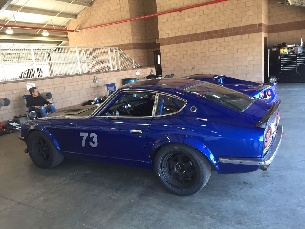

aongch Posted August 6, 2015 Author Share Posted August 6, 2015 (edited) Woohoo finally ready for first track day... final checks, fluids, pads, extended studs, susp bolts..... Speed Ventures event Fontana CA http://speedventures...ail.aspx?id=530 My 73, a '71 and '78 are IN for the full 2.7 mi Roval!! Anyone else local want to stop by or also run the Roval or autox? Hope to see more out there. Edited August 6, 2015 by aongch Quote Link to comment Share on other sites More sharing options...

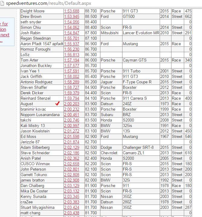

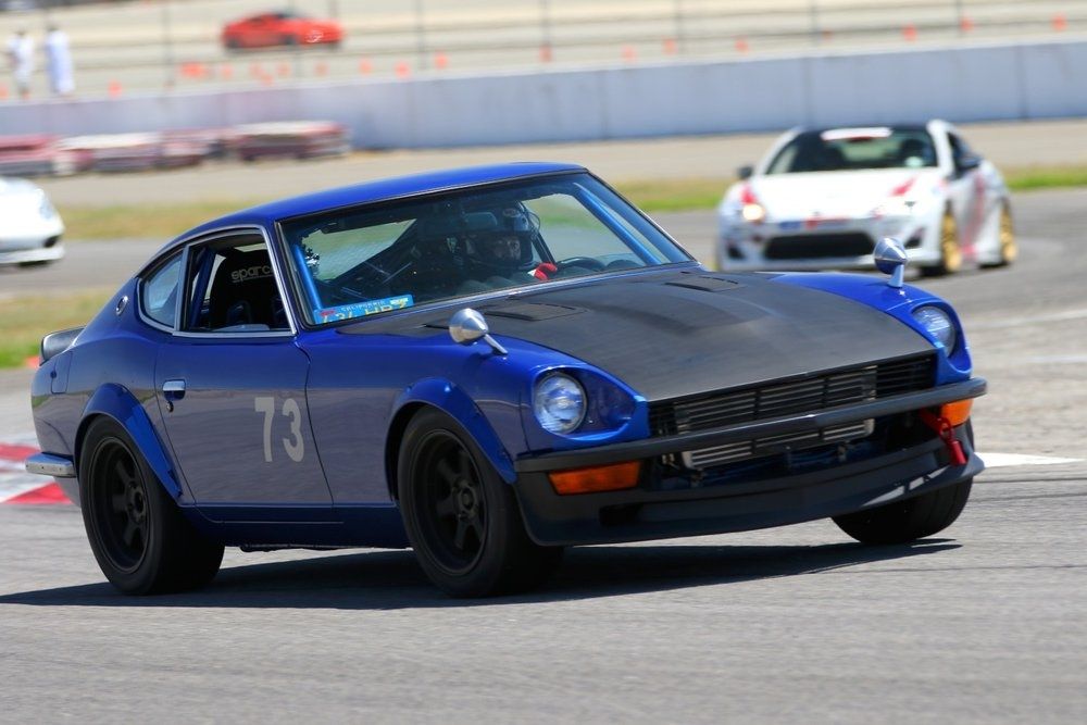

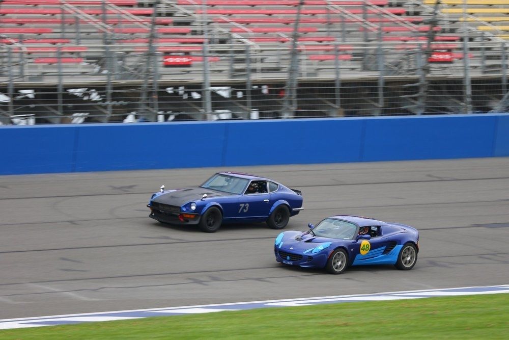

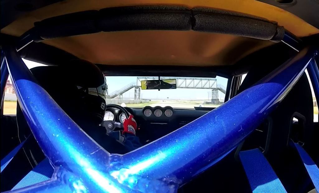

aongch Posted August 8, 2015 Author Share Posted August 8, 2015 (edited) Great time at the track at Auto Club Speedway's 2.7 mi Roval (front straight, banking, infield), chassis, susp stayed solid. For this first time out, I found only a couple of issues. But RB ran strong, esp pulling out of corners, betw 4-6300 rpm, made many passes!! Front straight speeds around 130 so far with the Z32 5 spd. Some key feedback: - Wilwoods are amazing, although rear bias had to be dialed almost all the way out/decreased, too twitchy at heavy brake zones - No overheating whatsoever. Water temps stayed steady betw 180-190 at ambient 70-85 deg F for the day - Susp settings - camber, toe - just about spot-on, R-comps Z214 wear patterns even, temp readings across tread also even - Minor leak from diff at first session, seal? overflll? Will confirm - Coolant seepage from cap when parked after sessions. Radiator cap at 13 lbs I believe too low Next steps: - Install AFR gauge - Look into boost controller/ECU/tune, target 325 whp Results, not bad for maiden track day: Edited August 12, 2015 by aongch Quote Link to comment Share on other sites More sharing options...
aongch Posted August 12, 2015 Author Share Posted August 12, 2015 The R200 diff leak is from the breather tube, apparently this is common, will fix with tapped vent tubing attached much higher somewhere on the body. http://forums.hybridz.org/topic/56986-r200-diff-puking-oil-out-of-breather/ Quote Link to comment Share on other sites More sharing options...

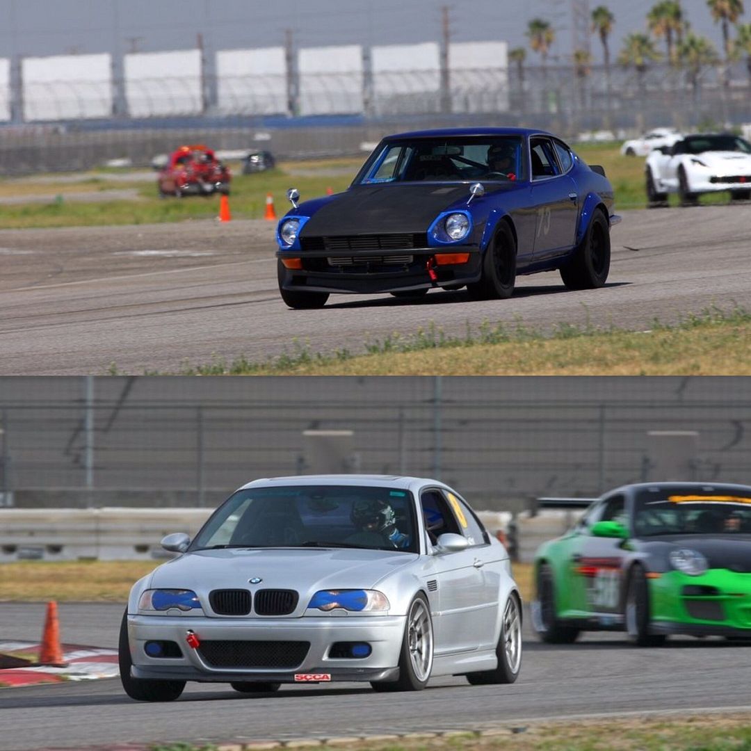

aongch Posted August 12, 2015 Author Share Posted August 12, 2015 (edited) Track pics courtesy of Caliphotography. Front straight speeds about 130 so far first time out at current tune (8.5 lbs boost) plus Quaife not installed yet. Next target, shave 5 secs off to match M3's times at ACS. Looking into Nismo R-tune or AEM options.... Edited August 13, 2015 by aongch Quote Link to comment Share on other sites More sharing options...
